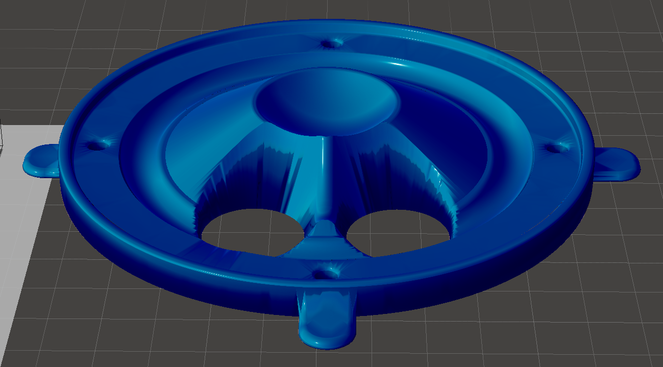

I can't recall if I uploaded these files, but I made an improved version of this phase plug.
I've attached the STL file if you want to print it.
I've also attached a couple of images of what they look like.

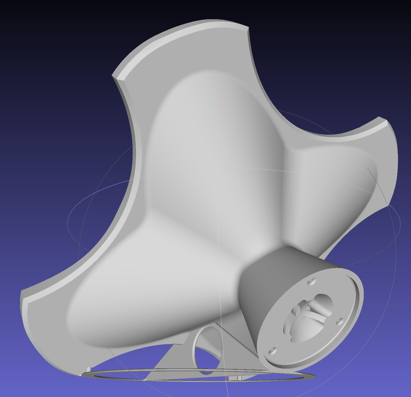

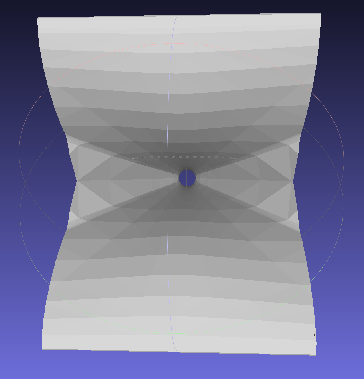

Here's the waveguide from Nexus Two. The idea behind Nexus Two is to push the midbasses further apart, so that directivity control goes lower. In addition I wanted to use a (slightly) more conventional shape in the hope that it would smooth out the frequency response and the polars.
The line in this picture is there to show how the waveguide is tilted, but there's a slot in the waveguide that's designed to radiate the sound ON axis. Basically the waveguide is tilted but the output radiates on axis. This is the opposite of my last waveguide, where the waveguide was straight but the radiation went OFF axis. If you look at this waveguide, you should be able to see that the widest part of the waveguide is tilted, to compensate for the fact that the waveguide itself is mounted in the baffle at a rotated angle.

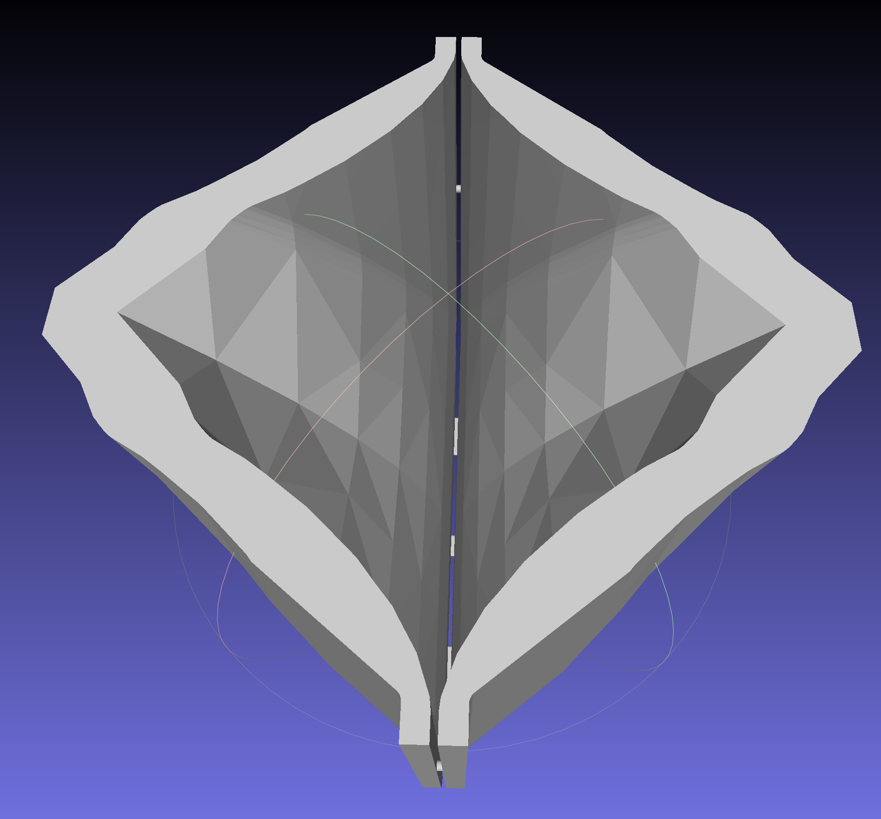

I'm not sure if I ever uploaded the STL file for this waveguide. If not, here it is. It's designed for the Vifa (Tymphany?) NE19VTS. The NE19VTS is no longer for sale. If you need some, I think I have about four in my garage. None of them are in great shape, they were the ones I used for the project itself, but they should work fine, despite the lousy cosmetics.
You should be able to load the STL file into any 3D modeling program and change the throat to match just about any 3/4" dome tweeter.
Note that the 3D model looks super weird, because I cut it in half so it would fit on a 220mm x 220mm 3D printer bed. Most of my 3D prints, I rotate them 45 degrees on the Z axis. I do this because it allows for a waveguide that's 41.4% wider.
IE, a printer with a bed of 220mm x 220mm, it can print a 220mm wide waveguide on the normal axis, or 282mm on the diagonal axis. (D = width x 0.707 x 2)

Here's the waveguide from Nexus One
Here's the polar response from Nexus One
Here's another pic that illustrates the effect.
Here's the polar response of Nexus Two, when the waveguide is tilted. Things seem to be working; this waveguide has superior response to Nexus One. This waveguide is driven by a BMS 4552.
