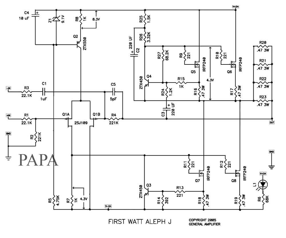

there is still no SM for A J
read all other SMs of any Aleph and talk is the same ; difference is subtle - few tiny jfets in input stage , instead of welding capable mosfets .
there is one file - myriad times posted by me - Aleph 30 pdf , made by Algar_emi ; almost every part is marked and commented
that small file is more informative than any Aleph SM , from many reasons - first one is that Papa didn't wrote SM for usual Greedy Boy , but for skilled tech .
Algar_emi made this file for usual Greedy Boy
