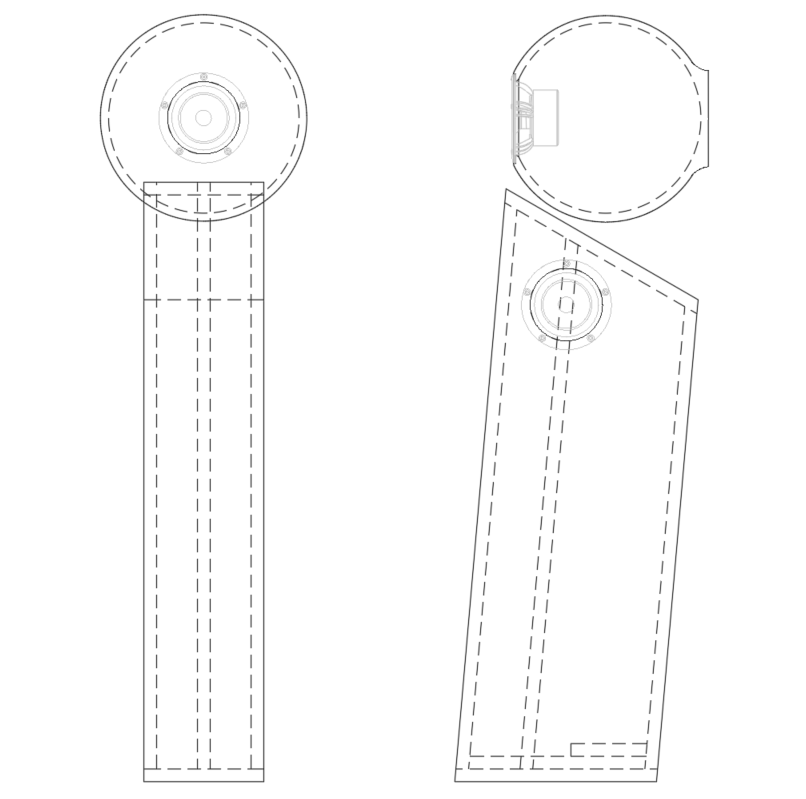

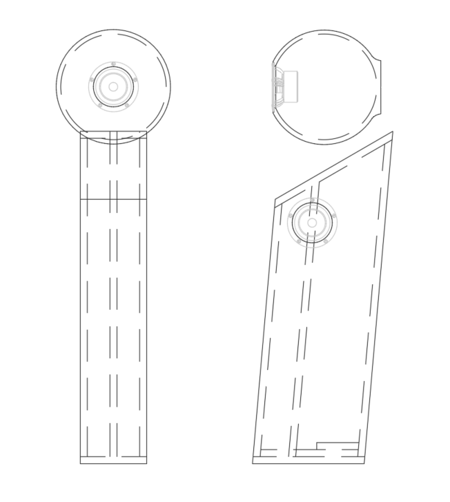

I've read you like the Mellow Monster (inspired by Olson 1937 patent: https://www.google.com/patents/US2224919 ).
It seems quite complicated to build, and it seems one of the precursors of the Silbury I already built (that includes other innovations too).
What can be expected as difference between a taller thinner speaker?
@freddi
I've seen some back loaded horns with Karlson-shaped mouth. What are the benefits?

Mellow Monster ... it seems one of the precursors of the Silbury
The Olson horns, which differ from the Mellow Monster in that it has stepped taper, and the many Nagaoka stepped taper designs did inspire all of the Monoliths, Mashowe, Vulcan et al.

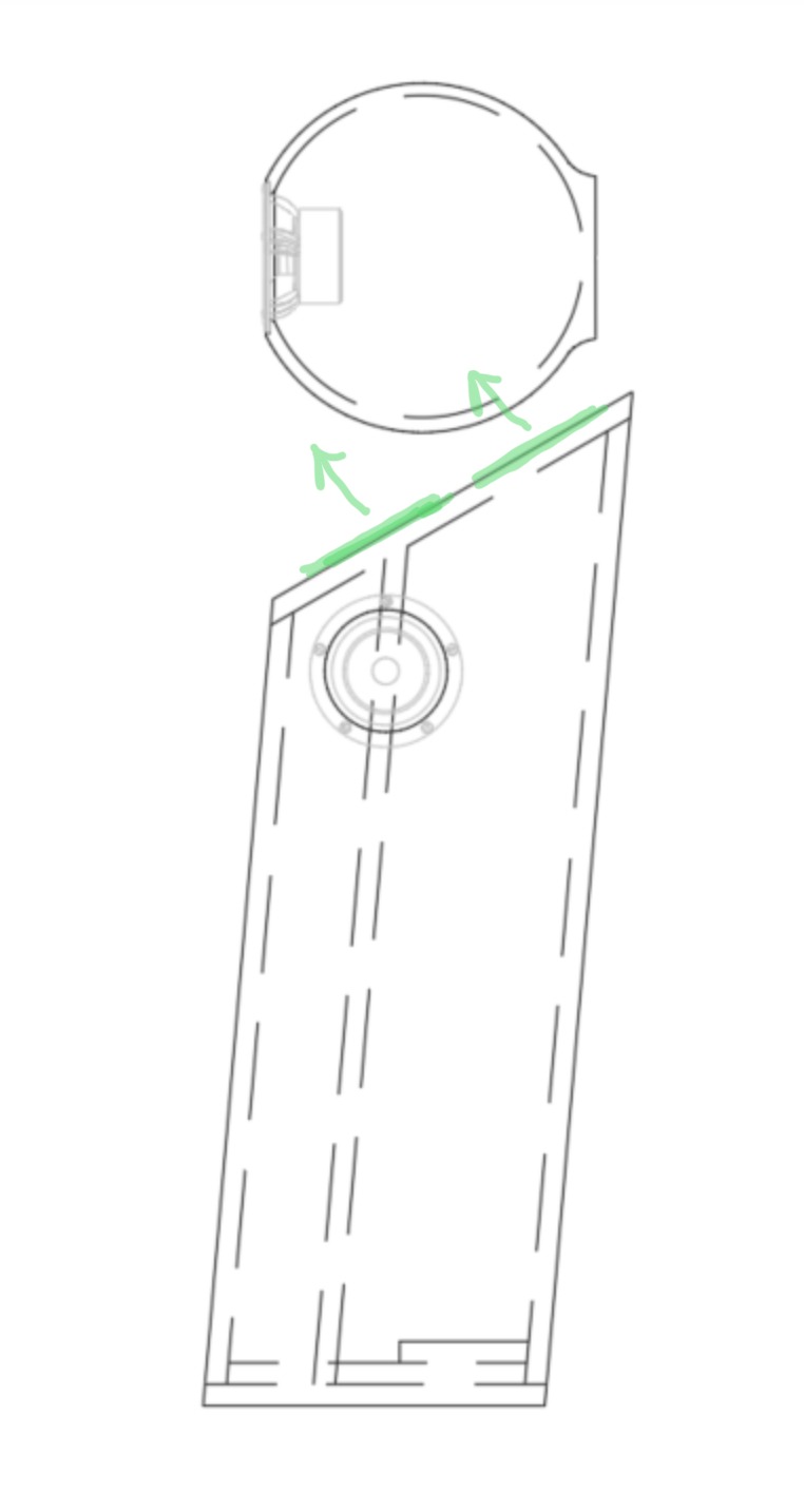

MM has front mouth but closer to a circle. The wall/corner loading gives the Megaliths an edge, the high aspect mouth is not as effective, but the curved/RonHorn style mouth helps counter that.
Spatial loading and its impact on polar response, so if room to add Altec cinema horn 'wings' as seen in my avatar to match MM's width it should perform near enough the same in the mid-band and guessing better down low due to increased height over whatever BW it is assuming a similar F3, Fb.

Thanks, I didn't notice it!The Olson horns, which differ from the Mellow Monster in that it has stepped taper, and the many Nagaoka stepped taper designs did inspire all of the Monoliths, Mashowe, Vulcan et al.
