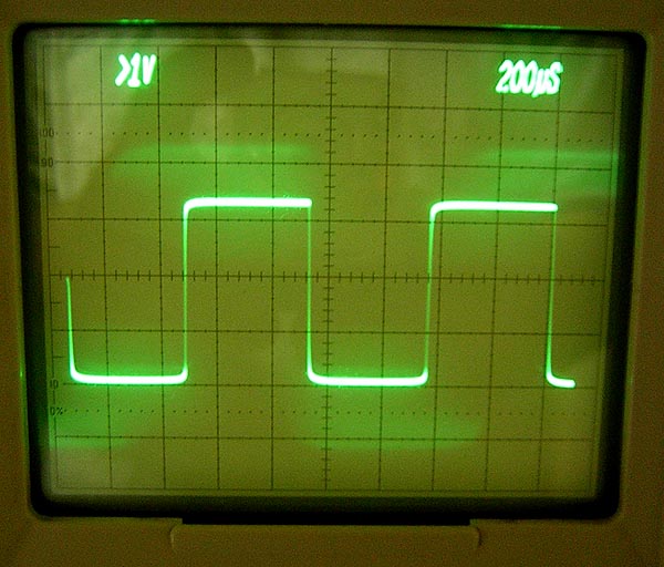

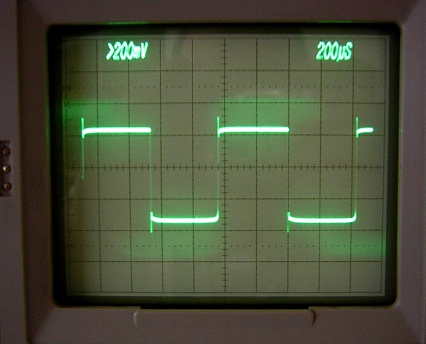

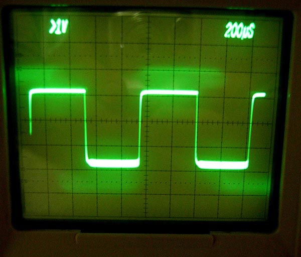

After a wonderful baked cajun catfish dinner tonight courtesy or Emeril's wonderful spices we all thought we ought to post some photos to re-inforce whatr Bill WW has been up to.... and I would say he has created one of the very best sounding Alephs that I've ever heard. Incredible presence, incredible soundstage... in both width and depth The JFET input is definately one of the best additions I've heard happen to an Aleph!
Here are some photos taken at 1 watt output, 1 khz into 4 ohms.....

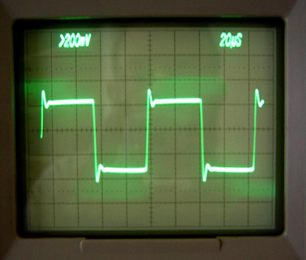

Square wave ringing?
Mark and I worked on the Aleph 3 jfet conversion late in the evening, before I needed to go home.
We found the amp tends to oscillate with any compensation cap. We tried the .001 UF and also 10 pF and 15 pF.
We decided the .001 UF was way too much. The 10 pF seemed the best we had tried, but the channels both seemed somewhat unstable with oscillations.
Any ideas? With no compensation caps you can see the very first photo Mark posted with a ringing peak on the leading edge. When we tried anything else, it seemed to be very unstable.
Any ideas on what to do or check?
This amp seemed very incredible at Mark's tonight, and has excellent potential. I was concerned afterwards about the square wave response at 10Khz and 1Khz with compensation caps seeming to make the amp unstable with too much capacitance.
I do not have any 43 ohm resisters on the LTP. Could that be the cause?

It seemed strange that oscillations only occured immediately after placing the .001 or 10 or 15 pF caps in the amp.
Regards, Bill

Mark A. Gulbrandsen said:After a wonderful baked cajun catfish dinner tonight courtesy or Emeril's wonderful spices we all thought we ought to post some photos to re-inforce whatr Bill WW has been up to.... and I would say he has created one of the very best sounding Alephs that I've ever heard. Incredible presence, incredible soundstage... in both width and depth The JFET input is definately one of the best additions I've heard happen to an Aleph!
