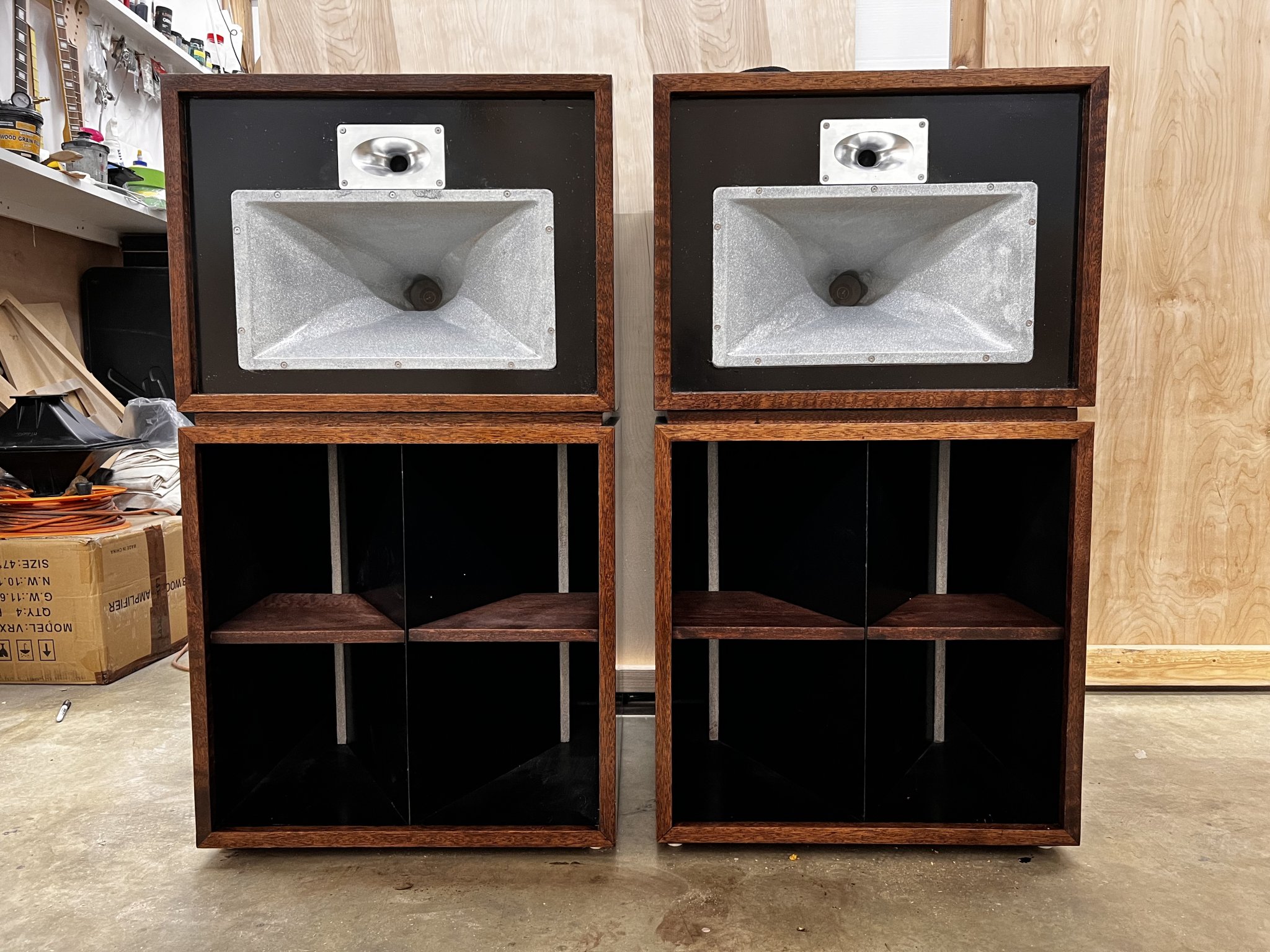

Chris, based on this above, is there substantial benefit to be gained here? I can move the tweeter down nearly 3/4 of an inch so that it overlaps the flange of the mid horn and both horns could be moved 1-1/2 inches closer to the bass horn mouth. The upper horn enclosure is more or less fixed in its dimensions due to a 15" passive radiator on the back that allows low frequency extension to 23Hz. If there were significant gains from vertical realignment of the horns, I'd consider building new enclosures. If the gains are merely splitting hairs, I'd probably put it off.Think of the extreme case: the drivers are perfectly coaxial (like in a multiple entry horn--MEH). There is no lobing, so the need to ensure minimal driver overlap vanishes--and all drivers' output experiences "unity summation" (just like the name of the patent US6411718) within the horn's aperture. All the drivers couple to each other acoustically and behave as one driver externally.
This effect was made clear to me as I examined the Danley SH-50 and measured its overall output (including polar output) and then measured the individual ways (tweeter, midranges, woofers), and saw the degree of overlap that exists between drivers in this design. That's when the light bulb went off for me, and when I finally understood what Tom Danley was saying in his patent description. MEHs do not need to minimize driver overlap because they experience acoustic summation internally before their output leaves the horn aperture (mouth), and their polar output is constrained by the horn aperture to be consistent throughout the crossover region.
Drivers on a flat baffle will also couple acoustically if their centerlines are all within 1/4 wavelength of the center frequency of crossover. Same effect.
When I moved the K-402 horn downward toward the KPT-KHJ-LF bass bin centerline (about 8 inches from its factory position), not only did the polars get better in the crossover region, but the entire loudspeaker suddenly sounded more "together". Apparently any horn-loaded loudspeaker that can get all its drivers within 1/4 wavelength at their individual crossover frequencies will behave like MEHs. This is one reason why I think crossing over to a tweeter above ~1.2 kHz is a mistake (i.e., the centerlines of the drivers can't exist within 1/4 wavelength at crossover frequency due to physical size constraints)--because it introduces polar lobing between the tweeter and the next lower frequency drivers--which needs to be avoided.

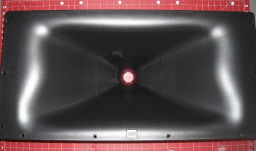

Some other mind-expanding ideas to think about (i.e., outside the current "box") for blue-skying:
1) Probably the most effective change you could implement would be to use an MEH for the tweeter/midrange and possibly woofer, too, but that would likely necessitate another tweeter driver, since you'd have to cross over probably no higher than ~1.4 kHz due to the inability to get the midrange and tweeter drivers within 1/4 wavelength at crossover. You could reuse all three sets of drivers you currently have in a 3-way MEH, if you wish, using one midrange and one woofer instead of two each. The bare visual presentation of a wood MEH horn might be a bit more WAF-compliant. The only consideration would be how low your current tweeter driver can be crossed (i.e., can it be crossed as low as 1.4 kHz?).
A zip file of a "Synergy Calc" spreadsheet of a Cornwall-sized drop-in horn that would do the job is enclosed below.
2) Another approach is to use a dual-diaphragm compression driver like a BMS or B&C 1.4 or 2" to replace the tweeter/midrange. You could use a single polymer horn of sufficient mouth size, like that from a JBL Professional:
3) You could also put a grill cloth across an MEH mouth with a decorator-like fabric pattern to present nicer-to-look-at scenery. A couple of example pix to fire the imagination:

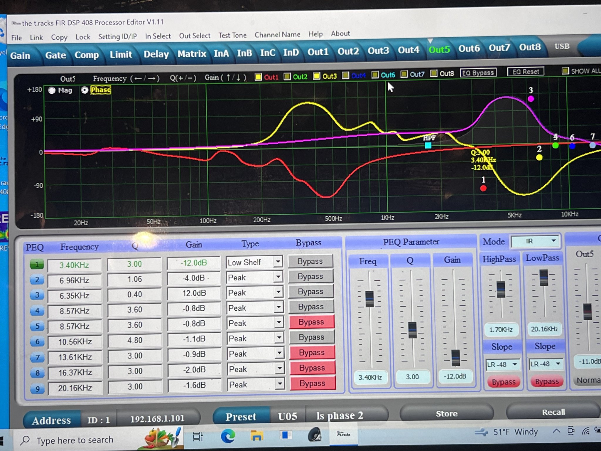

The Thomann T.Racks DSP-408 arrived today. I’ll have until Saturday or Sunday to read the instructions, learn RePhase and get it up and running while my s/o walks to the farmers market with her sister.

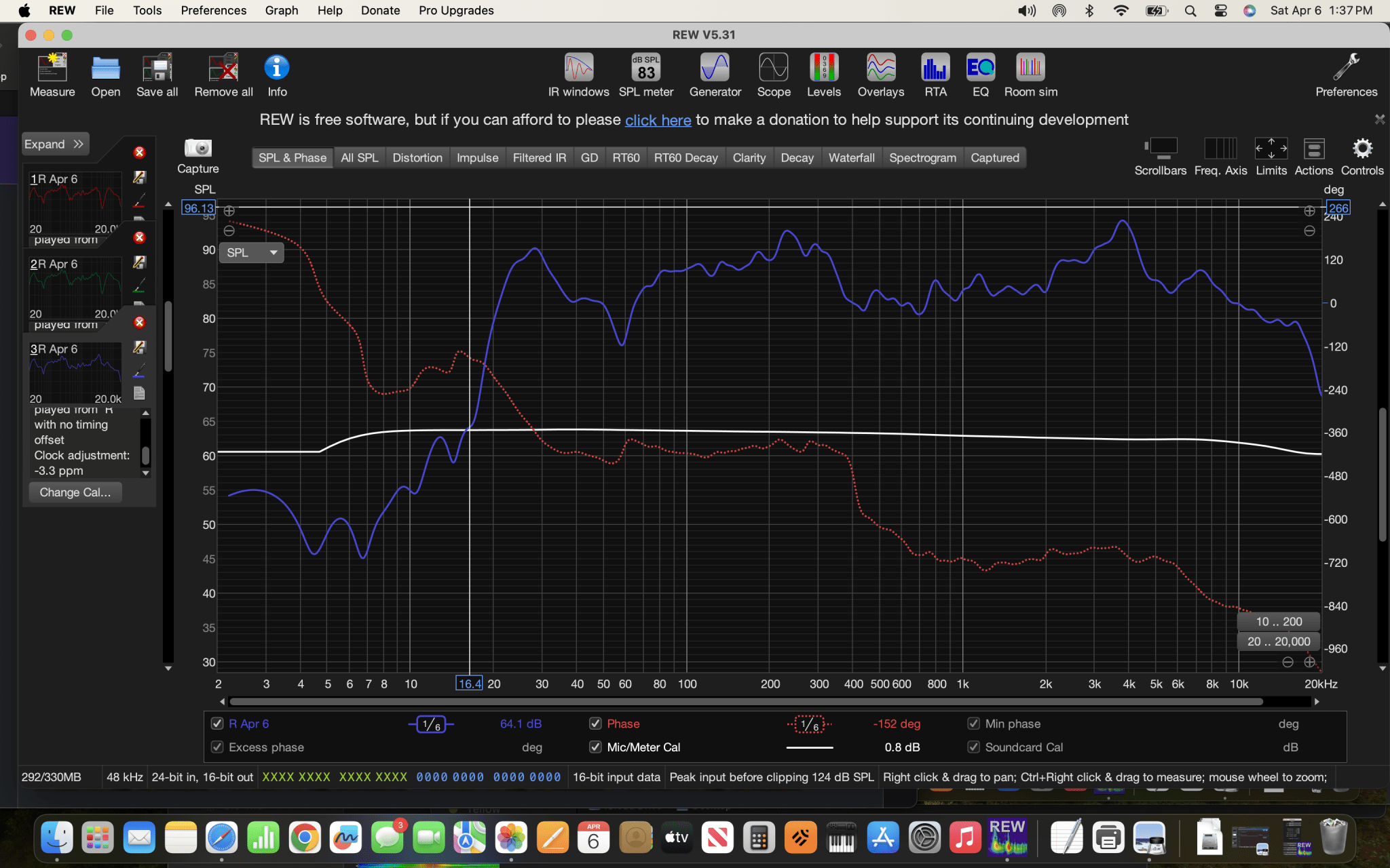

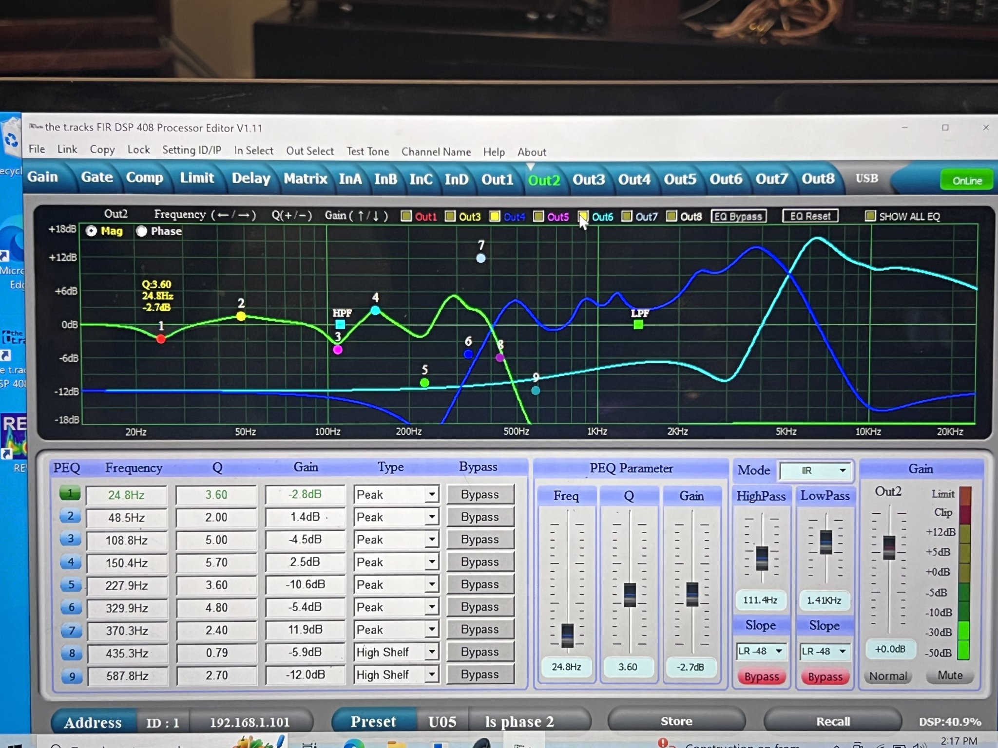

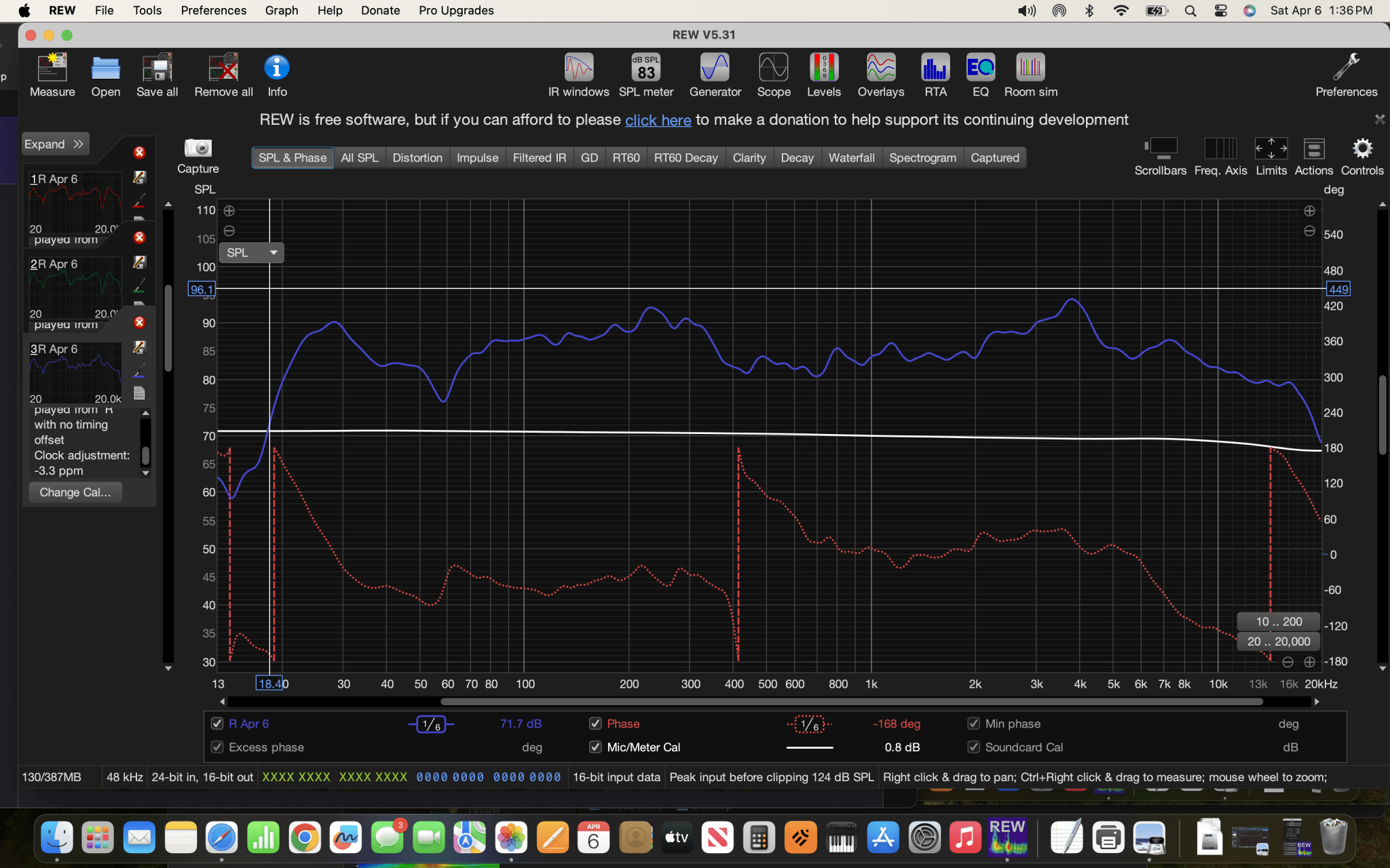

I've got the Thomann T.Racks FIR DSP-408 up and running, set preliminary crossover filters with PEQ instead of named filters, aiming at 400Hz and 5KHz. I did an initial sweep, generated EQ parameters and plugged them in and ran another sweep. SPL shows a null at the mid to tweeter crossover point, a slight null at the mid to woofer and another null at 58Hz and even though I generated eq at 1db, there remains room for improvement.
SPL & Phase:
Excess Phase:

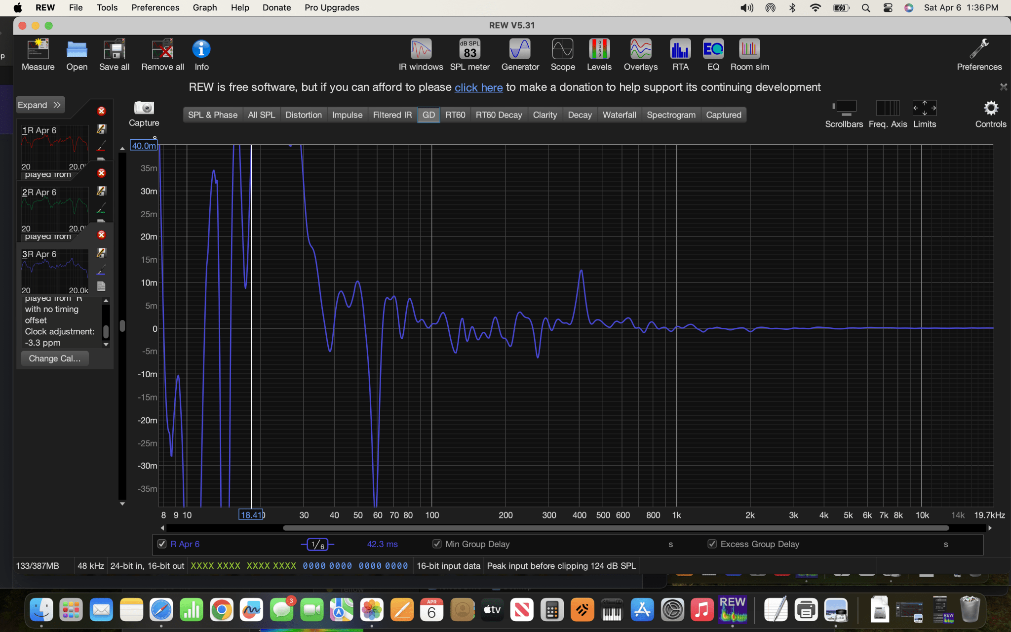

Group Delay:
Spectrogram:
it's a good start, but there's room for improvement. I'm somewhat baffled by the group delay in the bass bin, I suppose I can attribute it to the passive radiator? The spike at 58Hz is presumably where the oem Lascala runs out of steam and where the sealed upper enclosure and passive radiator takes over. The one at 400 hz is more concerning, as it coincides with a phase shift at roughly the same spot, with another at the other crossover:
I'm at a loss as to how to address this, as the T.Racks doesn't have a way to invert the phase that I can see. should I flip the driver polarity- would it solve that? Edit. Found it by, (facepalm) reading the f-ing manual.
I'll share my peq settings in the next post

Incorrect polarity of the speaker is clearly visible on the step response; if the phase problem at 400Hz is associated with incorrect polarity of the speaker, then it makes no difference how to change it, programmatically or physically, the result will be the same.I'm at a loss as to how to address this, as the T.Racks doesn't have a way to invert the phase that I can see. should I flip the driver polarity- would it solve that?
In the meantime, I’ve managed to effectively eliminate the nulls by massaging the driver overlap in the peq and took care of the low frequency null via the input eq. I also ran into the brick wall of spousal patience with the woooooooooooiiiip! Of frequency sweeps, so it will have to wait until the next time I have the home to myself to do more measurements
@Cask05 any input you may be able to offer on resolving the mid phase would be appreciated
Drivers are a JBL 2225H, PRV D2200PH and B&C DE10. I may ultimately opt for a different mid driver to reduce overlap, but the number of 2” compression drivers that play to 400Hz and don’t require a second mortgage on the house to purchase, are small.

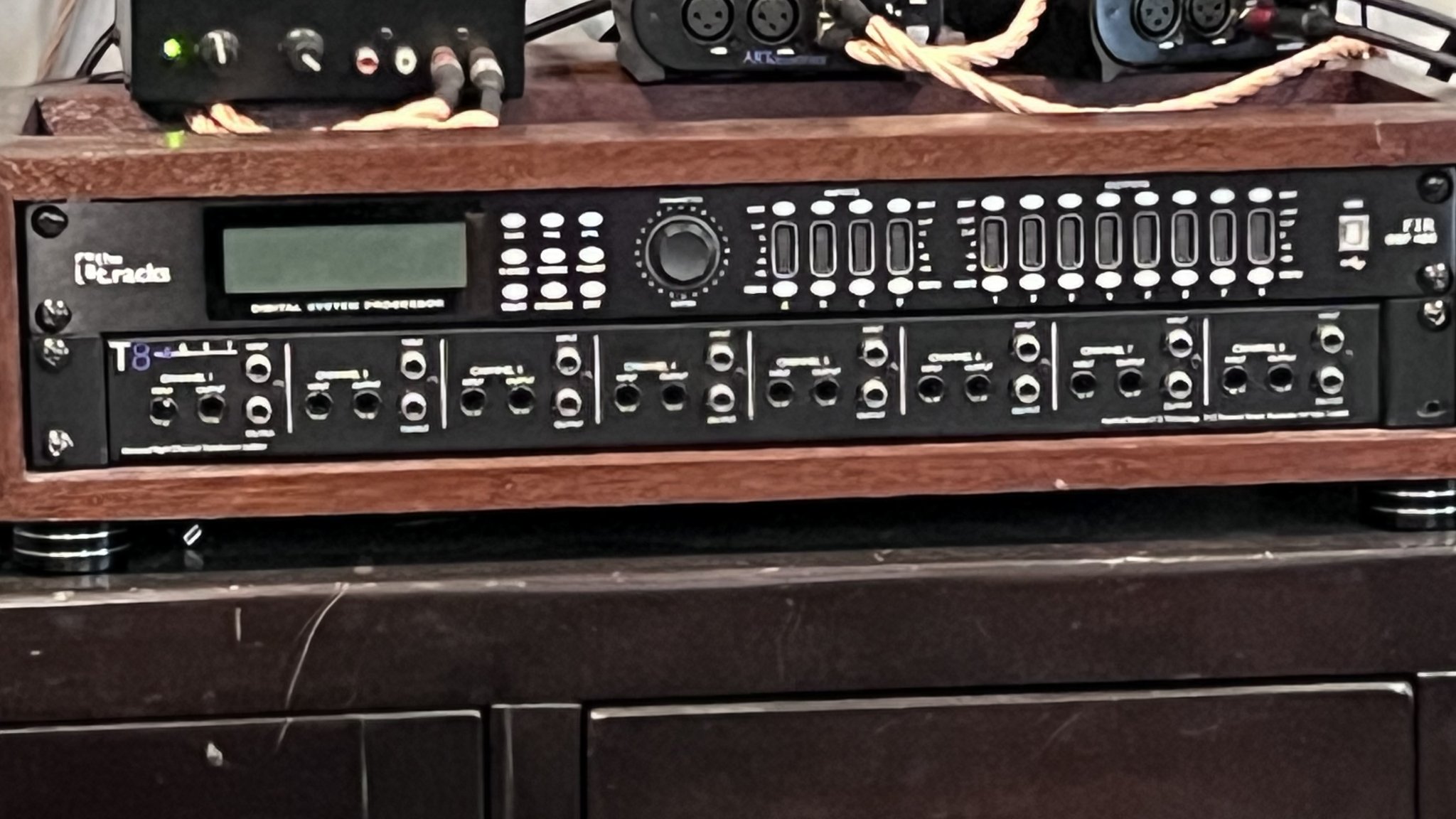

At any rate, on to the subjective review of the Thomann FIR DSP 408.
The good: there’s a lot to like here: the interface is easy to use and mostly intuitive, my only problem that led to the manual was trying to find the phase inversion button on the UI: it was labeled “normal” which someone more familiar with active crossovers might have grokked, but it didn’t occur to me. A quick search of the manual fixed it. At any rate, I’ll give the UI an 8.75 for ease of use. I did spend a few evenings plugging in curves and faffing about, but that was more or less how I learn. Once I got going, everything was simple and I got it more or less sorted in a morning.
The SQ is excellent! Compared to the Dayton Audio DSP 408 that I used previously, the noise floor of the is negligible. There’s no fizz, hum, hiss or buzz that I can perceive. The 96kHz sample rate better accommodates high res streaming and paired with high efficiency horns, there’s no perceived distortion of the signal that I can hear. Having PEQ on the input is great, it allows you to flatten the driver and horn response on the output, while adding hose or room eq on the input.
Unfortunately there is just one problem and it’s potentially a big, deal breaker of a flaw for hi-fi use: the unit has a cooling fan that is by default, always running. It is LOUD. You can’t hear it when music is playing, however, when the music is off, it reads 44 db at .5 meters, a weighted on my iPhone db meter app; the noise floor of my inner city Philly home is 37db. I find this pretty problematic and there’s no documentation on how to bypass it.
On one hand, I’m tempted to open it up and simply unplug the fan, however, that would likely void any warranty. It’s a crapshoot whether it will build up significant heat at polite listening levels. If I was more adventurous, I could try to replace it with a quieter CPU fan. Another option I’m considering is I currently have it in a 2 space rack enclosure that I made for my studio from Meranti Mahogany- I remove the cover from the DSP chassis, and make a 1u enclosure for it that will increase the ventilation enough that a fan is unnecessary. While I’m out of wood in my workshop, I do have some rack ears and metal grille material; I could knock it out in a few hours in the wood shop. Given that it outperforms anything at its price point on the spec sheet, I may have a go at it.
