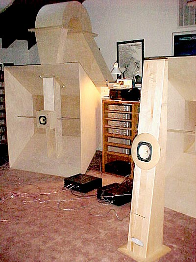

Thanks Dave that means a lot coming for you and Scott. Let me take a minute and (try to) sum up my findings. Having had several friends over the last few days to hear them, everyone has expressed the same, Wow... only ONE driver!
As for the music choices I tried several direct disc albums, as well as CDs and my iRiver running RockBox. Artists included Quincy Jones, George Benson, Herbie Hancock , Alison Krauss, The Carpenters, James Taylor, etc.... Mostly light but with a little RUSH to liven it up. Everything sounded wonderful, vocals are simply amazing. One thing I did notice was the bass lacked the punch I wanted.... That is until I placed a few books under each cabinet, Wow that made all the difference.
On a damping note - I tried 1 inch fiberglass on the bottom, back and one side in just one of the cabinets(R side). What I found is that I, and several others, preferred the undamped cabinet. There was a noticeable drop in the HF and in volume coming from the damped cabinet. I wonder would cotton felt make the difference? And what would that difference be?
Let me again thank Scott and Dave for there wonderful design and everyone for answering my annoying questions.
Chris

planet10 said:Christopher will need to caption this pic...
This picture(s) are of my current setup a Luxman R1050 and a B&O 1800 turntable. As well as showing the large cabinet(s) which feature Electro-Voice sp12c drivers with an X36 crossover connected to a T35a tweeter. The smaller cabinets to the left are the ones the Bruce(s) replaced. They are the recommended cabinets for the Electro-Voice MC8A fullrange driver.

bluemartini said:Is your construction 3/4 inch melamine coated particle board or something else?
It was 3/4" MDF from a local Habitat for Humanity store. It was(is) coated with something, what I do not know and no one could tel me. All I do know is that the paint (black) did not like it. I think for the next project I'll use Baltic Birch. Not to start a flame war but what is the consension - BB or MDF?
Chris
