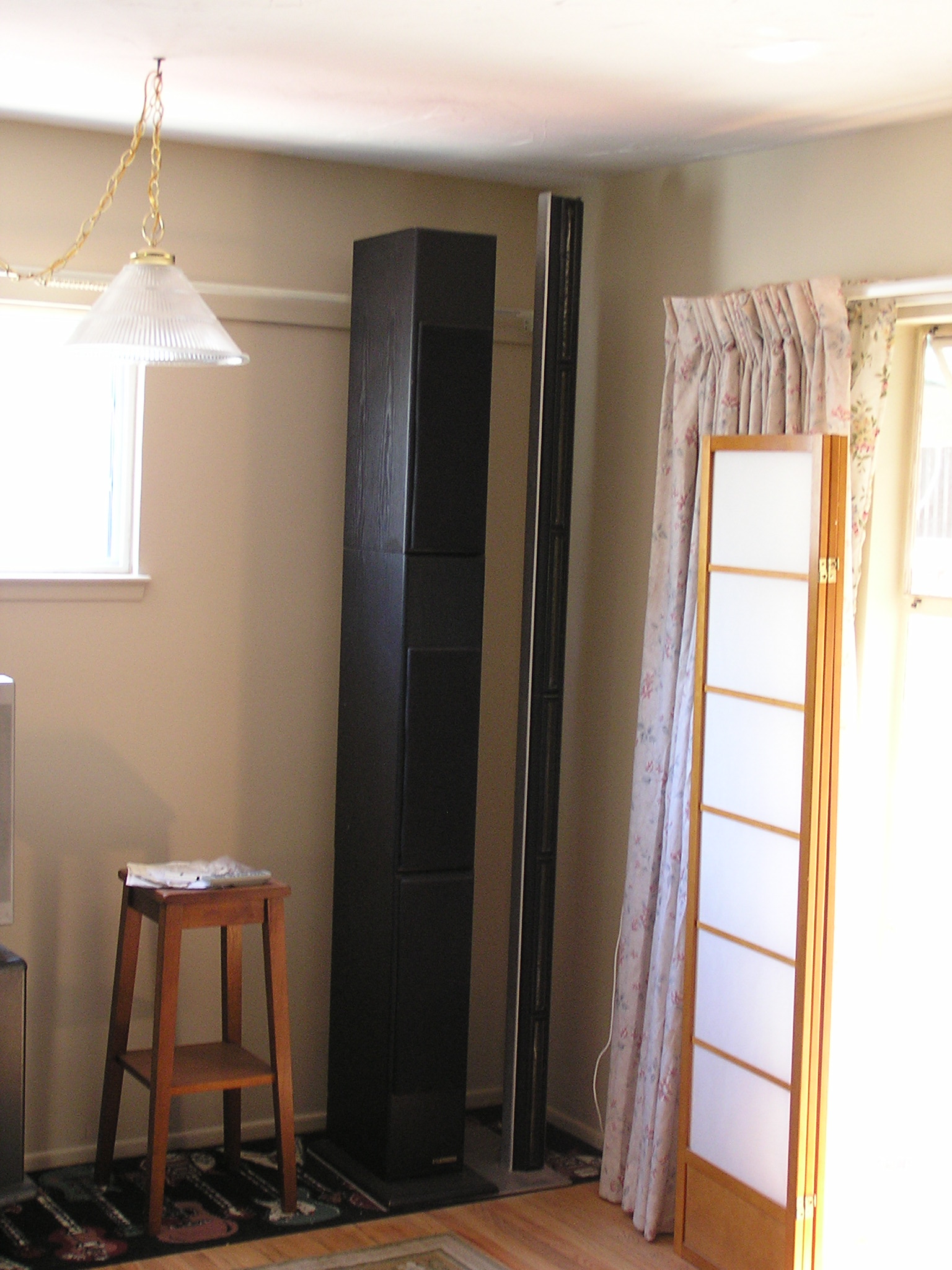

My config is different, as I built them before Newform introduced their coaxial mounting. My ribbons run full-length from floor to ceiling, in an anuminum extruded channel. My mid-bass stacks are actually three Newform cabinets stacked for left channel and three for right channel, with 12 scan-speak total (I sealed the cabinets eliminating the original ports). The aluminum channels have large aluminum plate bases. I usually put the ribbons alongside the mid-bass stack, but I could put them in front. My Rane crossover does provide analog delay if I need it. I don't have the cabinet backs or fronts rounded (very interesting though).
I hope to get two Danley tapped horn subs during the kit sale, depenent on whether I can raise the money by September.
I believe there are some advantages to ribbons that run all the way to the floor and ceiling. Those reflections are problems in most installations, interference causing frequency-dependent comb filtering. But in mine those reflections are merely continuations of the virtual line source now of infinite length. Of course the reflections have less energy so the technique is imperfect.
One thing that's a bit unnerving though is to drive sine waves into your ribbons and listen to how much the timbre changes with drive level. Definitely cleaner a lower levels (what else is new). Also, anything has some resonant band where it is efficient, and though these do cover a wide band of 4+ octaves they are really dropping off well before 16K but so are my old ears. The scan-speak are doing OK well above 1000 so I usually cross higher and wish the ribbons went a bit higher (so I add EQ). The dozen scan-speaks don't make real bass with any slam to it; I was about to add more when I decided to pursue subs. I'd probably get more "psychological bass" with some "slam" but less real extension if I just eliminated the lowest octave (or two, or offloaded the task of handling the lowest 4 or 5 octaves to a real sub). But this is usually not for dance, this is for listening. If I was going to mount the ribbons "co-axially" I'd probably place them in front of or between the mid-bass drivers, with the 6.5 inch mid-bass drivers arranged in two columns, one column of woofers on each of both sides of each ribbon. Might be some concerns with sharing a baffle, might put the ribbon in front with delay. But my point is that when I'm not using subs and I want to play loud and have some real bass, I will require a lot of these small mid-bass drivers, at least 2 dozen and probably more like 40 total; the current dozen doesn't cut it. Then again, my bass driver requirements are a bit extreme due to EQ, dynamic range expanders, and a phase-coupled activator (actually I just sold the audio-control unit and bought a DBX exquivalent I haven't even auditioned yet). I used to use 64 bose drivers for home stereo, so I know enough small drivers can generate some "slam" down to 50, but not down to 20. I'm hoping to side-step the issue with the Danleys, but it would be more elegant to expand the range the scan-speaks handle and have a true 2-way system. If you really want to run the ribbons to a low corssover like 1K, then you can definitely consider larger mid-sub drivers, even much larger ones. Even crossed over higher you could run 8 inch or 10 inch mid-bass drivers in a true two-way system.
I've got a stack of commercial power amps: 5 soundcraftsmen amps (FET outputs, regulated SMPS, 9000 watts total if the impedance was optimized for them, which it definitely is not). I used to have some Crown CE4000 amps also, but had to sell them in tight economic times. I might be helping a friend get something similar together, using Crown K2 amps for the bass and mids with hiis current Adcom for the highs.
Right now my mid-bass sound OK at lower levels. The drivers are not evenly spaced, and I'm pleased any comb-filter effect from this is not disturbing. The scan-speak drivers are still mounted offset in the stacked Newform cabinets. So there's a bit of blank cabinet baffle near the floor, then as you look up there's 2 scan-speak drivers (bottom cabinet is right-side up) then there's two more (second cabinet is upside-down) then there's some blank baffle and two more scan-speak (third cabinet is upside-down). This puts (on each side) 4 dirivers centered vertically on my head/ears in seated listening position and 2 more centered vertically on my head/ears in standing position. Sounds good to me, but I have often considered adding more scan-speak drivers to fill in the gaps. This was not an ideal design, this was something I threw together with a tig welder in an afternoon. The mid-bass cabinets were Newform "blem" vinyl-covered cabinets (looked great to me).
Neither the vertical spacing of my mid-bass drivers nor the side offset between them and the ribbons is theoretically elegant, but is sounds pretty darn good. I've even dragged them outside for a pool party. The long line-source cylindrical wavefront really does propagate well, diminishing only linear over longer distances (instead of square of the distance for a point source).
So here's 2 kilowordsworth:

Final set-up may put the mid-bass in the corner and have curtains and absorptive panels on the wall, and some toe-in. And some subs. Right now they are not operational, as I need to make a fusebox load center that plugs into the obsolete clothes dryer outlet so that I can power the power amps. No point in even trying to run 9000 watts of power amps from one or two 15 or 20 watt wall outlets. Even from the dryer connection it's dubious.
Hi cycle camper.
Very cool.
I suspect the "lack of slam" is from sealing off the ports in a cabinet tuned for the ports??
My cabinets are designed to be sealed to start with, so it isn't a compromise and the infinite baffle keeps them very room independent.
It is very very good to get the effect of a near field monitor with the natural dynamics in a larger room (or outside as you did) using the linesource design. 🙂
I highly recommend the deq2496 and it has parametric eq as well so you could try to offset the bass roll off from sealing the tuned port.
