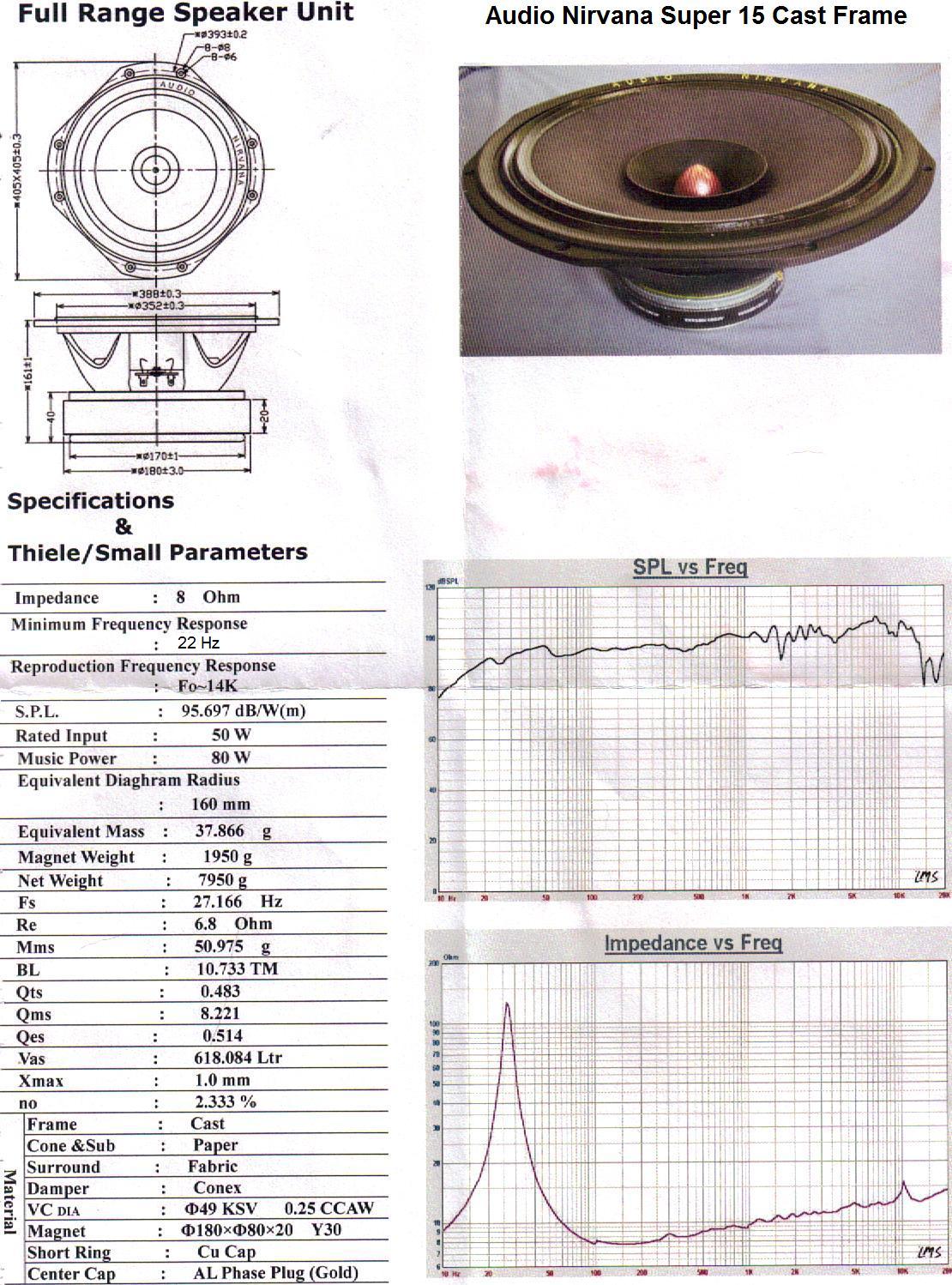

I've been lurking here for a while, and have been intrigued by the positive feedback for 15" Audio Nirvana drivers. It seems, though, that current production is essentially a new speaker (apparently made in a new factory since some time in 2020). I've attached datasheets for the old and new variants but for a quick glance:
spec old new
Qts .483 .322
Qms 8.221 3.219
Vas 618 L 337 L
BL 10.773 17.026
.. and those frequency response plots! It looks like the old version is about 92dB@30Hz, 96dB@40Hz where the old one is about 83dB@30Hz, 85db@40Hz; significantly less output at low frequencies. In fact, the new variant looks like it starts rolling off at about by 6dB/octave 100 Hz.
The vendor mentioned that this is the best sounding driver of all they manufacturer, that it represents an improvement over the old Super 15 ferrite, and that specs are really meanigless. Even if I were to accept that at face value, it does appear to me that this is a totally different driver, and any advice/recommendations/praise from prior to 2020 doesn't necessarily apply to the current offering.
So, would folks agree with my assessment that the current Super 15 is essentially a different product than the old Super 15? If so, does anybody have any experience with the new variant?

Well, it certainly looks different, and the spec. is completely different. Although like many manufacturers, AN's published data has not always lined up especially well with 3rd party measurements. Below the mass-corner frequency (i.e. the region where T/S data is relevant) rolloff is dominated by Q -for a given Fs, the lower the total Q, the higher in frequency and shallower (initially) the rolloff will be.
Notwithstanding marketing hyperbole, since the original large AN units tended to have relatively high Q and Vas values, which demanded a very large enclosure by contemporary norms, the newer ones may allow for a better alignment in more modestly sized vented boxes -I haven't had chance to check. Assuming the different responses & T/S data are correct though, to say nothing of an apparently different basket, I do not see how any technical remarks that applied to the older units can be re-applied to the newer ones. Subjective comments are another story of course, since people can say what they like on that front.

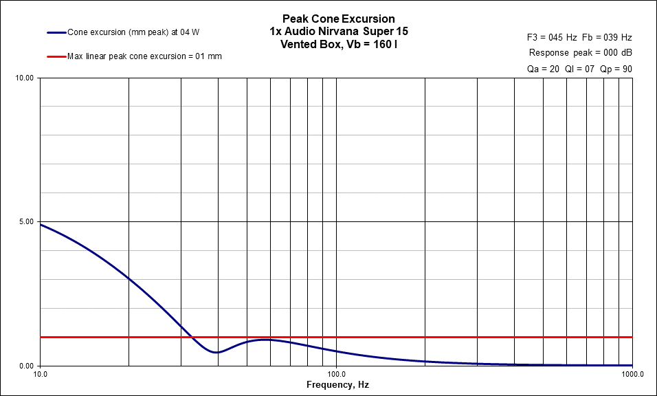

1600 liter performance notwithstanding, the newer Super 15 numbers looked quite decent in a large-but-not-overwhelming 160L bass reflex enclosure to my untrained eye. It was hard to reconcile this with the experience of folks who tried them in open baffles, or boffles, or huge boxes. This is what made me search through the internet archive to see if the specs in the first place.

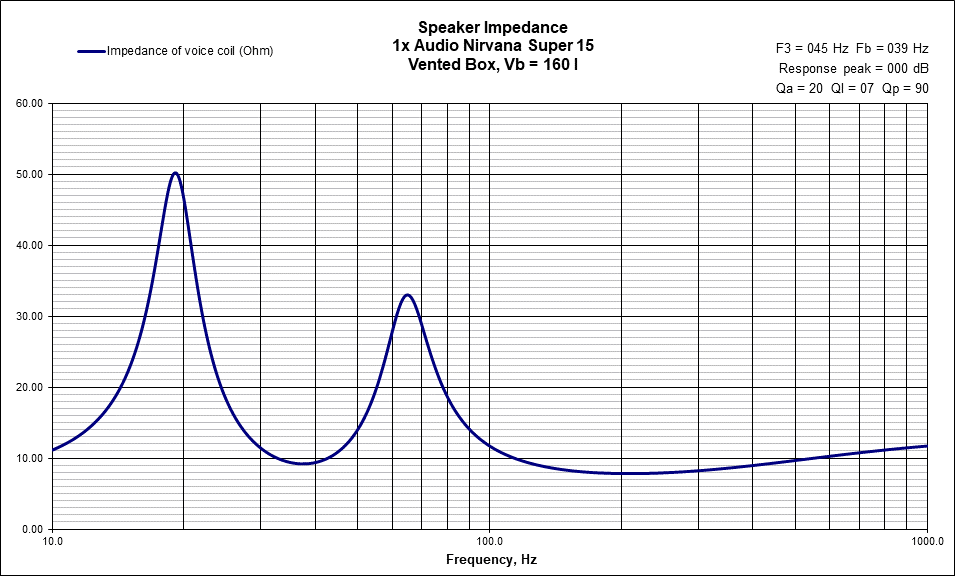

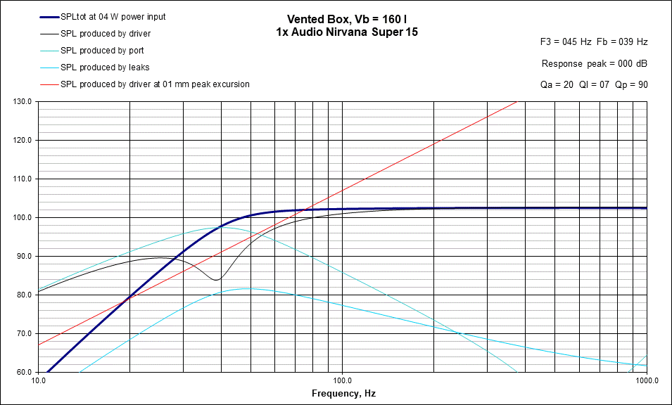

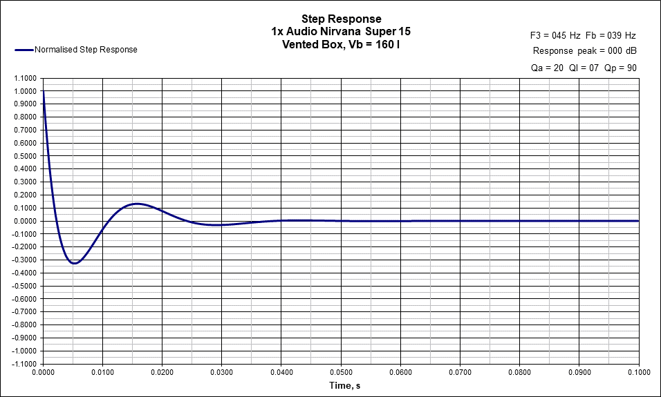

Anyway, using the unibox spreadsheet, A 160L (5.7 cu ft) box tuned to 39 Hz appears to have (again, untrained eye) a nice flat response with
F3 = 45Hz
F6 = 37 Hz
F10 = 32 Hz
If I'm reading things right, it takes only 4W to approach its its modest 1mm Xmax in that 160L cabinet, resulting in an SPL of 102.5 dB at 1m. It seems to me the strongest advantage of the bass reflex box with this driver is to tame the Xmax in the 32Hz - 56Hz band. Looking at the closed box numbers, it would exceed Xmax below 56Hz, and be up to 1.6mm at 32 Hz.
I've attached some sheets from Unibox, reflecting a signal of 4W to this driver in the 160L enclosure

I come to similar results when i model with the published specs, but the question is how far are they off (as AN is notorious for this) in real life. It's actually one of the better drivers on first sight, altough it will need a tweeter for above 10kHz and the response is not flat at all. It will need an attenuation filter (inductor and resistor) above 600Hz to flatten out the response also. And don't give it more than 6w or the bas response is cutted by the limited excursion of the cone.
