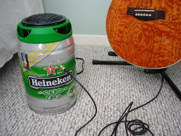

I been looking at the various DIY projects here, and started thinking; "How difficult would it be to turn an Newcastle Mini-Keg, or Heineken Mini-Keg, into a Party Rocking System?
My thoughts are basically a good down facing Sub-woofer, a few horns, an headphone jack, or RCA inputs on top and finally, an internal rechargeable battery (for long lasting music)
I could only imagine the look on peoples faces when you show up to a party with two mini-kegs in hand. (One for drinking and the other for rocking the party)....
I've actually already got a few empty mini-kegs sitting in my garage.
Anyone have any ideas, and/or recommendations on what would make this thing work?
I got my idea from the picture attached.
Thanks in advance for any help,
DJ-1

A guitar preamp and a class D power amp, both in kit form. Batteries also to reside in the keg.

With some noise absorbing carpet inside.
I can recommend a driver, Kicker makes some ok 6.5" subwoofers.
As for a battery you would be limited to 18650 or lithium, sealed lead acid is too heavy and clumsy and nobody really respects the proper charging methods for SLA ending up in a battery which will only last a year. SLA is never meant to be discharged below 50% depth, that means 12.3v.

I build a nice little Wammer-Jammer with a 6.5" single point stereo ceiling speaker and a small chip amp. It accepts line level input so if you wanted to connect a git-fiddle to it, you would need a preamp..
This is quick and rough but it worked out well. It's a 2 gal. plastic paint bucket with ~2" of plaster of paris poured into the bottom to stop the drum head effect. Ended up with an internal volume of ~.2 ft. Damped the internal sides with some cotton batting. 3.5mm input, vol. control, 8 "AA" batteries and an LM7805 regulator. Plug a portable Bluetooth rcvr. into it and it's wireless. I have some refinements in mind but that will be for another day..
