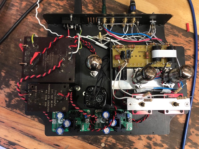

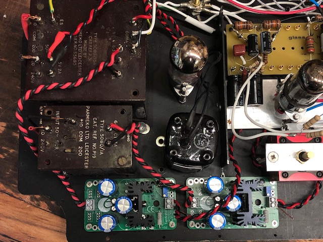

I'm building a 6sn7 pre amp with vintage parmeko transformers and choke (supplied as "kit" by a local tube amp builder),and have been battling to get rid of hum (even with the suppliers assistance)
It seems like 50Hz, and is not affected by the volume pots. What I have done so far: I tried moving the transformers, choke and rectifier tube far away, changed tubes, changed rectifier tube, added DC supply to the heaters (from tentlabs, but actually made for directly heated tubes) I've added shieding over tubes, between transformers and everything else. Any ideas?

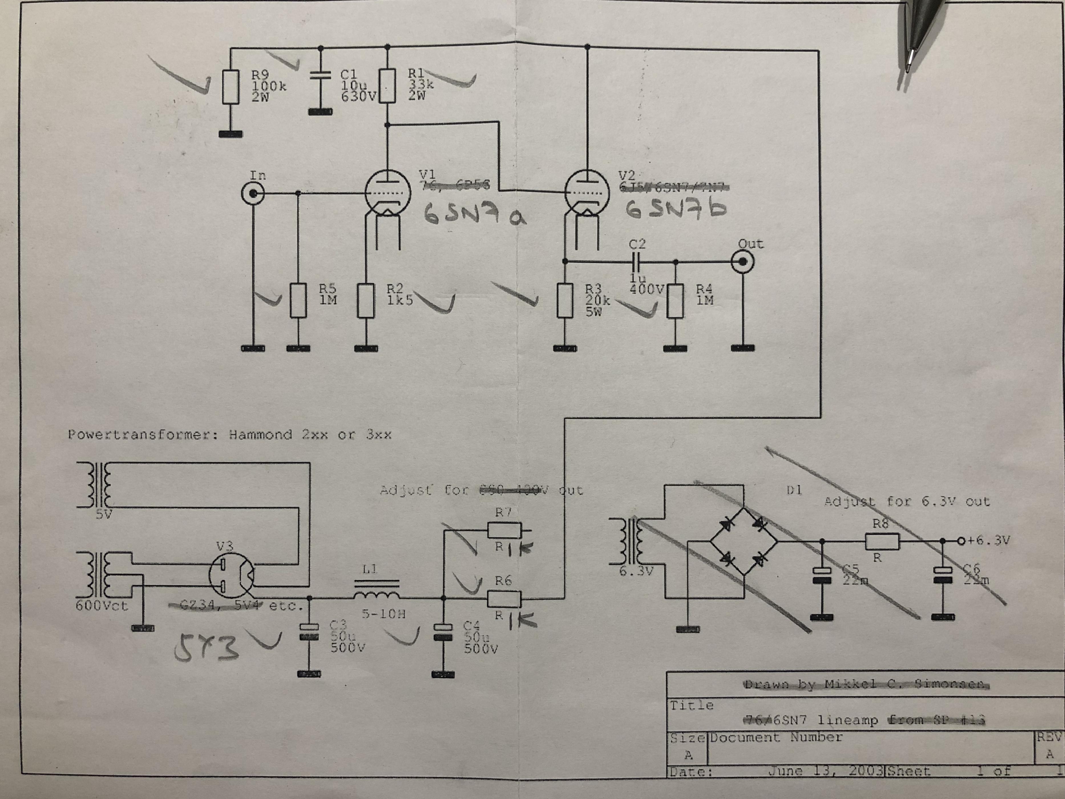

Here's the schematic
