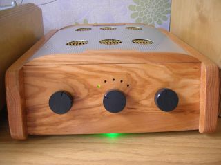

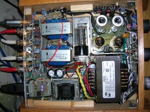

This is my RH84..its been posted to many times but it gives an idea and you can see the output Tx's. XSE-15-8-5K
As you can see its an enclosed design..many people like to build open chassis.
You may want to build a baby huey.. 😀 Its a PP design..so its time for others to give some ideas..

Sorry, my mistake, the carbon comps were all 1 watt, unless in the power section then they were 2-5 watt. I like your build, it is surely tight in there though! I know a lot of guys in the US have used Edcors, especially for clean, high headroom builds. This is shaping up to be a whole load of fun.....
