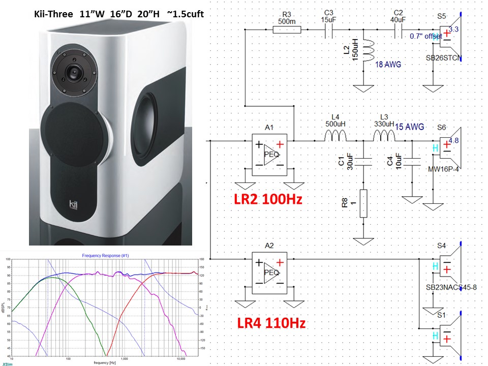

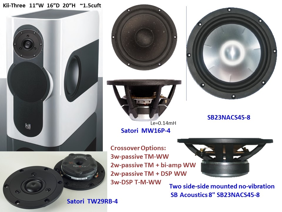

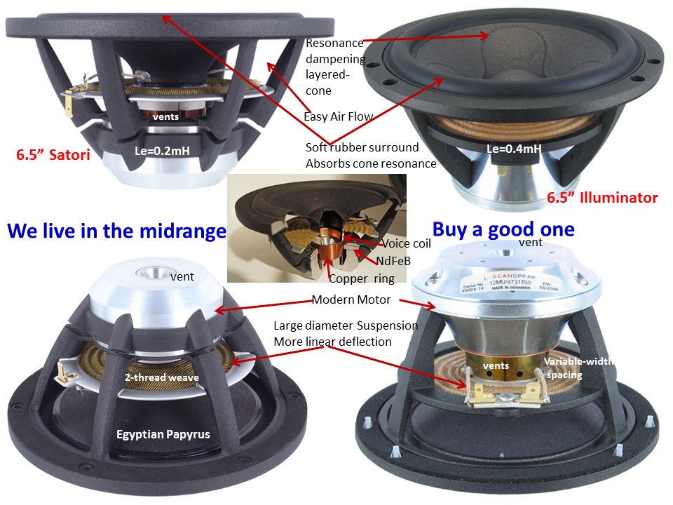

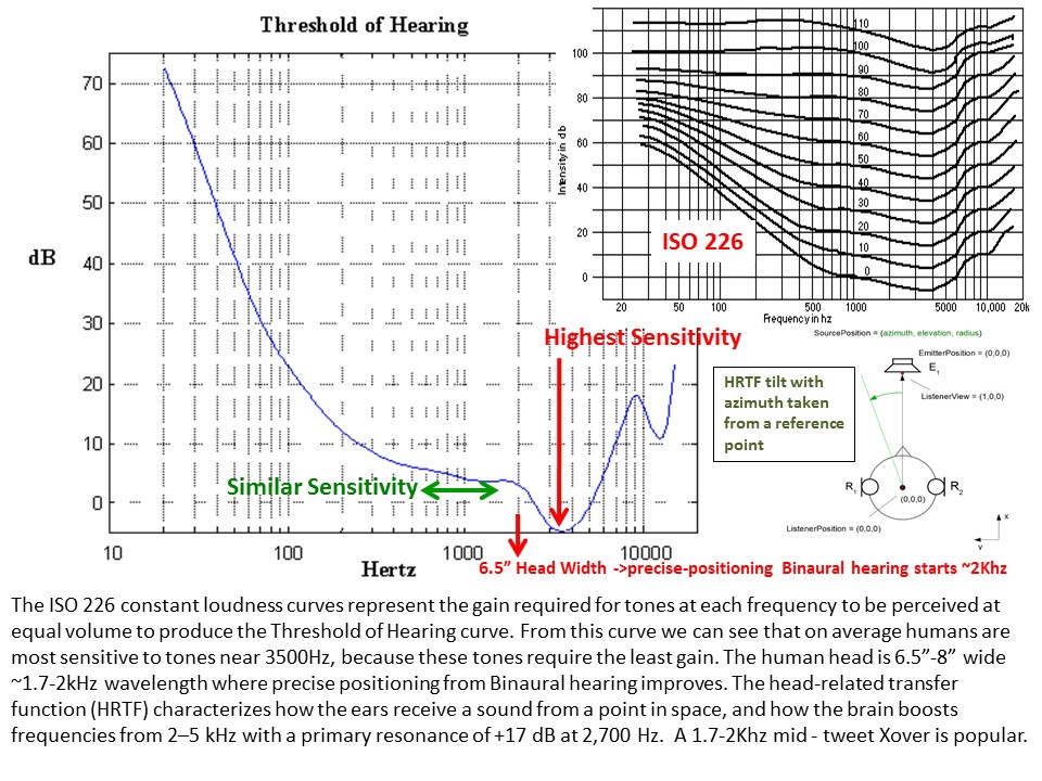

"We live in the midrange." For close-up desktop listening many favor putting the human vocal range(~80-1700) on one exceptional 6" midrange like:
1) Satori MW16P-4 with the natural sound from a Papyrus paper cone
2) -OR - SB_Acoustics SB17NAC35-4 with the detailed sound from a ribbed aluminum cone
3) Satori TW29RDC-4 dimpled 1.1" dome tweeter ideal for crossovers around 1700Hz.
----a T-M crossover ~1700Hz has an 8" wavelength which helps produce a "point-source" image
The SB Acoustics 8" SB23NACS45-8 woofer uses a new ribbed aluminum cone for both extra stiffness and significantly reduced cone breakup. Reviews are all positive.
Crossover Options:
3w-passive TM-WW
2w-passive TM + bi-amp WW (proven passive TM Xover is available)
2w-passive TM + DSP WW
3w-DSP T-M-WW
If you can build a wooden Kii-Three shaped cabinet, there is enough knowledge on diyAudio to help you achieve success..

@LineSource: Thanks a lot for the suggestion. I researched this a bit and I guess the problem is that this does not only require the speakers, but a quite complex system around, like a active crossover with several amplifiers to adjust each channel separately?
If you can bi-amp with either basic LR2/LR4 slopes, or with software/hardware DSP, a modest complexity passive component crossover is possible. -example-
If you can tri-amp with software/hardware DSP the (no passive parts) crossover can be accurate for time and room effects.

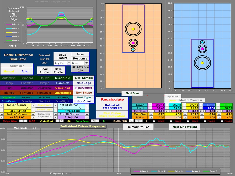

As you see, the front panel with the drivers has some chamfering. Is this only optical or with a function? Troels writes:
"As always: Any change to front panel dimensions or drivers' placement and you need a new crossover - and I can't help."
Does this also concern the chamfering? I could imagine this speaker but with a nice veneer, therefore I would want to keep the surfaces straight.
The chamfering is functional, it reduces edge baffle distortion, BUT a good designer seeks artistic value in the edge bevels - or- rounds edge cuts.
In a comparison test, most listeners can hear a difference between cabinets with sharp edges vs. deep edge bevels or edge quarter round router cuts. There are several good baffle edge simulators which a designer can use to grade the value vs. complexity. -OR- you can just copy off the smart kids and mimic a proven design (Avalon truncated pyramid), (Magico Q5 large radius quarter rounds)
Understanding Cabinet Edge Diffraction
