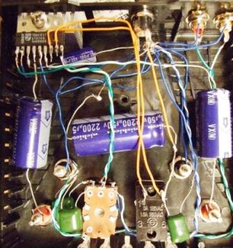

My son and I just built our first amp project but we ran into issues after powering it up. I used a TDA1517 salvaged from an old audio/video capture card and a DSL modem housing. The rest of the parts are new from Ratshack. We can hear music and a thumping sound out of the left channel. The music is quiet and the thump occurs about once a second. The right channel is dead. We are powering it from a 12VDC 1000MA wall wart. I was using a Sony Discman as a source for testing. I will say up front that I did not give enough thought to my ground implementation and plan to redo it next weekend. The volume control and power switch worked as they should.
Left and right are reversed in the image.
This thread contains the wiring diagram I followed http://www.diyaudio.com/forums/showthread.php?s=&threadid=90487 which I confirmed is accurate per the original spec sheet from the manufacturer.
Any ideas? Thanks.

DigitalJunkie's suggestion to solder the power supply bypass caps much closer to the power supply pins is a very good one. Your schematic specifies 100 uF and 0.1 uF from Vp to Gnd. Your photo is not quite large-enough for me to see if the 0.1 uF cap is present or not. In any case, while it is more important for the smaller cap to be closer to the pin, ideally the bodies of both caps would be as close as possible to the chip's power supply pin. (Also, you might want to experiment with connecting the ground end of the caps directly to the Pgnd pin (5).)
Wait. Are you SURE that the photo is left/right reversed?? If it's not (and it looks like it's not), then I don't see either the 100uF OR the 0.1 uF (100 nF) that should go from pin 7 to gnd! That might be your main problem. Solder them directly to the pin, with leads as short as possible, at least for the ones that connect to the pin.
Soldering: When soldering, you should try to use long-nosed pliers as a heatsink, between the device and the solder point. You can use a rubber band on the pliers' handle, for 'hands-free operation'.
I think that your layout and construction technique could be a significant problem. Lead-lengths and wire-lengths should usually be as short as possible, for example. And the enclosed loop areas of to/from pairs' current paths should be minimized. You can tightly twist together any paired wires, to minimize certain loops' areas. Others might depend on your layout being good.
A piece of perfboard, or whatever it's called, should give you a way to mount the components better, enabling you to design a more-compact layout (probably using radial-lead capacitors instead of the axial-lead type). Actually, any piece of thin, stiff, non-conductive material, and a drill, could also be used.
But suggesting a whole different layout doesn't necessarily address the problem you are having right now. Do you have a multimeter? If so, you can do some basic 'sanity-check' types of measurements. I'd start with making sure that the DC voltage between the chipamp's power pin and ground is what you think it should be. You could also measure the AC component, there. I would also disconnect the source and put a short across each input and then measure the DC voltage across each speaker, which should only be a small fraction of a volt.
Does the chip get hot? I cannot quite see how it is mounted. Typically, you would want the entire rear surface of the IC to be mounted against a heatsink. Usually, you would want to make sure that the heatsink is not in electrical contact with anything else.

Hi DJ, you just mount the TDA1517 chip on the top heat sink like that is not recommended, mout it on the flat heatsink not only top of the TDA ics but all the flat ics surface. I did build amp TDA7294 before, what i know is we must use correct heatsink to reduce ics become heat faster and blown ics in few mins, this is important thing to get correct heatsink for each power ics. Make it simple but be carefull with the heatsink thing that will waste your money 😀

Good point. Heat rises. I'll mount the chip on the bottom of the heat sink and see if that lowers the temp. Is that what you are suggesting or do you mean for me to have the actual black part of the IC in contact with the heat sink? I looked on the spec sheet and see that 180F is near its operating limit so the temp needs to come down a little at least.
Hi DJ, if your heatsink doesnt connect to ground (0V) and yes you can mount the ics directly, but if your heatsink connect to amp case which having ground connection you need to use silicon plastic to prevent electrical shock, i suggest for first powerup or testing your amp better use min voltage like 8volt, in normal operation when the amp in on mode and idle, tda ics should not become hot faster, i suggest before you connect to audio source, just test in idle mode lets see the ics become hot or not, if you have multimeter, you can check whether output having high dc current or not, if it doesnt have then power off, connect the output to the speaker and connect the input to the source, see its working or not.

I have 100uF between pin 3 and GND. 2200uF and 104K on Vp. Pins 2 and 5 go straight to GND without any caps. Should I add a cap to these pins? If so I have 220uF available would that work or is that too much?
The heatsink is not grounded.
it seems like you`re following the right philips schematic, vp pin7 connect to +vdc power source and make switch for pin8 to connect to vp and must have 2200uf and 104 or 104 100nf parallel to GND, no need to add any caps to pin 5,2. as i can see you add volume (ROTARY POTENTIOMETER) for the input, try remove this one and connect directly from you sony discman, sometimes wrong wiring on volume control can cause no audio signal.

I think you are both looking at the correct schematic.
The problem (with the caps) seems to be that they are not properly located.
The 0.1 uF (i.e. 100 nF/104) and 2200uF caps' bodies need to be as close as possible to pin 7, with the shortest-possible connections to that pin. If a compromise must be made, then the 0.1 uF caps should be closest to the pin.
I would also add a 0.1uF cap from pin 8 to power ground, similarly.
Any other capacitors that connect to the chip's pins should be located similarly, i.e. right AT the pins.
Any and all 'to/from' wire pairs should be tightly twisted together, e.g. input/input-shield 'gnd', power/gnd, switch and pot to/from, speaker hot/gnd, etc.
Wires with low-level signals should be routed away from high-current wires and components.
All wires and component leads should be as short as possible.
I would also try norazmi's suggestion and at least temporarily try it without the pot, removing the pot's wires at their far ends (i.e. don't leave them dangling from the chip etc, during any temporary test).
First, though, you "must" properly-heatsink the chipamp. Yes, its ENTIRE REAR SURFACE must be tightly-clamped to the large flat surface on the rear of the heatsink!
You should definitely use a thin layer of thermal heatsink compound "goo", between the chip and the heatsink (but can 'probably' get away with not using it, for testing, if none is on hand yet).
Since you probably don't have any chip-to-heatsink insulators on hand, make sure that the heatsink is not connected to anything else that is metal.
Maybe none of this directly explains or solves your problem. But the chip could have already been destroyed by either soldering without heatsinking between soldering iron and chip body, OR, it could have 'oscillated itself to death', because of concerns like those partially-addressed above.
High-frequency oscillation can quickly overheat and destroy a chip. Incorrect capacitor placement, and 'loose' layout problems, among other things, can cause HF oscillation.
It would probably also be very wise to add simple lowpass RF filters to the inputs. For that, you can put two resistors in series with each input, close to each pin (pins 1 and 9), with a small capacitor to ground from between each pair of resistors. Something around 470 Ohms for the four resistors, and 3300 pF polystyrene (probably best) or polypropylene or polyester or silver mica, or a C0G or NPO ceramic, for the caps, should work fine. You can scale the component values, as long as the R times C stays in the same ballpark (unless you want to raise or lower the filters' -3dB 'cutoff' frequency. A lower RxC raises it, and vice versa. f(-3dB) = 1/2/Pi/R/C in 'calculator format'.).

Thanks for all of the help with this so far. I redid it as simply as it could be done(for me) with no switch, no pot, and everything as short as possible all per the spec sheet. It sounds very nice even (dare I say it)comparing it to my tube amp. The layout is very ugly looking and I will need to redo it again to add back the conrols and get it to fit into some sort of housing. I'll upload a pic this weekend.
