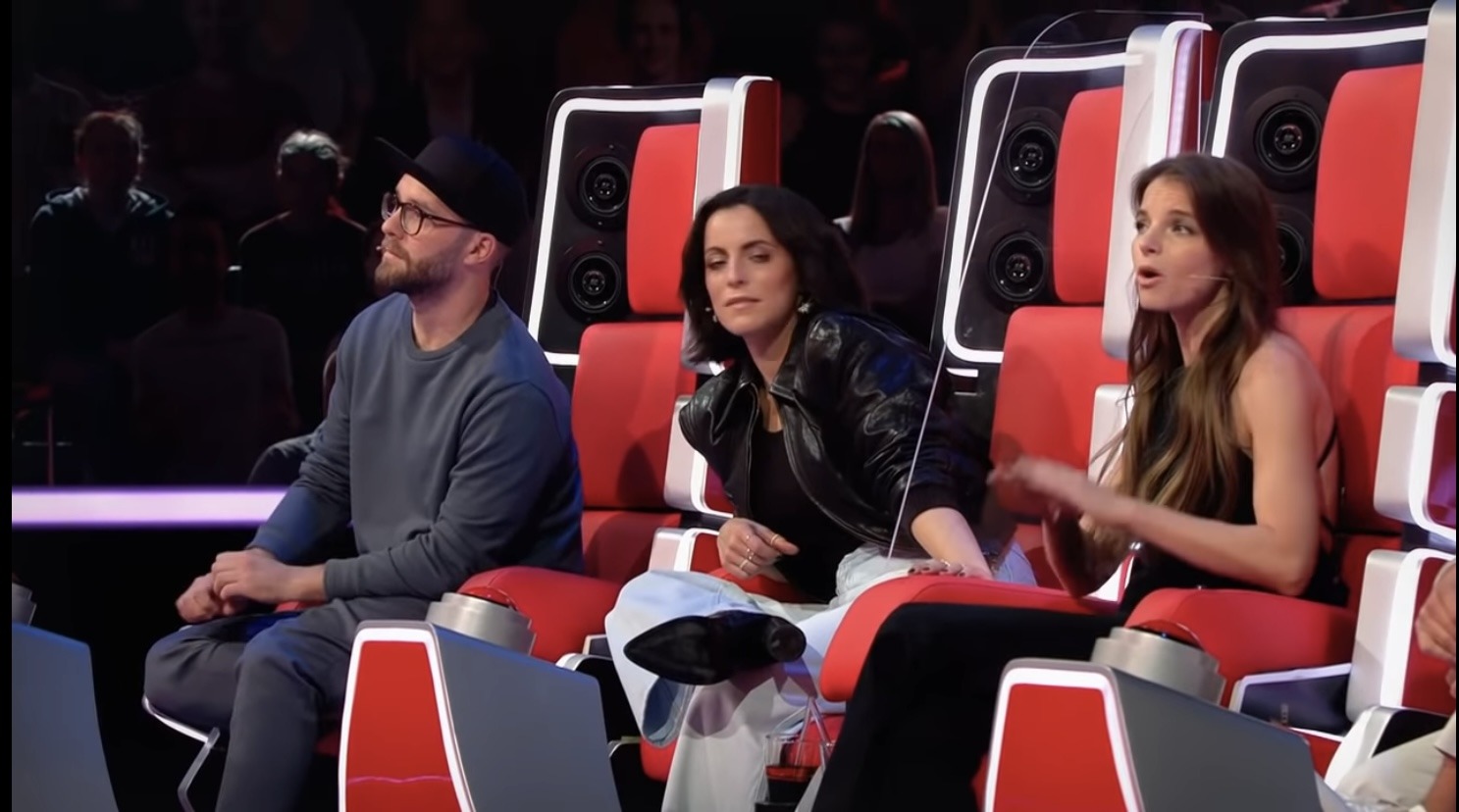

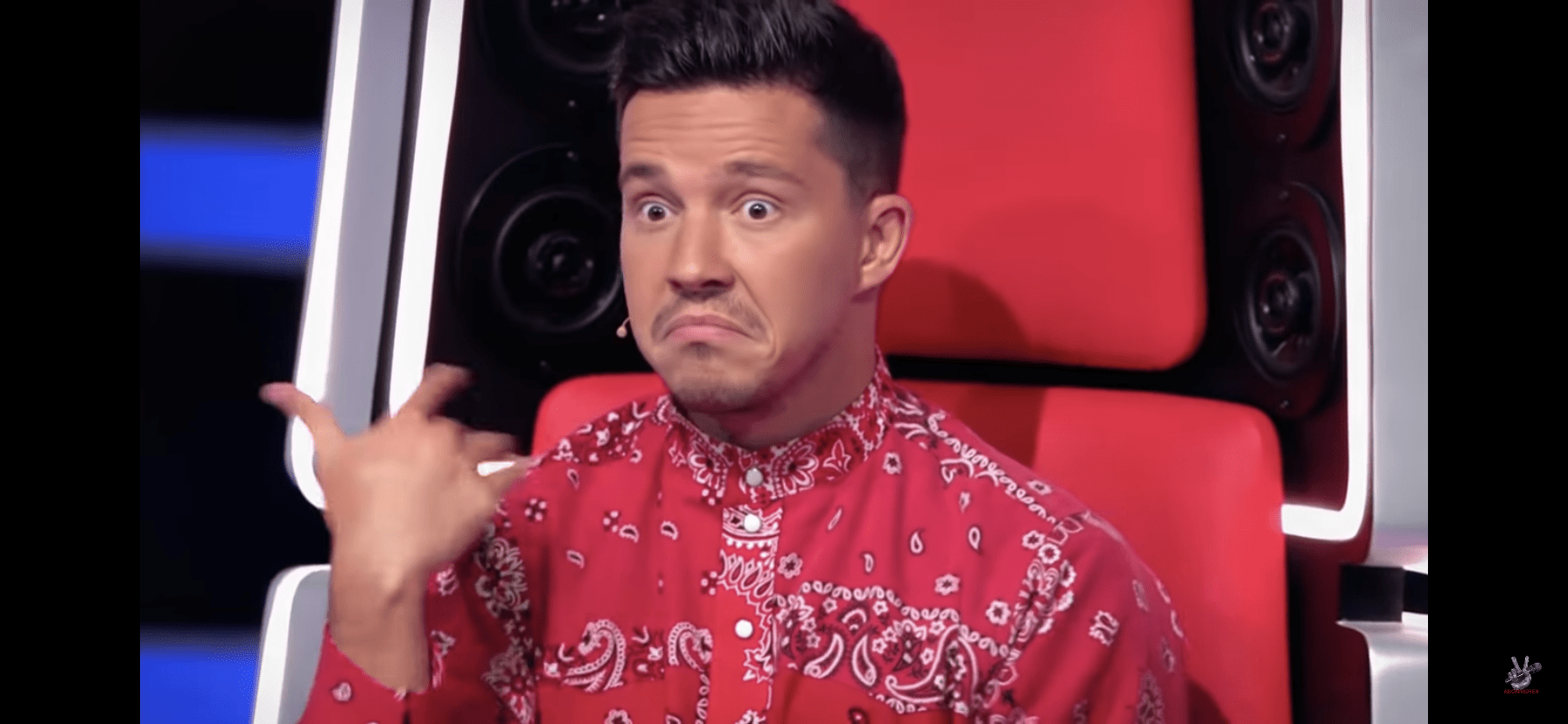

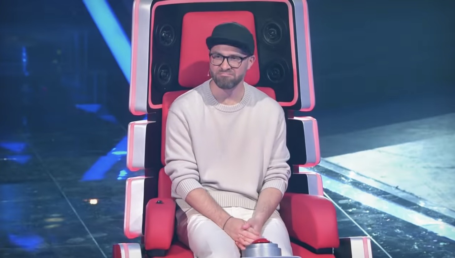

Also, the reality-TV singing show The Voice (Germany) have seats with built in speakers for the judging panel- they tasked with listen and judging (but not looking) at the contestants.
This design would have to bespoke product, and it has gone through a few different iterations. Premium sound no doubt. (Musicians/judges are a fussy lot)
Can you get in contact with someone from the US show?
