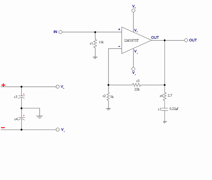

Hello,
is the attached setup good? Can I use this… or does it suck.
Can I live without r4 and c1, or do I need the zobel?
Thank you

Hi Al,
I'm not techno enough to comment on your layout but you generally don't need a zobel in a GC, though it may help if there is a problem with your setup. You can always start without and put it in later.
