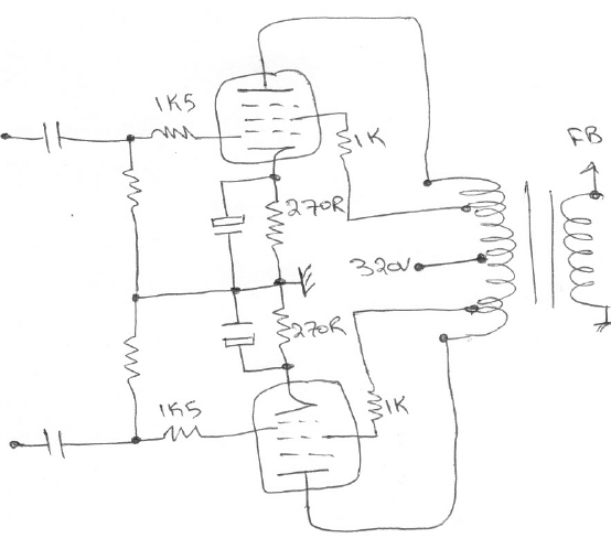

How can I have more watts from this output stage without changing the anode voltage, that is 320V, and the primary of the OPT?
I don't want too many watts but as many as I can.
I will change it from UL to pentode but anything else? 😕
I don't want to buy another PT.
The output tubes are EL34.

You have half of it. Go pentode and convert to fixed bias. By going fixed bias the cathode resistors reduce in value and the voltage that was droped there is avalible for the plates. Just make sure the - bias voltage for the grids is very clean/well filtered/low noise and stable/regulated. I am sure you can find many circuits like this for the EL34 on the web.

One more trick to try is to swap the ultralinear connections to the other side of the Trafo. This gives a few more watts than pentode but with way less distortion. Caution! be careful at powerup as this may not be stable under all conditions. But if it's watt you want, go for it.
If you change to pentode, you'll need a different OP transformer because the required load impedance for pentode mode is only about half of what's required for UL. Maybe you could use the UL taps to get the reduced impedance?

If you go pentode, be sure to regulate the screen grid B+. You will get a lot less distortion to clean up via NFB.
FWIW, I think combination bias might be in order. Use unbypassed 100 Ohm cathode resistors and a bias supply. The slight increase in O/P impedance will not hurt, distortion is reduced, and the operating point stabilized.
You will have to increase the amount of loop NFB in order to get a damping factor roughly equivalent to that of UL operation. Fortunately, pentode mode has more gain to drive the NFB loop.
If you regulate the bias supply, you have to regulate the main B+ too. Either you regulate both the main B+ and the bias supply or you don't regulate at all.
Go deeper into Class "AB" operation to squeeze extra max. power out. Pick an idle current that's close to Class "B" operation, but not too close or you'll notice crossover (notching) distortion. 10 mA. of idle current might be worth trying.

> How can I have more watts from this output stage without changing the anode voltage.., and the primary of the OPT?
You can't. Power is V^2/R. If you don't change V, don't change R, how can you change Power? {oops: SY snuck in and said it first....}
OK, that's over-simplified. As others say, you can get a little more power by eliminating the UL connection. A pentode (often) lets the plate swing closer to cathode than a UL connection. Pentode may also be able to drive a lower load, but you say you don't want to change that. You can get a little more power by eliminating the waste in the cathode resistor and building a low-power grid bias supply.
Such changes give 10%-30% more power, maybe 50% more power if you do everything possible (including the odd inverted-UL or hyper-Pentode mode that dshortt9 suggests). 50% more power is 1.8dB louder. You can hear a 1dB change on a steady tone if you are listening for it; you can't hear a 2dB change in music if you don't know it is coming (and maybe if you do know it is coming).
"More Power", literally, and enough to notice, usually means significant change in supply voltage and/or load resistance (often enough to require a bigger tube).
"More power" can also mean "less strain at higher volume" or simply "louder". Sometimes more (or less) idle current sounds better. Sometimes a change in capacitors will make a tube amp sound like more power than before, because of less bias-shift on musical transients. Or in some situations, more bias-shift and rail-sag gives "impact" that a very-stable amp may seem to lack.

The primary load of the OPT is 3,3K.Is this good for pentode mode?Or to use the UL taps?If I'll use them then the primary load is lower than 3,3K so more power,right?
Before I go with fixed bias I can change the cathode resistors to go more to class AB right?Now I have 270R change them with what kind of value?

Fixed bias is definitely worth doing, whether you stay with UL or not. You can then use the efficiency of AB1.
I very much doubt that the primary load is 3.3k for UL. With EL34s in UL PP, 6.6k is much more likely. You might like to check again.
For EL34s in pentode AB1 PP with fixed bias, you need about 3k to 3.5k plate-to-plate. Note that pentode mode is very critical concerning load: changing to a lower or higher impedance than the optimum will cause more distortion.
One way of changing the effective load would be to use different speaker taps. For instance, I have a 3.5k OPT with 4ohm and 8ohm secondary taps, indended for EL34s in pentode mode. I use them in triode mode, so I connect my 8 ohm speakers to the 4 ohm taps, effectively increasing the load impedance to 7k plate-to-plate, which is OK for triode mode. In your case, if it turns out that the existing p-p load impedance is actually 6.6k, as I suspect, you will want the opposite effect, so maybe you could try connecting the speakers to a higher impedance tap (e.g. 8 ohm speakers on 16 ohm tap). This is not an ideal solution but if you're stuck with the parts you have, then it might be worth trying.
