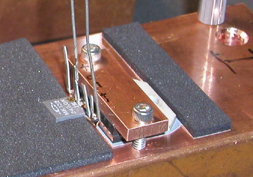

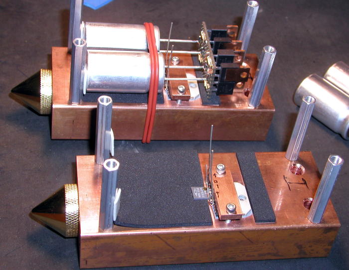

Here's how I attached the chip in my latest amp. I didn't really notice any ill effect on sound from squeezing (although didn't compare), but I also think that comparing to my previous mounting method, this one is definitely more efficient in heat transfer. Although the chassis frame is quite big, it gets pretty warm and I think it's warmer than the previous amps. This could only mean better heat disipation.
Sil-pad was used here.

Clamping method
Yes, clamping method will result in better heat transfer, don't forget the clamping bar on top actually behaves as an additional heat sink because the additional surface area of the clamping bar will further aid in heat transfer via convection also the screws coupling the clamping bar and the chunky heat sink below will allow a certain amount of heat transfer via conduction as well. So actually the clamping method is great from a heat transfer point of view. I think a certain amount of tuning is possible as well, anyone still remembers the Michael Green

Clamping is clearly better than using a single screw. Why? It guarantees better contact since the pressure is more uniform. Using a single screw will distort the soft copper tab and cause the outer parts to rise a bit.
Peter, you amp looks like works of art. However, I'm not sure the copper as you use it is ( monetarily?) effective. Why? The thermal resistance of the copper will be extremely low, but the thermal resistance to the air is high. You'd be much better off fing a U channel or getting someone to mill some grooves into it to increase the surfce area. Or if worse came to worse, clamp it on a drill press and drill some large diameter holes straught thru to induce some convection. My suspicion is that after the first half inch of copper the benefits of copper are 95% there. So if you just use flatter bars you might get the same effect. Maybe the next amps you build can try that.

Of course drilling holes through copper piece would be a further improvement in heat dissipation, but monetarily, it would increse the cost of the amp. Also, the holes in top panel would create different look, I don't know if desirable. And U channels are not easy to find in copper stock.
I used the chunk of copper for two reasons only. To increase the mass of chip assembly and by attaching spike directly, it creates simple way to release any possible resonannces. I also wanted to try if using different material than aluminum effects the sound, that's why copper. It just seemed convenient to use that type of bar and monetary reasons were not really considered in this project.
Now, to go even further (in materials searching), in the next amp I will be using bronze bar, in place of copper, and aluminum panels will be replaced by copper panels (3" x 1/4"). How's that for extravagance?😉
Lovely picture, thanks. And I too would have used a bar on top of the chip with two bolts on two sides. Learned this technique from Randy Slone; his power amps all use this approach for clamping power transistors to heatsinks. He uses an aluminium bar, and he also mounts his 75-deg Celcius thermal switch on it. (Of course, separate thermal protection is not needed on a chip amp; that was just an aside.)Peter Daniel said:Here's how I attached the chip in my latest amp.

I wanted to do it clean, without thermal grease. The bar on top improves further heat transfer. This amp is definitely running warmer than my other ones.

Thanks, Peter. I think that's all I needed. I'll certainly use the bar on top. You've confirmed my earlier suspicions that just one bolt on top is no way fix hot components on heatsinks, and Randy too knew this all along, I guess.Originally posted by Peter Daniel I wanted to do it clean, without thermal grease. The bar on top improves further heat transfer. This amp is definitely running warmer than my other ones.
