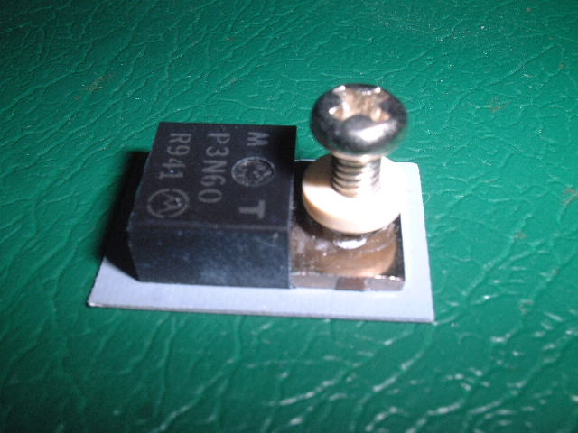

I don't know if this idea is something to be too proud about...
yes, anodized Al is an insulator but it seems to me you are flying too close to the skyscrapers here. A pad is not such a big deal and it puts a nice level of safety between the chip and the heatsink. That way you could use a metal screw and tighten the chip a bit more against the HS.
Or do it like this..
Perfect example.
