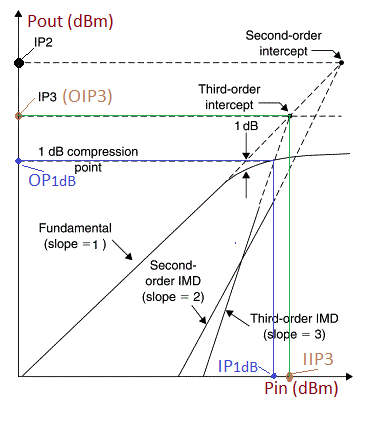

PRR,
As always, some important points.
Thanks!
You made me think again, about 2nd order intercept, and 3rd order intercept.
Both for Harmonic Distortion, and Intermodulation Distortion.
You already know that.
. . . . But just for Newbies . . .
I used to describe 2nd order harmonic distortion this way:
One race car, "Fundamental" starts the race first, going 100 MPH (or 100 KPH).
A second race car, "2nd order" starts Much Later, going 200 MPH (or 200 KPH).
Eventually, the "2nd order" car, catches up to the "Fundamental" car.
(The Rate of Closure is 100 MPH or 100 KPH).
That is 2nd order Intercept.
I used to describe 3rd order harmonic distortion this way:
A second race car, "3rd order" starts Much Much Later, going 300 MPH (or 300 KPH).
Eventually, the "3rd order" car, catches up to the "Fundamental" car.
(The Rate of Closure is 200 MPH or 200 KPH).
That is 3rd order Intercept.
For Intermodulation Distortion, the Race Car Scenario is the same, except that there are two original tones:
two "Fundamental" cars, and two 2nd order cars, and two 3rd order cars.
Two @ 100 MPH; two @ 200 MPH; and two @ 300MPH, respectively.
Of course, in electronics, the signals never quite reach the Conceptual Intercept point.
Everything is clipped and limited first.
But for the linear, well behaved, signal levels, those rates of closures are true.
This is taught, and easily remembered, when shown on a spectrum analyzer.

"Simple" amplifiers (generally single-ended without NFB) have super predictable distortion profiles. The RF engineers use this to simplify a wide dynamic range into just a few numbers. These "intercepts" are not real points but allow you to back-plot the distortion lines.
As you see, the ratio 2nd/3rd depends entirely on the signal level.
PRR,
Thanks for posting the graph.
Another important point on the graph is the 1dB compression point.
That is the point where the increase of output voltage does not follow the increase of input voltage, and the output lags behind by 1 dB.
In voltage terms, -1dB, the output is lagging by 0.89, instead of by 1.0 (89% of the expected total increase).
I used to use a signal generator, 1dB and 10dB step attenuators, and spectrum analyzer to measure those aspects . . . harmonics, intermodulation products, and 1 dB compression.
Your point about single ended without negative feedback is important.
I used the words "well behaved" region, because those are where the results are as you said: "super predictable".
I believe that those well behaved super predictable regions are similar to what occurs in nature.
A loudspeaker may have similar response, until it gets near the 1 dB compression point.
I also believe that for triode push pull amps without negative feedback, similar well behaved super predictable regions exist.

............I also believe that for triode push pull amps without negative feedback, similar well behaved super predictable regions exist.
Yes, except the 2nd harmonic and its notional intercept are pushed "infinitely" up-right through cancellation. (Never perfect but often perfect-enough.)
