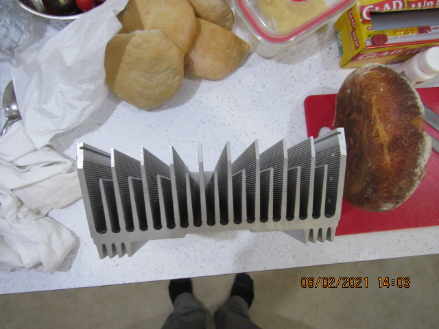

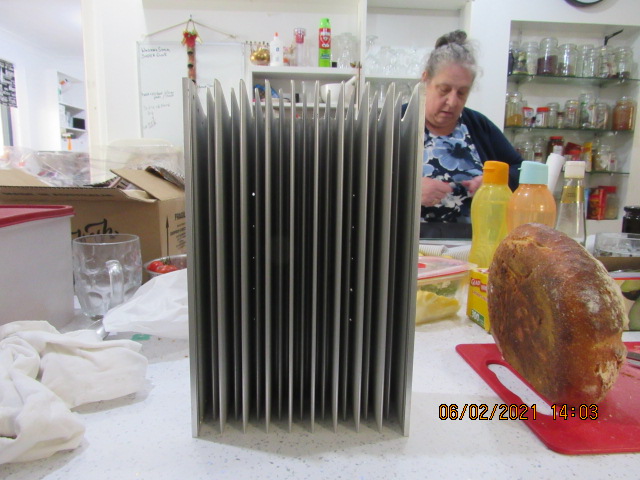

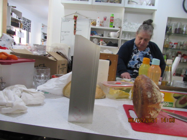

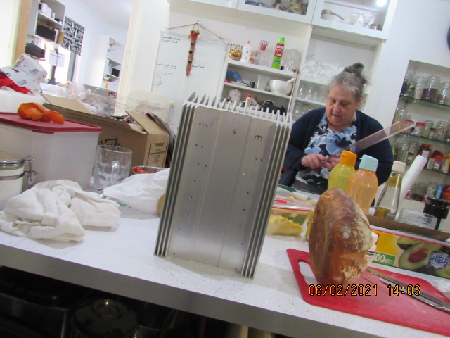

Rod E's page does say they if making the high power version you need really big heat sinks and active cooling. Is it possible tho to have heat sinks that are too large?
I have come into the possession of a large heat sink.
It's 3700grams, multi finned, 270mm tall, 180mm wide and 75mm deep
I think it came from a rooftop solar array originally, the donor never said but he's a solar installer
Adequate?
Too big?

For a medium high power amp, it sounds about right for one channel.
Maybe more with a fan. Can you get another one?
That's interesting as it's about 4 times the size and weight of the combined heat sinks in my 300W stereo amp. I thought it might be too big 😀
Heatsink can never be too big. I think you could easily run a 300-500w AB amp on that heatsink. Although you cant expected full power continuously.
What wattage are you looking to get? Rod’s P101 is only 2-pr of Laterals, I would not go over +/-55Vdc which will be about 150w at 8-ohms, and 250w at 4-ohms. Don’t use for 2-ohm load either.
For a sub I would be looking for 3-4pr of outputs, not for more power (although you could push to 60-65Vdc at the limit) but to operate more in its SOA for a 4-ohm load
