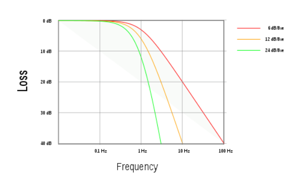

It depends on the 'slope' of the crossover. With a first order filter slope, 6dB/octave, the level rolls of with decreasing frequency by 6 dB per octave, and at the xover frequency the level is down to 0.7 times.
With a 2nd order xover, which rolls of at 12dB per octave with falling frequency, at the xover freq, the level is 0.5x down.
Xover filters are never brick wall, but roll off gradually, the steepness of rolloff depends on the order of the crossover filter.
The higher order the filter, the steeper the roll off (and the more complex the filter!).
The example shown is a low pass but hi pass is the same, flipped around.
