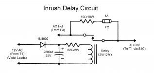

Yup the circuit description is functionally what I described, all the lightening and surge protection is extra. How do they do this so cheap is always a wonder.
This one is $5 cheaper without the lightening protect just the ntc and shunt relay, and more compact board:
AC 150-280V 100A 4000W Power Supply Delay Soft Start Board For Class A Amplifier | eBay

12V might be the coil voltage, eh? ;)
In any case, 'You won't get what you don't pay for' -- the performance won't be any better than their engineering skills, minus every cost-corner they could find to cut. It might be perfectly serviceable; it might not. And you won't know 'til you've put it through all the testing you'd have to do if you designed your own.
