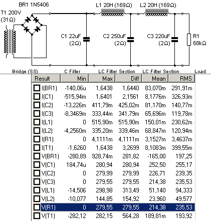

Finally, when I simulate this circuit in the PSU Designer II using a SS bridge, I need to use 190 V to get a few volts above 240. I use default Ohm values. (With a 5-Ohm load, it's a bit over 230 V.) Does this mean a 190-0 transformer? I mean, that's very far from the 180-0-180 transformer in the GZ34 schematics. Not even this tube newbie believes the GZ34 consumes 170 V. So what is going on here?

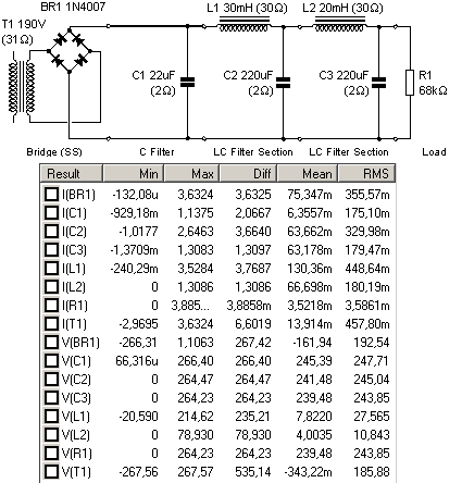

I realize now that I hadn't studied up enough on the subject when posting my questions. So I'll give it a final go here.
I think I have taken the design as far as I can. I have these things left:
Am I doing right when I add a 68k resistor as load? There's a 68k resistor on the preamp power input.
Will the splitting of the PSU into two 20H chokes change the characteristics? As I understand it, it shouldn't. The problem is that my understanding might be faulty.
In the end my question is: will this design give me the 230 V I need?
