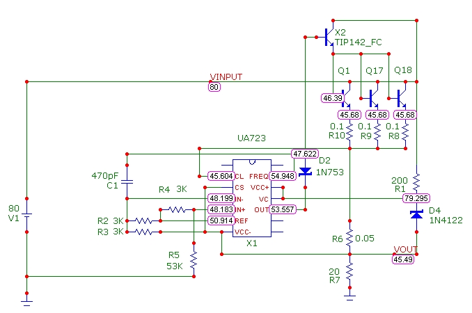

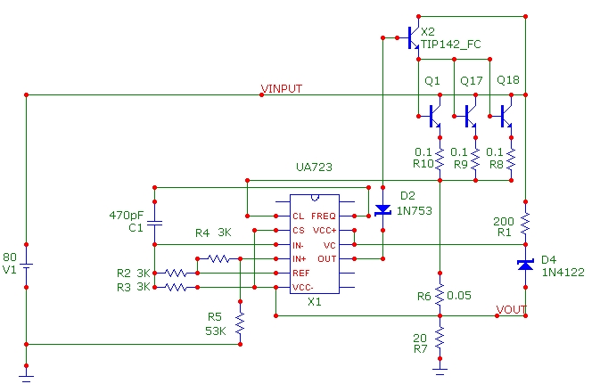

Hello friends, I am a newbie to SPICE nad Micro-Cap.
I need help with this simulation. It is about a 50V @ 10 A power supply.
The original circuit was taken from the National Semiconductor LM723 datasheet.
I added one Darlington and extra power transistors.
The problem is that before going deeper in the simulation, I can see that the D4 Zener diode shows a very high voltage of almost 80 V instead of the rated 36 V.
I tried to lower the output current and I think that leaving the CL and CS terminals of the LM723 is not a good idea for the simulation.
I searched for some specific Micro-Cap forum in Google but no luck.
What am I doing wrong ?
Thank you in advance.
