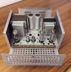

I am building a 300b amp, and am building it in two parts - PS and Amp.
The PS chassis has two power transformers (one for HT, one for Regulators), and one choke. The amp chassis has two OPTs and two chokes.
What orientation conditions do I need to consider?
On the PS chassis, do I align the two power transformers and put the choke at 90 degrees to them?
And on the amp chassis do I put the two OPTs 90 degrees to the chokes?
And should I align the chokes across both chasses as they will be close to each other, or is that not so important?
Many thanks for your help

So to finally answer your question: rotating transformer cores so that they are not aligned, but at 90deg. with respect to one another can greatly reduce induced coupling between them. Further reduction can be achieved by separation of the two transformers from each other.

Trans should always be 90 deg. rotated to another.

Back on topic. If the transformers are not too close it's not a big deal. Few centimetres apart is already ok to not be worried if they have the same orientation. Put the chokes 90 deg and should be fine. Usually the chokes are the more critical ones because they are supposed to filter and if they pick up noise they become almost ineffective.
There are three orientations, and ideally the power transformer(s), the choke(s) and the output transformers' cores should be in three different planes. And, again ideally, you'd want the center lines of the cores to line up. And, as already said, distance is your friend. Some of these ideals conflict, and all are undermined by a steel chassis. That's HIFI!

If the distance is long enough, it doesn't matter anyway.
