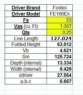

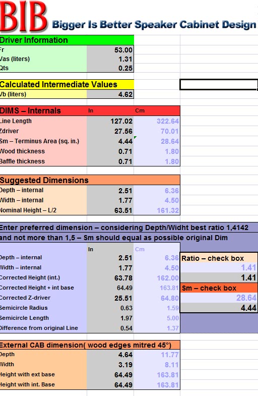

If you are very serious about en driver with BiB cab pls tell me so. I will run the calculation and compare with yours. Pls note locally available ply is not 18mm rather 17 mm so in inch it should be closer to .7. Also note when building cab I prefer slightly larger than cal dimention because of three reasons 1 drivers change spec after burnin/over time, for fostex specially factory quoted Vas and Total Q are conservative last and most important you can damp a over size box, can not do the opposite.

I got my hands on some "Marine Grade Ply" - and according to my measurement this is 18mm (unfortunately I do not have slide calipers, got ruler only 🙂). The material is much stiffer and heavier vs standard "decorative ply". It's made in India by Evergreen (an Indian brand) I think. The boards are made of Garjan, which is a hard wood. I was planning to buy standard ply boards when I came across a post from ChrisB where he explcitly advised against the use of standard ply boards. At first people gave me funny looks when I was asking about 11 layer ply board but managed to get the message through eventually.
I was planning to round off the internal dimensions and do the build - that should give me slightly larger box dimension, right? Another forum member sent me some cutting plans for 8' x 4' boards - he's recently done a FE166En BiB build and loves them. I you propose larger cab larger by how much?

Get your driver and pls let me know we will run the numbers together. Meanwhile pls look for measured spec, for example, like this one, Fostex FE206E Fullrange Loudspeaker Driver then you do not need to cut your ply any larger. Otherwise you may go by 1''x.1'' for sure.
However to my knowledge Austin166 is the best cabinet for older fe166e driver period. But 166en is ok with this or not I dono. Dave from planet 10 may know. Pls note Austin 166 is much complex to construct.

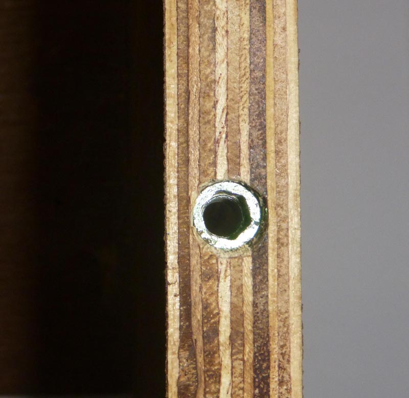

Picked this up from a hardware store - 1/2" hex insert and 2" screw - thinking of using these for fixing the removable front panel of my BIB cabs. That way I don't have to be worried about any wear and tear on the screw holes resulting from taking the panel off and fitting it back again multiple times (for damping adjustment).
My front panel is 1.5" thick because of using 2 layers. Back is also 1.5" thick and fixed.
Any harm in this approach?

1/2'' insert is no good cause load is on a small area. For 1.5'' thick buffle you need 2.5'' good quality wood srews. Adjustment of damping material is a bit difficult but possible through the driver hole.

Screwing into the end grain of plywood (and even worse in MDF) is never a good idea. Using threaded inserts will work much better than plain wood screws. 6mm(or 1/4") bolts should work fine in this application. I have no idea what is available to you in Dhaka, but at least here, longer inserts are available and you should use the longest inserts you can get.
If you do it right, the bolts could easily be your final finish. I would use Allen head (hex head) cap screws, and if counter sunk, they would look very nice.

Thanks for your inputs. 1/2" insert is the longest I have found in Dhaka. Another way can be, I make a deeper hole and screw in 2 inserts (one after the other)- that way I get around an inch inside of the ply. Not the best solution, but maybe better than 1 insert only?
The screws are 6mm, and I can get both 2" and 2.5" lengths.
How many should I use? Cab width 11" and height 64.5".

I don't think that you can stack the inserts -- you will never get the threads to line up. I'd put the bolts every 15cm or so. However long you make the bolts, make sure that the bolts don't bottom out in the holes. That can cause the inserts to strip out.

Thanks Bob. 15 cm distance between screws means roughly 10-11 screws per side of the removable front panel for this build.
Will be setting inserts an extra 2-3 mm deeper so that screws don't bottom out.
