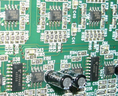

Alesis ADAT AI3 replacement opamps
Thanks for all your help with the CD player.
My new project is to replace these surface mount 4560 JRC ops, in my ADAT interface. What would be a good choice. There are 2 in each channel. There are 8 channel in and 8 output channels (that eqals 32 ops). I was thinking of trying out by modding 2 input channels and 2 output channels, to see the result first. Then i would have two '"super channels". I don't have a schematic, so it might be some guesswork here...

I'm a total newbie to soldering surface mount chips. I watched some instructions on youtube:http://www.youtube.com/watch?v=e5qYG95bbz8
I have good soldering skills though, since I used to work full time with electronics years ago. So I think I can manage. Do you have any experience in this field?
