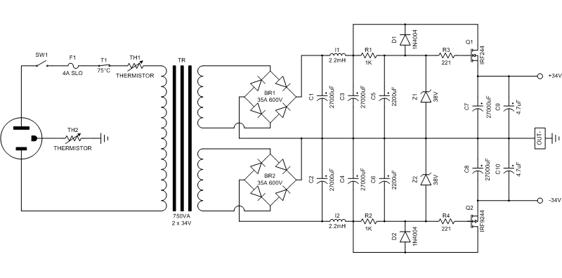

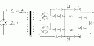

OK, work took me out of action for a while, but I am getting back moving again. My new question is this:
I think I might have become a little overzelaous with my pursuit of a really good power supply design for an Aleph 5, so I am posting it for a little feedback. It should be ultraquiet, but I wonder about it's response to transients.
I would probably go for the first one (not regulated) 'couse this is already an up-grade of original.But I'm no expert and I have no Idea how both would compare sonicly.
Also is one IRFP244 enough for positive and for negative rail.I suppose You might need paralleling more of them.
