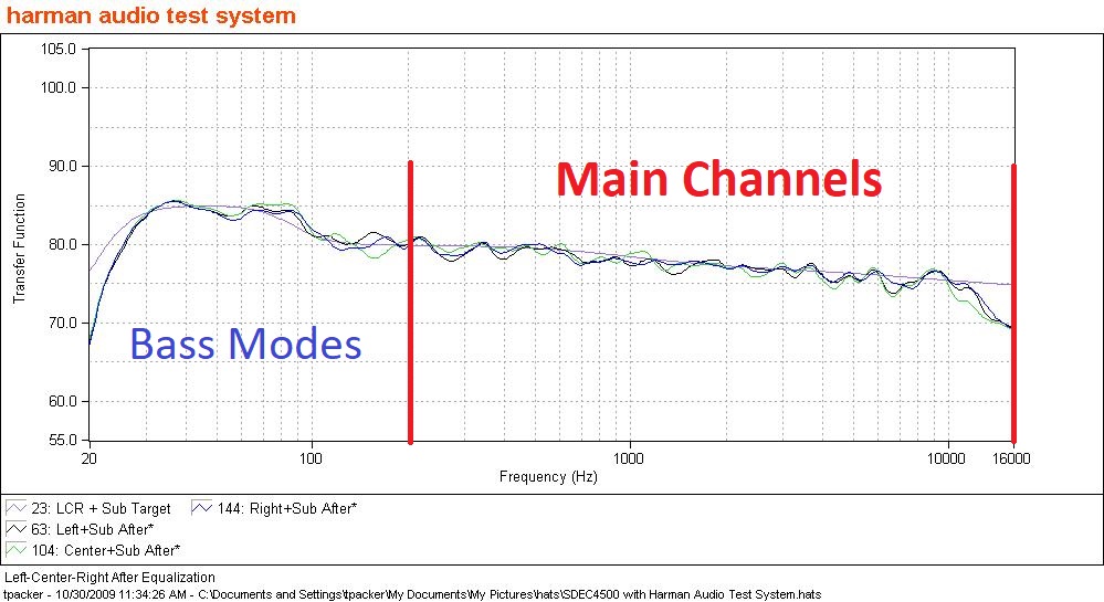

Everyone interested in audio should have a microphone ($16 to $75 and up) and REW software (free.) The reason a mic is important is it helps you equalize high frequencies and identify low frequency room behavior as you move subwoofers and seating locations around the room. The microphone helps you from wasting time running down rabbit holes as your ears and brain deceive you.
Dayton Audio UMM-6 USB Measurement Microphone
In addition, REW software plus a microphone will automatically equalize DSP settings (filters) to approach an ideal home audio listening curve. I've attached a graph by Harman to show you what that looks like.
After you use the automated DSP filters you can add manual tweaks to suit your preferences. Or not. The automated system works really well. But the mic + software reduces a great deal of the confusion people go through trying to equalize their speakers. A $16, $75 or $120 or more expensive mic is worth every penny in time and confusion saved.
Do you need some of the other audio tools? Probably not. Once you've moved to DSP + individual amplification you don't need the stuff that helps you build passive crossovers.

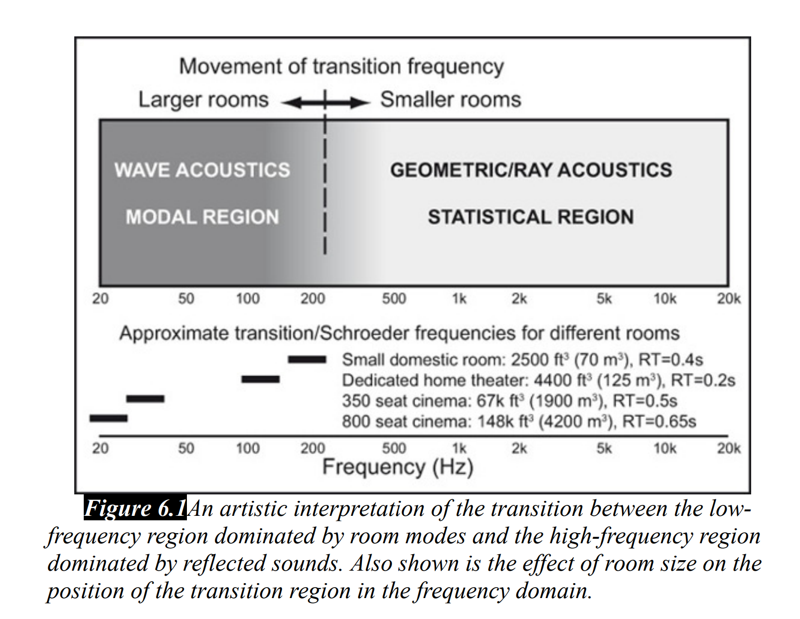

Box/cabinet building is another area that will be easier for you as a new DIYer using DSP. Cabinets get complex as people try to combine high and low frequency transducers into a single box so they can be driven by a single amplifier. Sometimes, people build complex cabinets to extend low frequency performance. But it's all for naught because the room screws up the low frequency response they designed into their cabinets. As a new DIYer you won't suffer through that because you'll design one set of cabinets for mid/high and a separate set for lows. Not only will your boxes be more simple they'll be more effective. Your speaker cabinets may very well look like a couple of simple small bookshelf speakers in addition to one or several simple subwoofer boxes. Of course, it will all be individually amped DSP.
The book I'd recommend reading is Floyd Toole's Sound Reproduction, 3rd edition. You won't be suffering through the problems introduced by passive crossovers so you'll benefit from learning how sound works in small rooms in addition to how humans hear and interpret music. You'll also learn not to judge your speaker system by the poor performance of a poorly recorded music soundtrack. People who do that wind up endlessly changing things and it never works. Toole's book will save you from spinning your wheels.

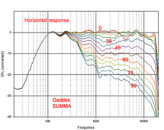

As always, context matters. For example, I pointed toward Geddes' solutions to modal behavior of low frequencies in small rooms. Geddes individually amplifies multiple subs to deal with small room modal behavior. What does he think about the added complexity of multi-subs?
Geddes added DSP to his high frequency speakers but it was difficult because he had to customize his receiver. He converted a commercial off-the-shelf home theater system into a custom system. Yeah, sounds like an enormous headache to me too.
I do disagree with Geddes when he says there aren't inexpensive solutions to the home theater problem. If he streams, he probably streams from a streaming device like an Amazon Fire then sends the audio to his home theater receiver. But if you stream video through a personal computer the DSP+individual amp solution is inexpensive. IMO, home theater receiver setups are a solution for the days of Blockbuster not Netflix.
Personally, I lean toward using PC for the primary home entertainment area because today's entertainment includes things like YouTube videos. It's hard to navigate through YouTube and Google with a streaming box. I guess that same evolution kind of makes dedicated home theaters obsolete too.
Which brings up another interesting subject related to Earl Geddes. Geddes prefers speakers that supply a narrow soundfield in his home theater in the geometric acoustic region to contend with room reflections and please seated listeners. He's liked it for 20 years. In contrast, Toole discusses good speaker design in his book and says experimental results suggest consumers prefer wide directivity speakers. Toole shows wide directivity spinoramas as examples of good speaker performance. So, two different approaches in the high frequency spectrum lead to good results. You just need to be aware of what you're doing and why you're doing it. If a new DIYer just buys a speaker kit they really don't know why the speaker was designed the way it was designed or how it fits into an overall plan. Does a new DIYer have a hard wood floor? If so, they might want to know speakers exist that can turn hard floors into a benefit rather than carpeting their room in the pursuit of good sound. For that matter, legacy DIYers should update their information as well -- there is still a lot of resistance in the legacy audio world to low frequency modal behavior in small rooms despite the science.
