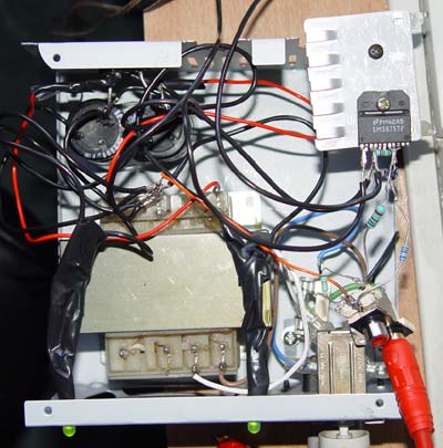

This is was one hell of a buzz. I can't believe I built an amplifier. yay to me 😀.
I used old parts where possible, so this one channel has cost < £10. I followed the NS schematic more or less. It's an absolute mess but it works fine. There is the slightest hum that can be heard only when my ear is put right near the woofer, but I'm hoping that will go once I sort all the wiring up and fix everything in place. I recall measuring the DC offset to < 4mV which looks too good to be correct?
I was somewhere between pessimistic and realistic in my expectations, and although I won't claim some superioior GC sound (well those caps must be 15 years old 😉 to begin with) I must say I am impressed.
I've heard a few tracks, and I feel there is an ever so slight lack of bass (but then again I'm listening on a pair of JBL control 1's at the moment) but the midrange already seems to outdo my midfi mini system. I could hear digitization effects in one (poorly compressed) mp3 track which I'd never picked up on before, and I made out some new sounds in another that I'd never really noticed before. The last time I experienced this was when hearing a pair of Logan ESL's for the first time.
Cheers to Nuuk in particular. Your site is a GC newbie's best friend :up:

Well done Vikash and welcome to the club. 😉
May I suggest replacing those old caps when you can as they are probably more important in the GC design than some other amps where there is more capacitance. :att'n:
At present, the caps are 5600uF. I've seen small value caps placed close to the pins of V+ and V- (in addition to the smoothing caps). What is the purpose of this? Are they used when the PSU caps are far away?
Also, I found a difference when putting a 22uF cap close to pin 8 (and the resistor afterward). What is the name of function of this cap (I know it's not a smothing or snubber cap etc.)?
Lastly, I haven't the faintest idea what the resistors I've used are rated at. Is there a minimum requirement for any of them?

The 1000 uF caps are generally recommended because that level of capacticance has been found to give the best sound by most GC builders.
Some argue for more but it is felt that higher values 'slow' down the sound or affect the tonal balance.
Except for the 0.22 R on the output (if you use one), the other resistors can be 0.125 watts. I suggest a minimum of 3 watts for the 0.22R.

I'll let you know about the capacitance when my GC4s are complete.
GC1 & 2 - 5600uF on a seperate supply followed by 1000uF at the rails. This was to reduce the indution of 50Hz by the umbilical cords.
GC3 - 1000uF at rails only (Tube buffered)
GC4 - 10000uF at PSU + 1000uF at rails. Same chassis.
I have tended to find that the extra capacitance on the PSU and th compulsary 1000uF at rails sounds best. Not "slow" or adversly affected in the least. I am yet to listen to my nearly completed GC4s so I can't comment when the PSU is in the same chassis. See my website for details. I should note that all of these designs are monoblocks.

Think I'll resort to my standard advice in these matters - 'suck it and see for yourself' :angel:
(My latest GC will have 10,000 uF but that's in a regulated supply.)
