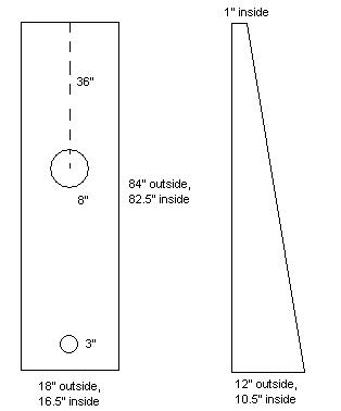

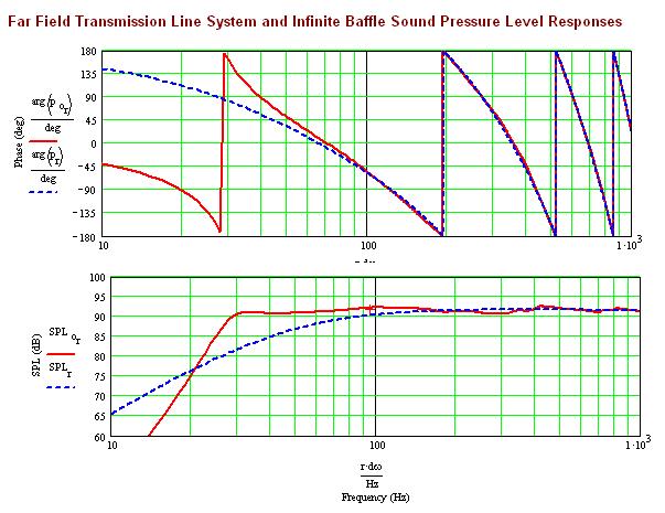

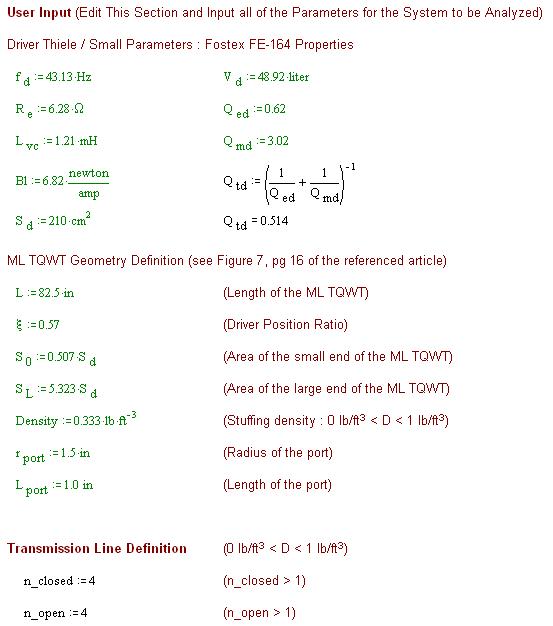

At this point, I think I'm going to go with this driver, an 8" Pioneer. I've also spent some time playing with Martin King's MathCad sheets and designing my enclosure. A rough sketch of the enclosure is in one of the attached files. Making a couple of assumptions (more on that later), I've come up with the inputs listed in the inputs file. These gave me the response, shown in the response file. My question is, does this look like it should work? I am also working on changing the layout of the enclosure so that the narrow side is the "front," and not the wide side. I know this reduces So, but it didn't really affect the modelled response, maybe even made it better.
Now, about those assumptions I made. Using the MathCad sheets, I left the section for Transmission Line Definition alone, leaving n_open and n_closed both equal to 4. What exactly do these values change, and should I do something with them? I also assumed that I could mount the driver on the vertical "front" of the triangle, rather than on the "side," as Martin did. Is this correct?
A few other things: How do you determine how much stuffing you need? The worksheet allows you to specify the density, and Martin's sketches/notes say "stuff the top only," but how much is the "top"? A certain percentage of the total height? From a bit below the driver? Also, is there anyway to model the higher frequency response of this driver in this type of enclosure? I'm not sure if this is really necessary. I do know that the driver is only rated up to 17kHz. Will that be enough, or should I look to add a tweeter to the cabinet?
