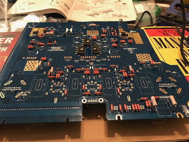

So thanks to the suggestions of the folks on here, I purchased and put together the Elekit 8600 in the past week, and I wanted to share my experience and a few photos. I'm totally new at this, so during my wait for the amp I researched and bought the following:
I selected the Lundhal option, and because it was the launch edition, I also got the Takman Resistors, and the Mundorf EVO Supreme caps (I can later upgrade those to the silver, gold oil). And selected the Genalex Tubeset.
The entire process took me about 20 hours from start to finish. I'd put the baby to sleep every night and sit on my bench and work until 11 at night or so, and it took 4 nights, plus a good 4 hours this Sunday to wrap it up.
Victor was endlessly patient and responsive to all my dumb questions, but it's working now and "burning in" initially, the sound is about 10 steps above my T-Amp, and can get pretty antisocial with my Fostex 206eN setup without even hitting the halfway mark on the volume pot.

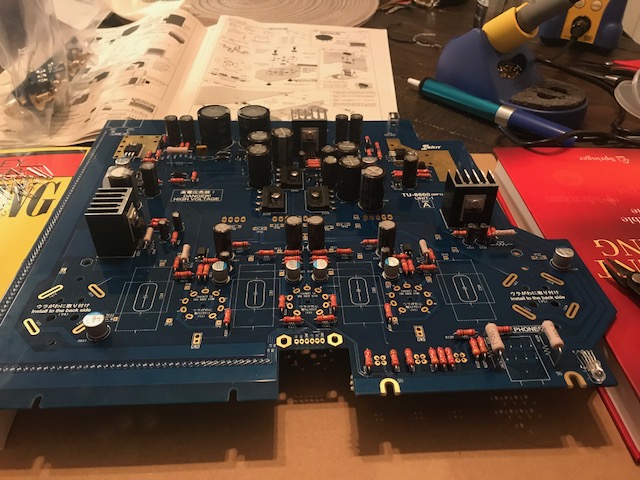

- Bless Victor for grouping the resistors according to their values and the instructions/steps - this made a big difference. I would pull out all resistors of one type, and bend them appropriately then place them in the board, flip, and solder in groups, it made it go a lot faster. For the Takman upgrade you have to bend them in a specific way, because they are slightly wider than the space for the standard resistors.
- The solder made all the difference. The unleaded solder (i bought a small practice board from Amazon to learn before I built the amp) needed higher temps and was harder to work with. Worth the price.

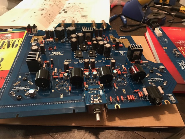

- You have to be careful but most of this stuff really isn't that delicate, and can take a fair amount of abuse - I was lucky and didn't have many mistakes to fix, but learning how to use the desoldering pump was a trip. You have to get REALLY close. On the final board review I found one capacitor with reversed polarity, and at one point i soldered the wrong power connector in the wrong spot.
- There's a separate PCB for the power items, plug, switch, fuse, etc. Make sure you find the one for your country.
- If you have the Lundhal upgrade and the upgraded Alps pot, look for the threads on this forum to see how to install. The volume pot needs a different approach with spacers to fit correctly
