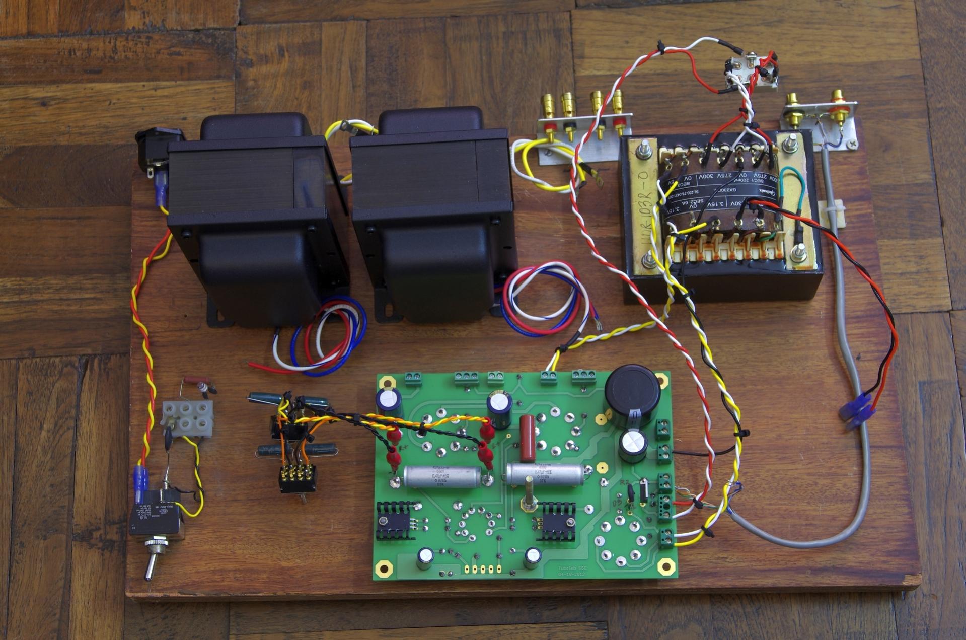

Hi Bill, great timing. I'm about to fire up my SSE as well.
Using a local mains transformer with dual secondary's - 275 and 300v. The board is wired in Triode and toggle switches for the cathode bias.
When I get it working, will wire the Triode /UL and SS/Valve rectifier switches.
The OPTs are Edcor CXSE25 and the PS has a 7H/220ma choke. I'm thinking of going with a 6P3S and 5U4g as the first tubes to test 🙂
Good luck with your build.

Thanks for your input! After tough negotiations I can put the SSE in the living quarters if the speakers are not too big so the Edcor GXSE15-5-8 could make sense and saves some budget to buy some nice drivers 😉.
After more reading I think I'd like to avoid the big Edcor and likes as the massive amount of iron may also cause some distortion. I've made an enquiry at a local company for an one electron ubt-2 clone with UL tap, see what they can do.
Also still considering toroids: this one looks like a nice fit: https://sklep.toroidy.pl/en_US/p/TTG-EL84SE-Tube-output-UL-transformer-5kOhm-EL84-6V6-SE/572 but can't find experiences with that in SSE or a comparison between toroid and EI core OPT's.
I'm aiming for a B+ of 450 V so I can use EL34, 6L6GC and KT88. Using a fixed resistor of 680 ohm and 680-3K3 in parallel with that results in an actual cathode resistance of 340-564 ohm, which seems to fit the simulations on Tubelab. Using a switch because I like options and exchanging tubes is then not equal to taking the amp apart.
Looks nice. Any sound already?
I received the parts today and soldered the first resistors. Hopefully after the weekend more progress.
Cheers, Bill
