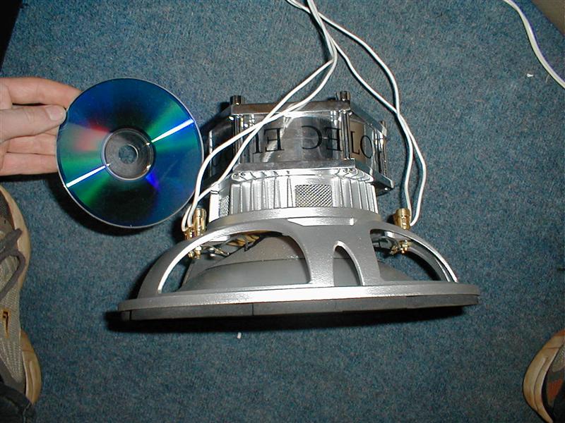

Here is a pic of the sub.
Sealed box construction
I would go for MDF (called supawood here) if you can, but otherwise you might have to use whatever you can get your hands on. Simple butt joints should do the trick and with some clamping you wouldn’t even need screws. Try and see whether you can get someone with a router to do the driver cut out for you. If at all possible, try and get the wood cut for you. Remember that we are talking about 75l internal and you can use dimensions to best suit the applications and even at 60l with moderate stuffing you might still be ok, but less than that is not any good. Because this is a sub the dimensions can even be equal. Don’t forget to brace the box and to leave room for the driver’s magnet assembly. You can make a sealed box “appear” larger to the driver by stuffing it with some pillow stuffing or similar, but at the moment the budget might be a little strained as is so don’t go overboard. Obviously the more stuffing the larger the box will appear but the mains will be marginal.
If you have questions about building the box you may gladly shoot them to me using the email button below.
