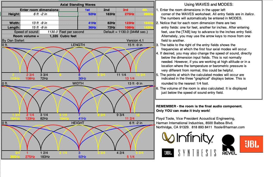

Here is the thing... that room dominates low frequency response, by that I mean the room will create a complex pattern of nodes(peaks and troughs) in the response that are determined by the dimensions of the room and the subs position in it. So.. symetrical positioning of two subs rarely produces the smoothest response. in fact one of the benefits of multiple subs is using them to smooth out in room response by positioning them in non symetrical positions. That usually means one sub along the front wall and one along a side wall somewhere, the exact location of those is something that has to be determined through experimentation.
@conanski It's a refit of an existing room, so the depth will be 5m, the width between 3.8m&4.2m and height about 2.3m ( Atmos heights into ceiling ). Screen is 3.2m wide.
I can use the harmon room mode calculator to determine the position of the Sub in the room based upon standing waves.
However, that's another subject ( very important ) that isn't what I'm asking about here. What I want to know here is if my assumption of keeping the volume of this sub the same but changing the dimensions a bit, will it be ok ?

This is the room modes for my room. If this assists in placement. This is from the Room Mode Calculator from Harmon.
