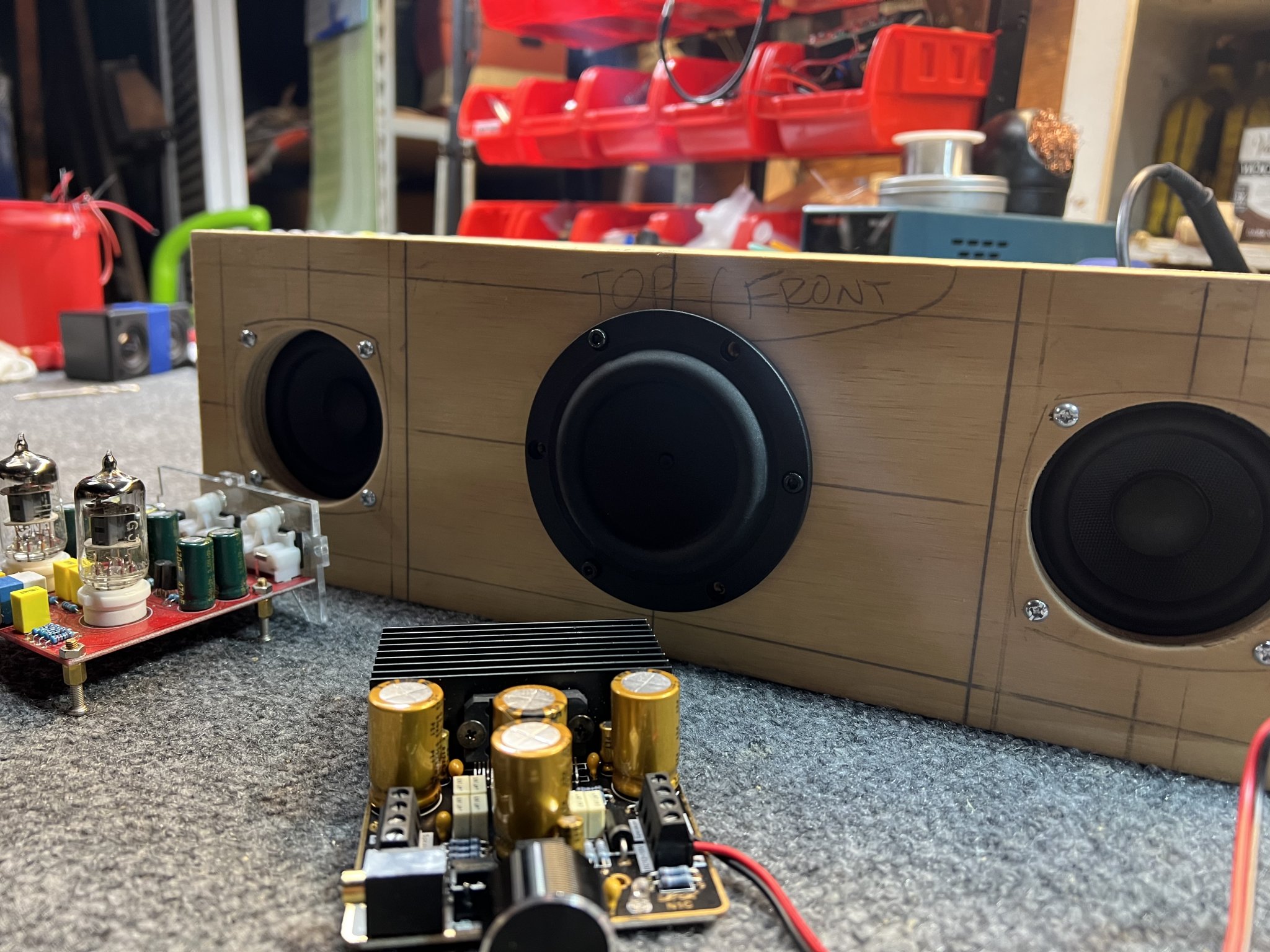

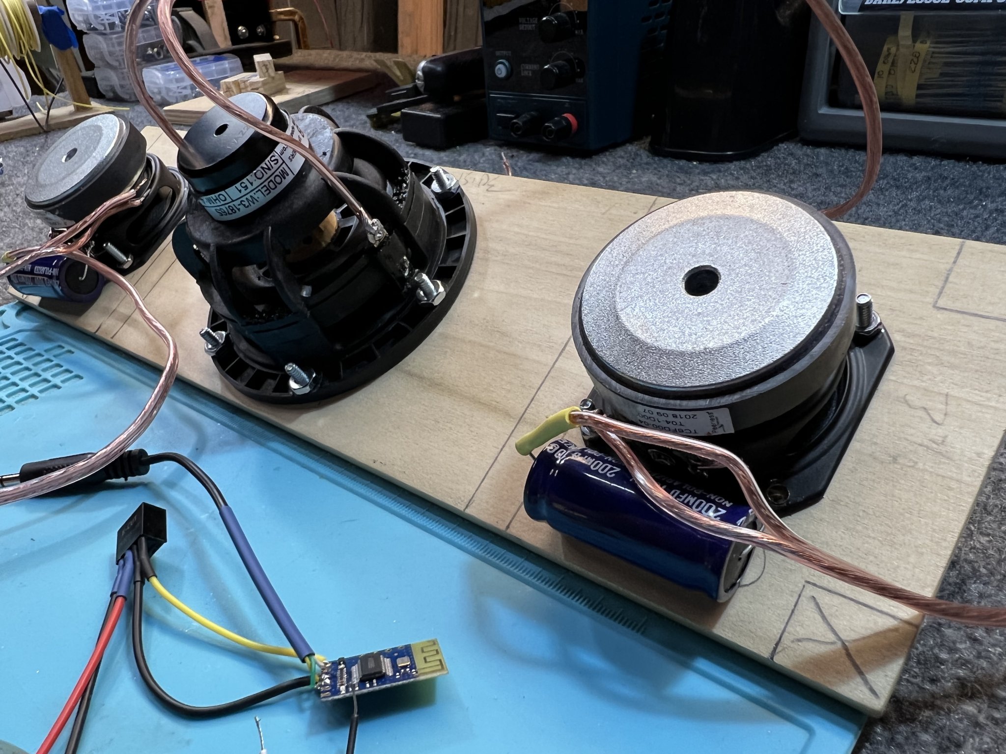

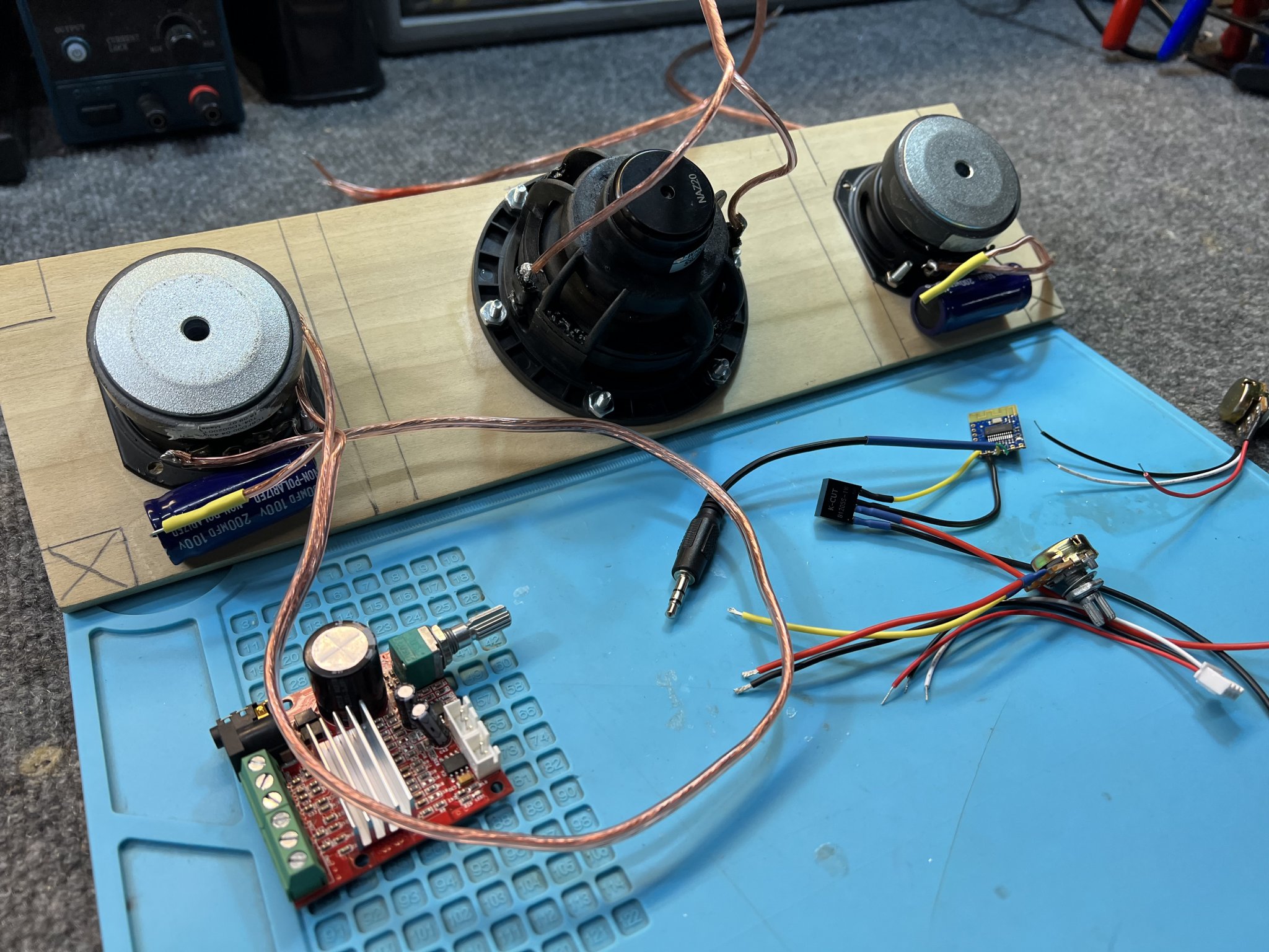

Oh yeah, my current build. It’s a 2.1 channel desktop system. I’ve recently been fascinated by these tiny, 3” and 4” subwoofers. In particular, the Tang Band W3-1876S - a tiny 3” subwoofer that’s generated a ton of great reviews. And while the YouTube “Hexibase” stuff is totally impressive, I wanted to see how it sounded in a small 2.1-channel desktop build…not to mention, I don’t have a 3D printer!
Anyway, I was reluctant to drop $50 bucks, but I picked up a rare used, unopened one on eBay for $22 bucks shipped. Woot!

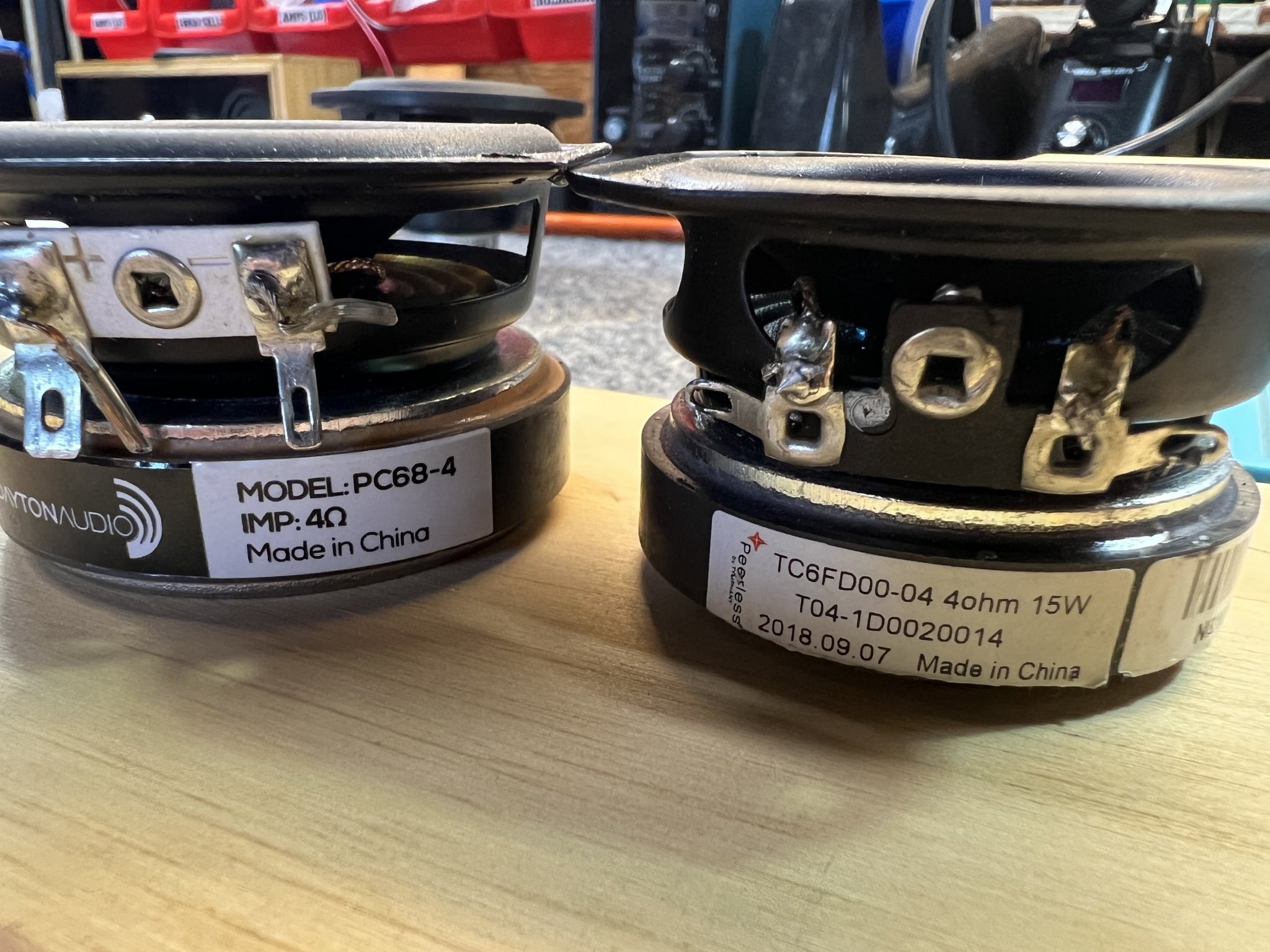

A pair of 2” inch Peerless TC6FD-00-04 full-rangers rounds out the speakers. I’m testing them with a 200uf capacitor to cut out anything lower than about 200hz.
* I actually cut a different baffle/front panel to test the 3” inch Dayton Audio 3” Poly full-rangers. They sounded much fuller in the midrange, but they had nowhere near the treble and HF response as the Peerless.
I’m currently in pre-fab/testing mode; mostly because I’ve got a ton of free lumber at my disposal, but also because I just prefer listening instead of modeling! I’ve tried a few inexpensive 2.1-channel class-d amp boards, like the TPA3116D2 and the dual PAM8610-based amp from Parts Express. So far, the cheaper PE amp board is in the lead. Tons of output for a TINY little board, especially at a measly 12 volts, AND it’s got an external pot for the sub volume.
I’ll do my best to follow-up with the progress!

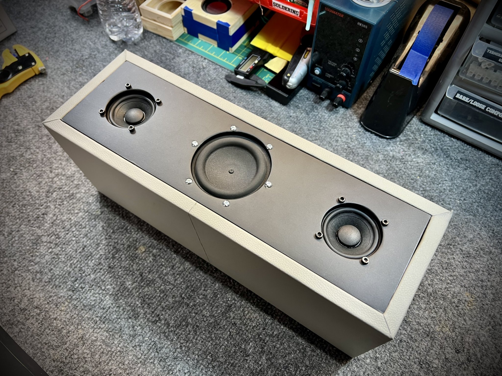

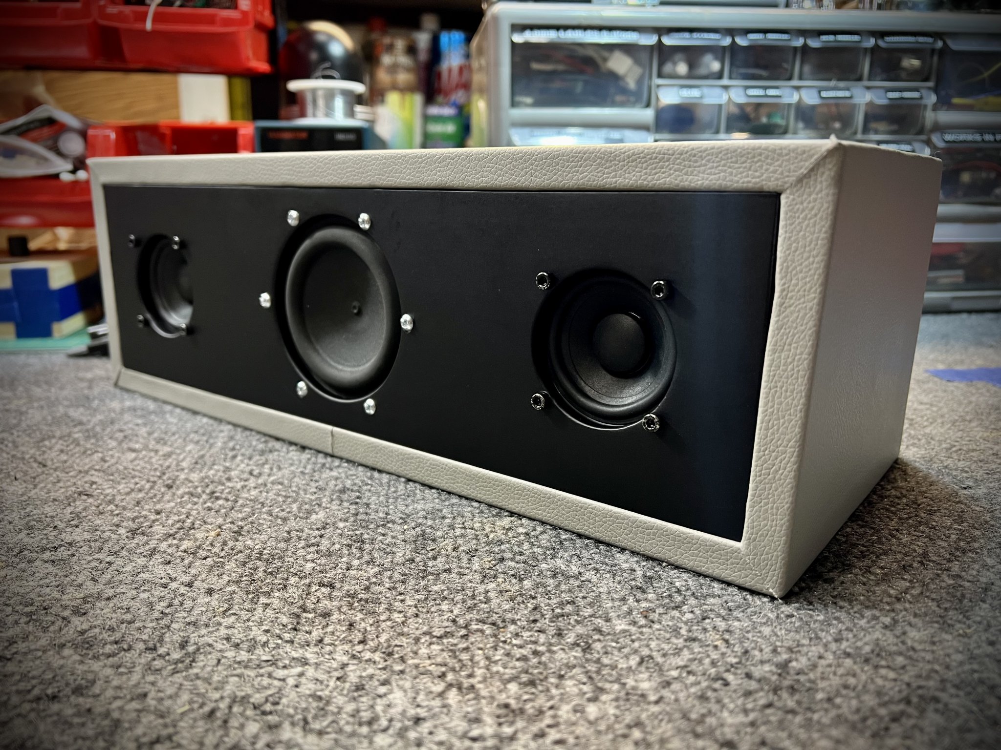

Quick update on my current project; 2.1 channel “executive” Bluetooth speaker.
Finally found some time tonight to wrap the frame in grey tolex, mounted and sealed the drivers/subwoofer. Vinyl-wrapped the baffle in matte black, and then I ran out of matching black cap head screws! I’ll have to swap those silver bolts out asap.
