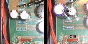

As a matter of course I would like to check the capacitors to see if there are any obvious signs of a bad capacitor. Can this be done with the capacitors installed in the amps circuit board? or do they need to be removed? I have read conflicting info about this...if someone can point me in the right direction I would appreciate it. I assume I am testing for resistance. All I have is a standard Craftsman digital multimeter on hand. Thanks.
Not sure if this was mentioned yet or not:
C4 and C5 look to have quite long leads,and it appears that C4 is right next to the AC power wiring?
I would suggest trimming the leads a bit,and getting them a bit closer to the board,and away from the AC wiring. It could be picking up hum and injecting it right into a tube's grid.

Yes...this was mentioned a few times. Whether or not it was an issue, I wasn't sure. I thought the extended leads might also add more resistance to the circuit (more on this later).
At any rate, I was checking the resistance of the capacitors in the amp today (I had read that they should pretty much read infinite and I should see the resistance continue to increase as the caps charged if I had my multimeter connected to them in the correct polarity and they were not leaking) this only seemed to work partly in theory with the caps still mounted on the circuit board, as the longer I tested them the slower the seemed to charge, and they never seemed to charge as fast as some of the new caps I tested that had not been installed.
As I sat scratching my head and trying to think of what to do next, I decided that I might give shortening the leads on the C4 and C5 caps a shot. While I was at it, I used Ty's response to my questions about these earlier as a guide to reinstall them with the correct polarity.
Ahhh...the putrid stench of fried resistor. Don't ask me what happened. I shortened the leads and set the caps back in place having to only reverse the polarity of one of them (C5).
The first time I powered the amp up I didn't know what to make of it. The sound through the speaker was sort of like an oscillating distortion of some sort. Almost sounded like a flag waving in the wind. I shut it down quick and took a look at the board and caps to see if anything obvious looked wrong.
I decided to put C5 back to how it had been installed, rechecked everything visually and tried firing the amp again.
Same thing happened. I listened for a second too long, the second time. R14 on the board is fried. I'm not sure what happened. I thought that maybe some solder I lost track of might have shorted something out, I can't find anything obvious. Right now I'm on my way to Radioshack to see if I can come up with a 390 1/2 watt replacement.

I'm still extremely suspicious of the power supply caps (C8 and C9). The original hum, now the motorboat symptoms all seem to point towards it. Were C8 and/or C9 ever replaced?

I'm now back to square one. I tested R14 before moving forward, and remarkably it still showed the correct resistance. I did manage to get replacements, but decided to leave it for now. I cleaned down the board with some alcohol and a toothbrush so I could see everything more clearly. As I was working on it, I noticed a small blob of solder seemed to wash out from under one of the tube sockets. It was in close proximity to where I had been working on one of the caps and must have migrated off the backside of the iron without my noticing it.
P.S. C9 was the cap that was replaced because it was not up to spec according to the manufacturers schematic.
So now I have the same wonderful humming amp as before...except with shortened leads on the filtering caps. Yippie!

chromenuts said:I decided to start with something I understand. I have made a spreadsheet that includes all of the specifications for the resistors in the amp circuit as defined in the schematic and the actual measurements that I was able to make on both amps.
Comments:
Even though its less than a 2% difference, why is the resistance on R8 that much higher?
What is up with R13 in both amps? It calls for a 3.3k 1/2 watt, but measures only .09k!
R14 and R15... appear to actually be 2 watt rated... I guess that leaves me to change out the pair in the good amp at some point? (right now, if it ain't broke don't fix it).
R16. This was strange. While taking the measurement, the resistance increased very gradually...
R18 and R19. Measured the same in both amps. Only around 50 ohms as opposed to 100 that it calls for in the schematic.
P.S. R20, although noted in the schematic, was nowhere to be found on the board. After studying the schematic more I thought that it appeared the resistor was associated with the only LED that is present in the amp.
