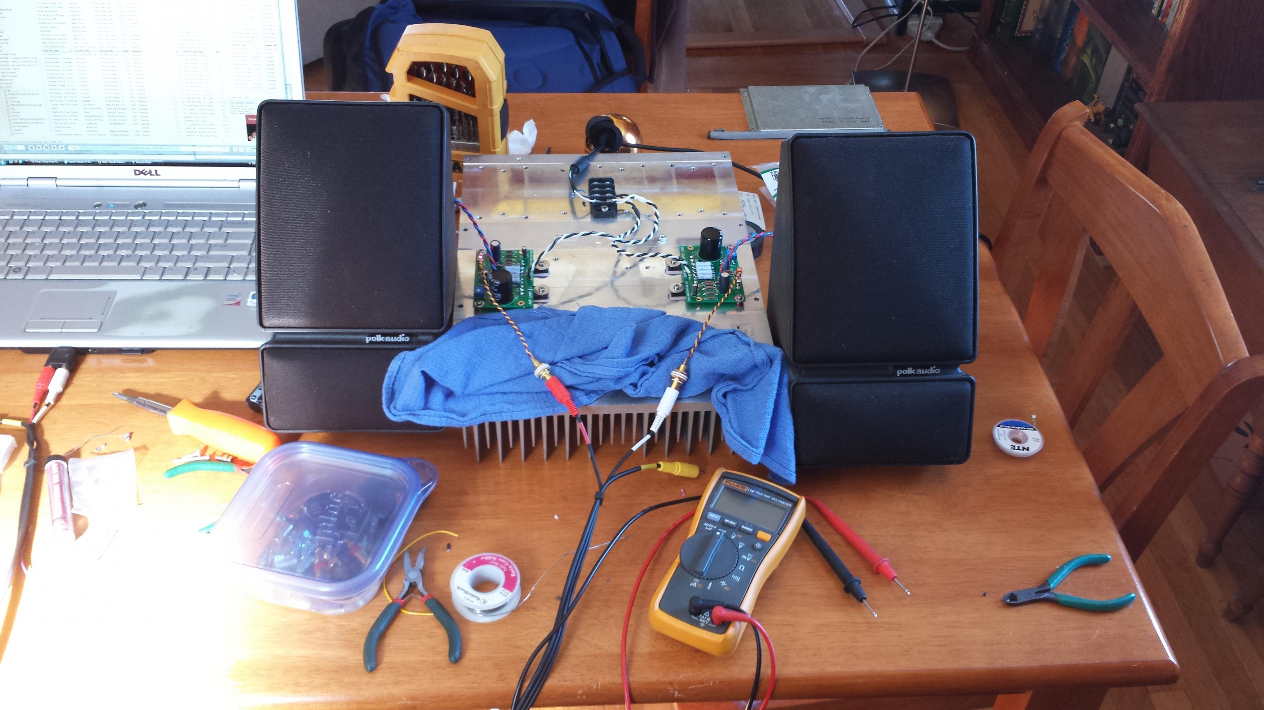

Well,I finally finished assembly and testing. I gave up trying to make a power supply for now out of a 17v/5a transformer I had on hand. I was worried the 24vdc it was rectifying to was to high, and since my oscilloscope is questionable, and I don't have enough experience to just wing it on the power supply end of things. So I found a spare 19vdc 4.62a Dell laptop psu. Sounds good so far too my abused ears (a few too many Pantera concerts in my younger years!), I'm also pleasantly surprised at the output, especially with the 89db speakers I had on hand.
I'm tossing around the idea of making it into a media dock/charging station for my cell phone. There are several, basic docks on Amazon that I could reverse engineer right into the enclosure I'm going to build.
