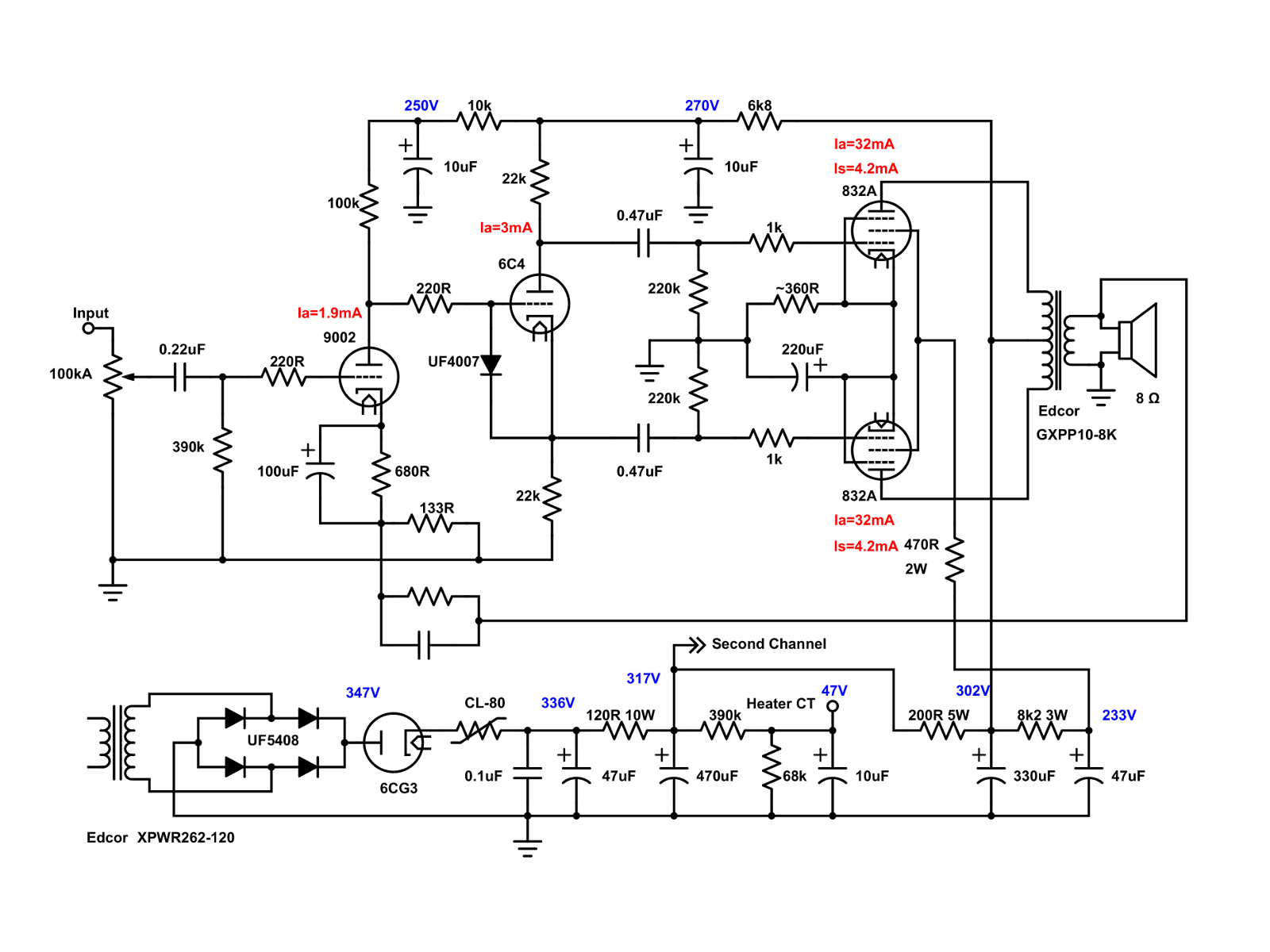

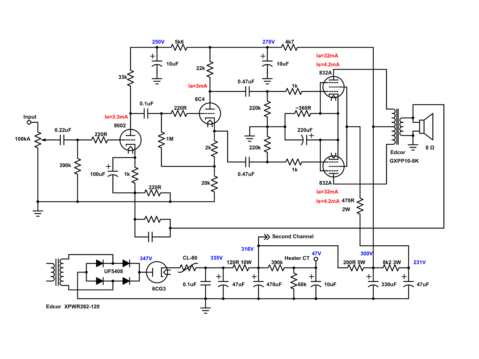

This is my third foray into the world of hi-fi-ish amplifiers, the first two being simple single ended affairs. I've collected a handful of 832A and GU32 tubes and really like the look of them. I plan to run them cathode biased to keep things simple. According to the RCA datasheet, the grid resistors should not exceed 50k per section, but I have seen audio designs as high as 390k. What do you guys think about this?
For the front end, I want to use the 9002 tube with a 6C4 phase splitter. I came up with 2 options.
AC coupled:

and DC coupled:

For the AC coupled design, I think I picked a pretty reasonable operating point for the 9002 tube, but then there's that 0.1uF coupling cap. However, I got that 0.22uF cap coming off of the wiper of the potentiometer. I've seen opinions stating that the 0.22uF cap is unnecessary, and I've also read that it's good to keep DC off of the pot to prolong it's life. What do you guys think?
For the DC coupled design, the operating point of the 9002 tube is kind of wonky, I think. Also, will the protection diode on the 6C4 be necessary as I have the 6CG3 diode in the power supply providing a slow start-up?
I have absolutely no reason for the 6CG3 diode except to drop a few volts and to increase the tube count. I have plenty of filament current available so why not? More tubes = more better, right?😀
Thank you all for your time.

The protection diode is going to cause problems.
? Merlin says it's "obligatory".

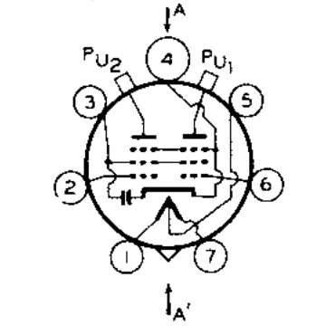

A bypass cap on the output tube screens to cathodes is a good idea.
I never seen a schematic with the screen of the output tube bypassed to the cathode, only signal pentodes. I'd always thought the filtering cap in the power supply took care of that. Interesting thing is that according to RCA's datasheet, there is a capacitor between the screen and cathode.
attachment.php
I measured the tubes that I have, and the capacitance is around 30-40 pF. I assume it's related to it's role as a high frequency tube.
