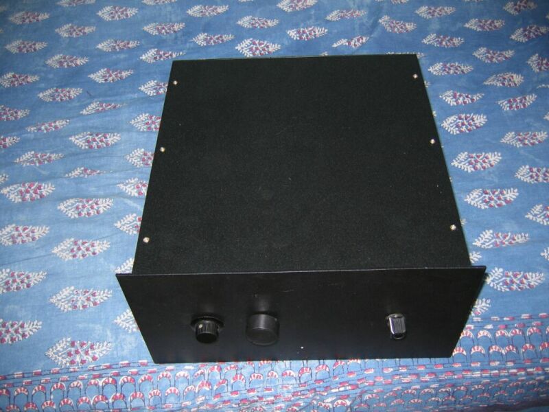

Hey all,
I am glad to report that i have finally finished my gainclone projkect customised for my 3 way active speakers.
Taken me 9 months to finish this.
In fact this is a
DIY 7 channel Gainclone amplifier/Active crossover/Passive Preamp
The components in the different stages are...
Passive Pre Stage
ALPS RK-27 Pot(10 k log Dual Gang)
Phillips Log pot(Center cahnnel)
Active Crossover Stage(From Silicon CHip)
OPA4228 based 4th order Linkwitz Riley
Amplifier Stage
[ Highs - 50watts@8ohms ]-LM3886(Bran GT's board)
[ Mids - 60watts@8ohms ]-LM4780 Parallel mode(Peter's Board)
[ Lows - 140watts@8ohms ]-LM4780 Bridged mode(Arasu's Board)
[ Center channel - 60watts@8 ohms]-OPA541
Thanks to everyone who heped me realise this project...specially Nappylady, Arasuk and Peter Daniel.
Thanks to Arasuk for helping me out and see the project to its completion.

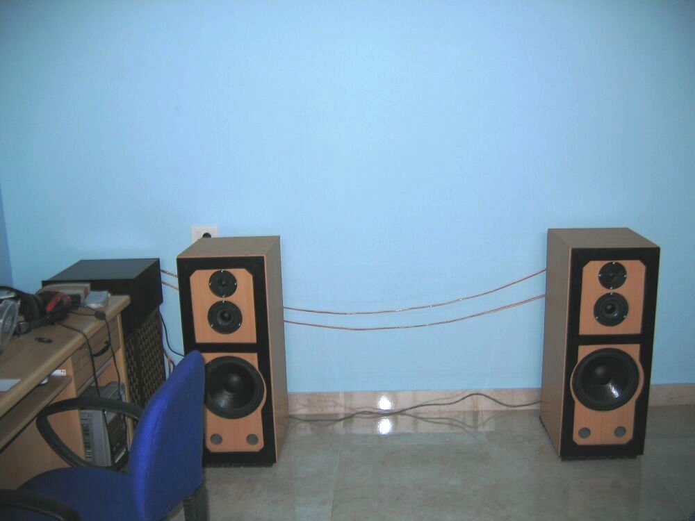

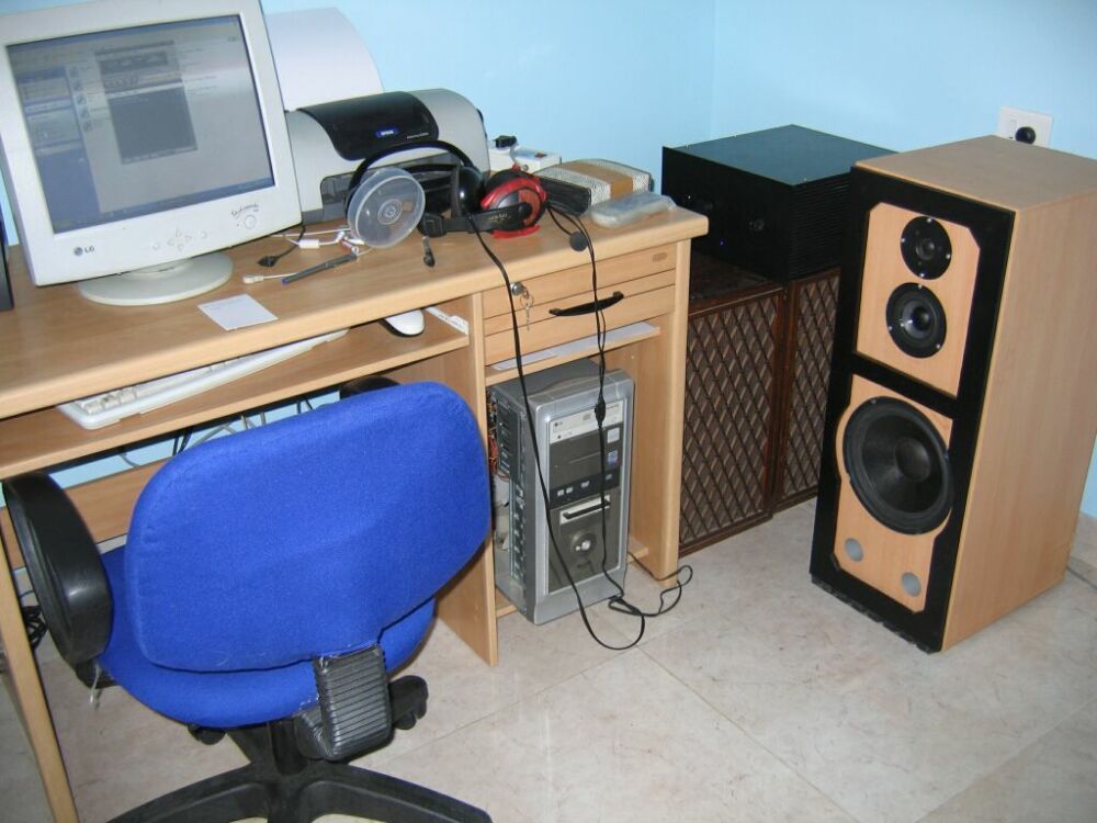

With my Active 3 Ways...am a noob to speaker designing too:D
gonna put it in my listening room once i com back ...leaving to Mysore in an hour..will be back only next weekend.
Active 3 way speaker
Vifa D27TG-35 (Tweeter)
Scan SPeak 13M/8640(Mids)
Dayton 10 inch Classic(woofer)

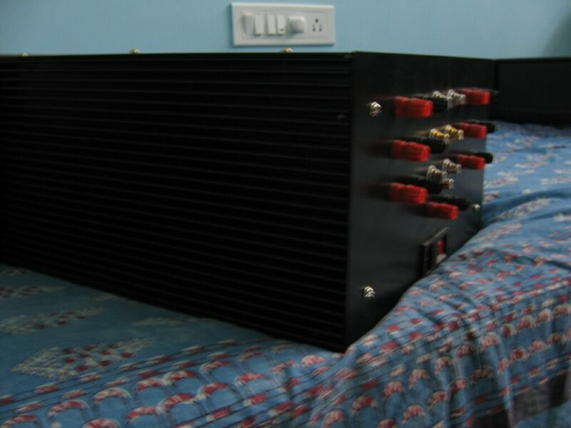

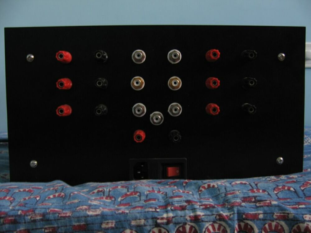

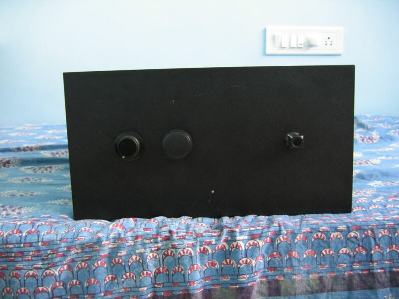

As promised...here are the pics of the inside...bear in mind that there are two passive crossovers, 3 transformers, 7 amplifier modules, input selector, and a 3 way stereo active crossover in this one case and me being a noob i kinda feel that its a pretty good job of wiring.
Am sure my future amps would be better laid out..
