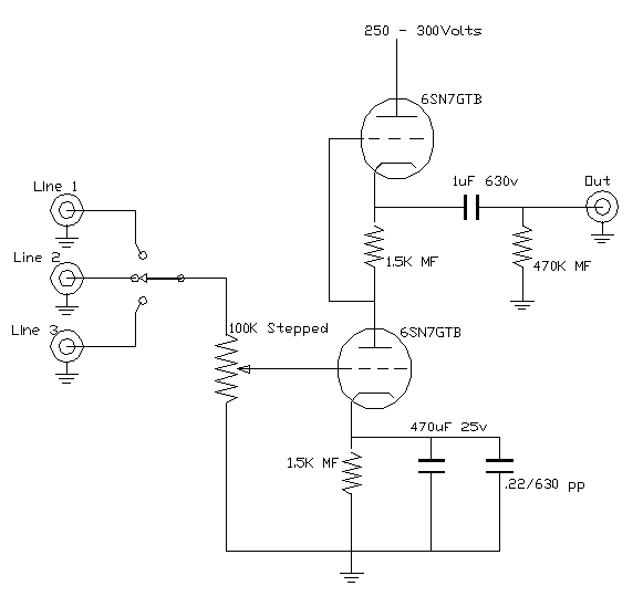

Valve Preamp
Hi Nuuk, IJHill,
I'm in the same boat in terms of planning for a tube preamp. I am currently finishing Rod Elliots P3a amp & P88 preamp.......possibly more candidates for the ugly but sounds good thread elsewhere on the site.😉
Frank posted this schematic last year on a similar thread & I've decided that it will be my introduction into tubes. I just have to finalise the other projects first or the wife will kill me.....
Maplins offer a slightly larger valve transformer than the one suggested above for £35 350V max, 250 mA max (not both at the same time) & 6.3V 7A max (Code DM54J). Probably not the cheapest, but you may be like me & have easier access to Maplins than anywhere else. The guys here can advise if it is overkill.
6SN7GT are a fiver there also for starters, NOS/more expensive tubes can always be substituted at a later date

12B4A common cathode, resistive loaded
(sorry no sketch)
Rl = 10k
Rk = 520
B+ = 300V
Vg = - 11.9V
Ia = 19.8 mA
Rk unbypassed:
Zout = 3k3
Gain = 4.7 or 13.5 dB
Rk bypassed
C bypass = 100uF for F(-3dB) of 1Hz. Scale to preference
Zout = 1024
Gain = 5.7 or 15dB
Scale output cap to whatever is required for the input Z of your poweramp. If the PA Zin is high, I'd leave the cathode unbypassed. Dc filaments shouldn't be neccessary, but can sometimes make it quieter.

FOREPLAY
It is indeed an anode follower followed by that cathode follower everyone hates so much.
And guess what, it's still very hard to beat for the money.

Nuuk said:If I have been 'listening' carefully, I understand that by changing the output cap, I can alter the output impedance.
You have not been listening carefully! 😉 The output cap controls the frequency response, not the Zo. If the next unit's input is a high impedance, then a small cap is fine. If you are trying to drive a very low impedance, such as headphones, then a very large cap - on the order of hundreds of uF is needed.
Hello Nick,
As you don't need any gain - just drive to your 20k amp, I'd suggest nothing more than a cathode follower.
Also, as this project is about having fun and getting started with valves, I'm going to suggest a slightly unusual power supply.
I'm thinking 12sn7gt (much cheaper than 6SN7) cathode follower, run at 210V (we'll see why that number is important) and 4.7mA.
4.7mA is a bit lowish for SN7, but you can use a constant current diode in the cathode for this (CFs like a high impedance below) this will also auto-bias your valve. Super simple.
You then need a 2uF or higher coupling cap (to push the LF -3db point to about 4Hz or lower).
Now, power supply - Maplins (or other) 230V isolation transformer with heater winding. Cap bridge and small maplins choke will give you about 330V.
Here's the cool bit - you use 2 VR105 regulators in series to get you 210V - they look cool (colourful gas discharge) and keep the supply fairly clean. Also easy to use - don't need a heater or anything.

Re: Valve pre-amp
Nope. Not even close! The gain of the bottom tube sets the limit in that circuit. You'd be lucky to get 50 out of it.
bournville said:...so theoretically an ECC83 would have a gain of 10,000 and an ECC81 3,600.
CV said:As you don't need any gain - just drive to your 20k amp, I'd suggest nothing more than a cathode follower.
Then what is the point? A CD player already has a low output impedence, so adding a CF circuit onto the end of it will just add noise, and lower your signal voltage by .9 or so.
Into what load? This is all dependent on the load. My 3db down point will not be 4Hz into a 100 ohm load.

output impedance of a few hundred ohms or less, then CL must be prohibitively
large (and electrolytic) to couple such a low output impedance down to 15
or 20Hz. Thus, the primary limitations on output impedance will be the size,
cost, and quality of CL. Also, charging and discharging such a high-value
capacitor through the typical grid resistor of the following rube takes a
long time.
