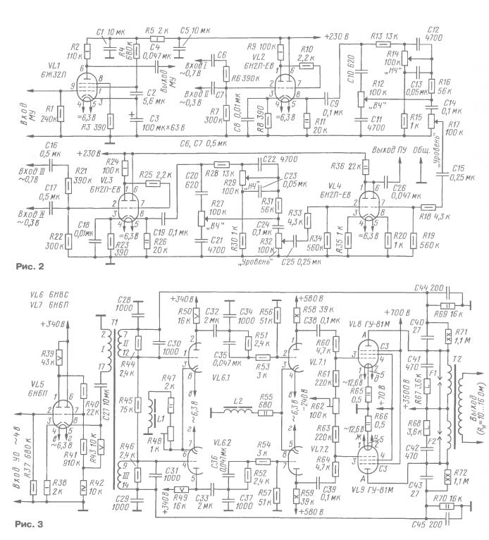

500W is indeed too small amount of power for so ambitious project.
1200W push-pull GU81M amplifier based on Russian UPV-1.25 is exactly what thread author should be looking for.
Amp is very stylish, small and compact, weighting only 200 Kg (441 lbs), easy transportable with a truck.
Additionally, it could serve as green energy saver for a house ("dacha") on the outskirts of Siberia during long and cold winter.
Full article can be found in Rusian magazine called "Radio", year 2007, Nr 4 (April). Use Google translate if necessary.

"1200W push-pull GU81M amplifier based on Russian UPV-1.25 is exactly what thread author should be looking for.
Amp is very stylish, small and compact, weighting only 200 Kg (441 lbs), easy transportable with a truck."
3500V B+, 441 lbs, truck
Ummm, no comment needed I think. Just reinforce the flooring and provide a garage door for the truck.

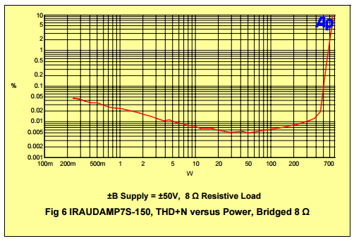

Does "Class T" still exist as current production parts? I thought that was mostly just marketing-speak by Tripath, and 100% of Tripath parts were discontinued after their acquisition by, iirc, Cirrus. There are still 'new' chips on the market, but they are copies of copies of copies, and as a result their sound quality and durability fall short of the genuine, long-out-of-production article.
At any rate, "class D" is really just a matter of building amplifiers using techniques similar to switching power supplies (rather than techniques similar to linear power supplies). It's not really "digital" (though power DACs exist). "Class T" was just "class D" plus Tripath's special sauce. Which did sound pretty good.
The attached graph is entirely representative of the distortion you should expect from any class-D (or T) amplifier. This one in particular is for International Rectifier's reference design, bridgeable "up to" 1000w RMS into 8 ohms. As you can see, it's real good up until about 400w. And this is into a resistive load, which means that this graph is extremely optimistic.
You'll see the same kind of hockey stick (or no thd vs. power graph at all) in any class-D datasheet. For example, the 20-ish watt rated TA2021 from tripath is way clean up to about 7 and a half watts.
The good news is that since we don't listen to sine waves, your actual music power output will rarely be in the right-hand side of the graph.

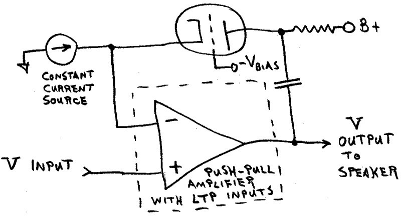

"Obviously there is some range between 10lbs-400lbs but the weights get out of control much sooner than I'd expected."
One needs to include the weight of the power xfmr, inductors and chassis, besides the OT. A bass amp may tend a bit toward the heavy side besides.
That GU-81 Amp took 441 lbs for 1200 Watts, or about 2.72 Watts per pound. One can obviously do better weight-wise if that is a priority. That VTA M-125 Amp hit 34 lbs for 125 Watts, or 3.6 Watts per pound. It looks rather light in the inductor dept. though.
A switchmode power supply could shave off maybe 40% of the weight. And an OTL design might trim off another 20%. (more tubes and filament/heater power required though) (the OT for the tube amp in this case looks more like a current transformer, around 0.2 Ohm output Z instead of 8 Ohm)

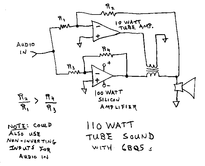

Another approach would be to start with a SS amplifier, and modify it to give tube sound. The attached diagram just replaces the global feedback attenuator of a SS amplifier with a triode in reverse. This means the output must equal the input signal times the tube Mu. (don't pull the tube out while its working though)
And a half way approach uses a tube amp to put the finishing touch onto the output of a SS amp. A Tube Veneer Amp so to speak. (2nd diagram) (the output xfmr for the tube amp looks more like a current transformer in this case, like 0.2 Ohm output Z, instead of 8 Ohm)
