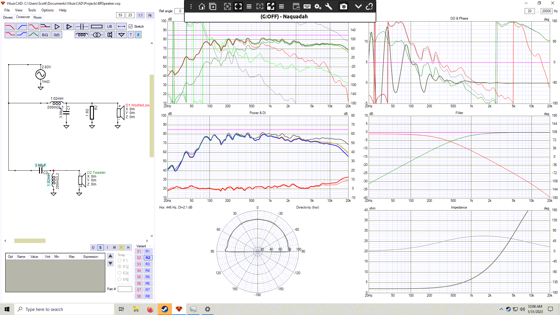

I agree that this is fundamentally science. But for the layman to pick up and build a speaker without a degree requires some shortcuts in the knowledge. Nevertheless, on ejp's advice, I did find a design that replaced the L-pad with a series resistors after the crossover that is a modest value that preserves a good response. 8 ohm filter impedance on both low pass and high pass, 2500hz crossover, and only the series resistor to ground after to attenuate the woofer. What did I screw up here:
Please tell us what the graphs are purporting to show.
And you do realize there is no such thing as a 1.06uF capacitor? And that for the same cutoff frequency you can use the same L and C values in both crossovers, just interchanged as to series and shunt?
And 'series resistor to ground' is a contradiction in terms. I thought you said you had a good background in electronics? Your 1-ohm SHUNT resistor will blow up the amplifier.
