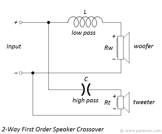

The way to reduce the overlap in frequency between mid/woofer and tweeter is by using a more advanced crossover circuit than just a capacitor in series with the tweeter.
Attached is the simplest form of crossover network that would do the job.

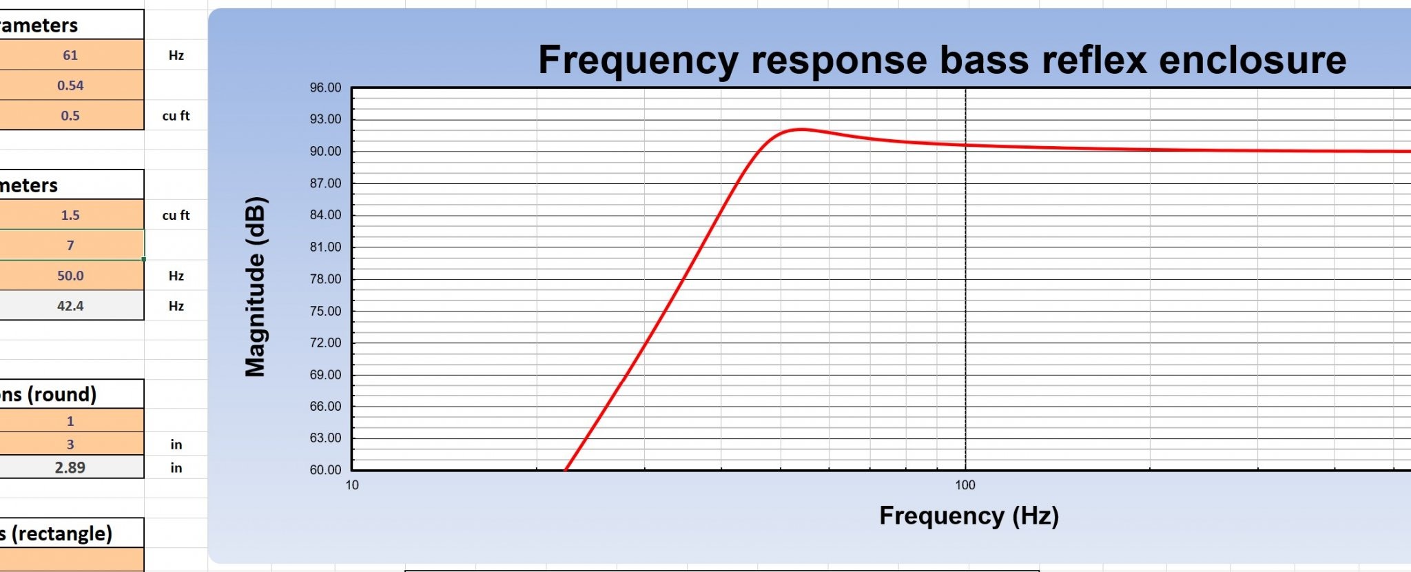

Without TS parameters you really are flying blind and any decision will be purely a guess. There is a lot of good advice above as far as general rules go but without the TS a small change can have a large affect on the freq response.
Here are 2 examples of a resp curve, one is with the midbass designed at 1 cubic feet and the other is 1.5 while both specs are "within manufacturer recommendations" there is an obvious advantage to the 1cuft design, the 1.5 cuft design has a big peak that you are going to have to try to get out with EQ or some kind of complicated notch filter.
Considering our time is valuable and building a nice enclosure can take a good bit of time, I would go to parts express and grab an overnight sensations kit. It has a good crossover network included and the drivers are decent. OR grab yourself a DATS and get some measurements but a DATS is like 130 bucks and a kit is 160 so unless you plan on building in the future the kit might be the most cost effective solution.
Regarding the open baffle aspect those can sound fantastic but a solid crossover design is critical AND the biggest issue is they need to be about 3 feet from a wall which kinda makes them hard to place in a room. In the images I included a set i built a while back and they were fantastic about 2.5 feet from wall but when i got them slide back to a position where they actually work in the room they sounded like garbage. So unless you can really place them in the correct location i would not advise that route. But GR Research on YT has a ton of information about open baffle designs, super bright guy.
Good Luck!

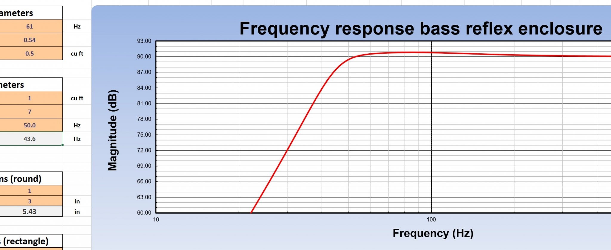

Here is a link to Audio Judgement's Box Modeler Excel Sheet. Edit the yellow fields... dont touch the bass reflex page https://docs.google.com/spreadsheet...ouid=113514127576244839082&rtpof=true&sd=true
Why not touch the bass reflex page? The woofers need a 0.32'cu. sealed 1101hz F0. OR 1'cu. ported for 53hz.
I'm shooting for an F0 of 70-80hz.,, need to build a ported enclosure (if I can figure out the port)

The don't touch is the bass reflex alignments page, its the tables page, its the page that has all the calculation tables in it. Use whichever design you would like. I personally prefer ported so using bass reflex is probably best imo.

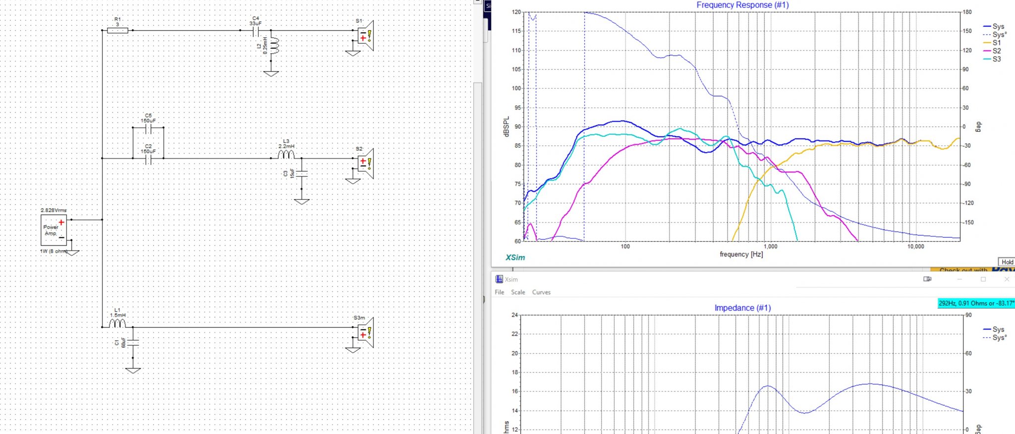

Here is a response curve for a 2.5 way that I am designing, you can see the crossover points in this for a 2.5 way. This still needs work, I have some peaks to sort out, but the crossover points are pretty close.
I really like this, thank you.
If you don't mind bearing with me picking your brain a little longer..
Did you design this crossover then buy the parts or did you get here through trial and error?
-If it's trial and error how are you testing? (ie are you soldering/unsoldering parts, afaik there is too much power for an adjustable bread board but too many small parts for alligator clips ).
And your specific design:
what is that middle C2 and C5 doing?
what is R1 doing?
Well, I don't have an anechoic chamber to test real world. So I design in XSIM order the components and assemble them. Then test far-field measurements in the room with REW and use Equalizer APO to adjust any room issues...If a big issue happened I would modify the crossover with trial and error but that has not happened yet to me.
C2 and C5 prevent the midbass from playing too low. I wired 2 150uf in series because a 300 is more expensive than 2 150s
r1 is a resistor and brings the tweeter amplitude down a little bit

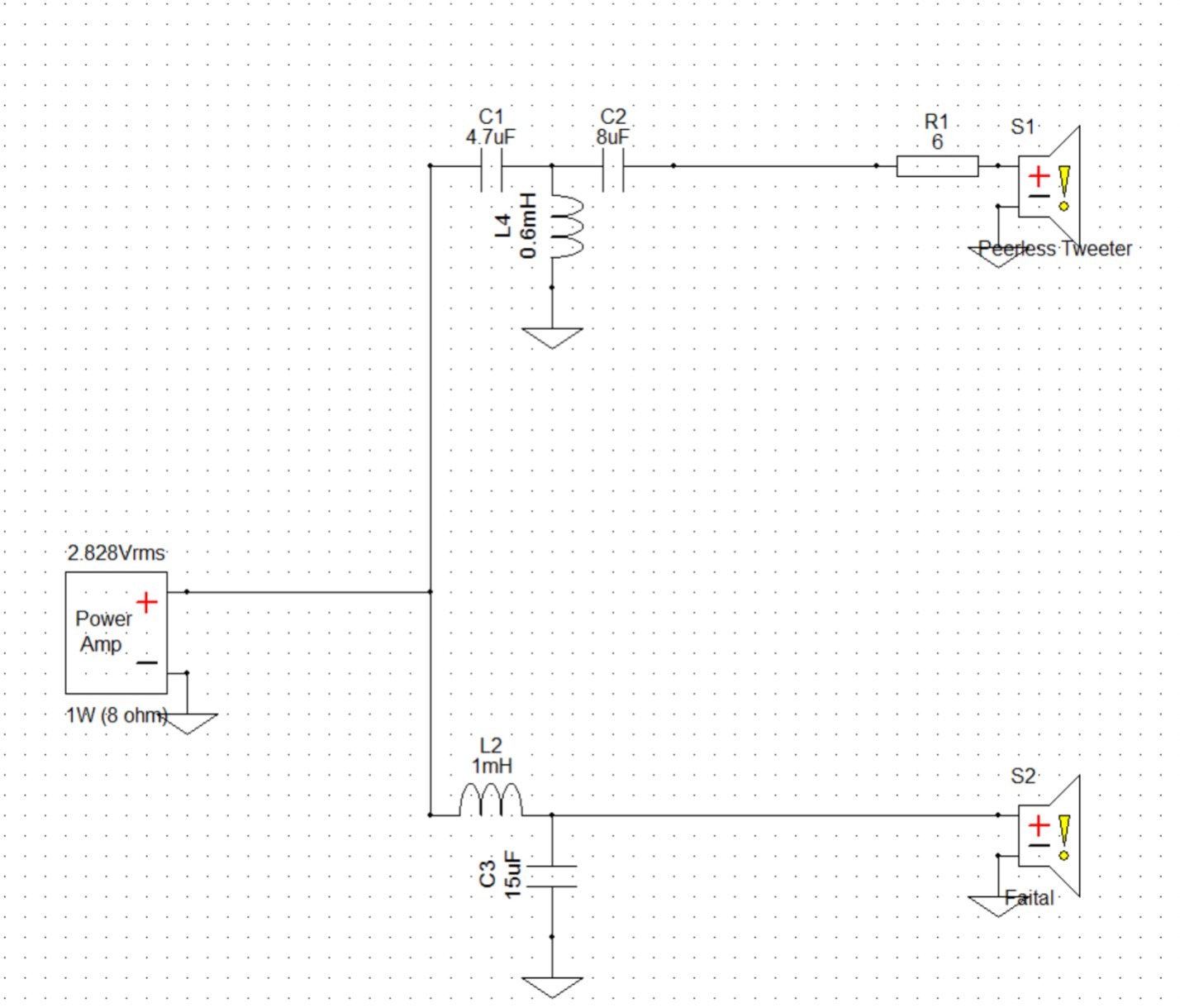

attached is shopping list for the setup, ignore the subwoofers. They are for my upcoming tower build. But im doing this exact setup for my living room... as a 2.5 way but you can omit the sub stage.
Reactions: wickette
