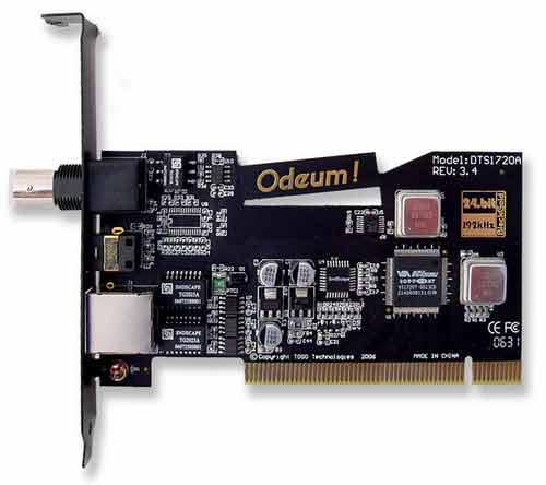

I meant the TG-Link interface, deuginthesky. 😀 I can't find any source device outside China having the TG-Link port.
Hey guys just found this thread - I too am looking for further info on the tg-link - any users yet or further info?
I'm interested in using it to get I2S out of PC & feed it directly into Panasonic SA-XR57 (internally)
Here's what I could find - looks like it's only for OEMs:
Translated from here http://www.sndscape.com/AccessoriesPage.asp?AccessoriesNameID=10#
TG-Link to I2S (Standard) Reference price: RMB ¥ 00
The digital audio frequency contact surface transformation mold is quick, transforms the TG-Link connection signal may directly link receives DAC, ADC or the Codec I2S audio frequency data and the I2C/SPI control connection installment, supports the digital audio frequency the input /, most greatly supports 24bit/192KHz, may directly install this module on the user board. This mold quickly is suitable for the SndScape series all sounds card. This mold quickly may help the customer fast development or the volume production TG-Link connection application product, also may use this mold quickly to promote the original audio equipment.

This mold quickly only aims at the OEM customer, not alone retails, any individual or organization if because studies, the research or develops the SndScape series periphery connection product use but to need the sample and the material, may write a lettermodule@sndscape.comto carry on the free application or the relation purchase.
