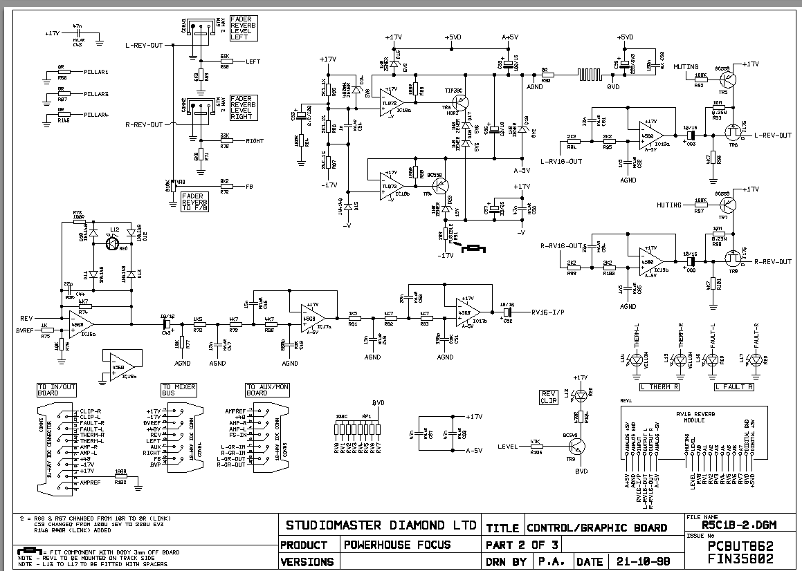

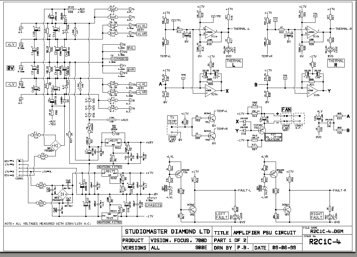

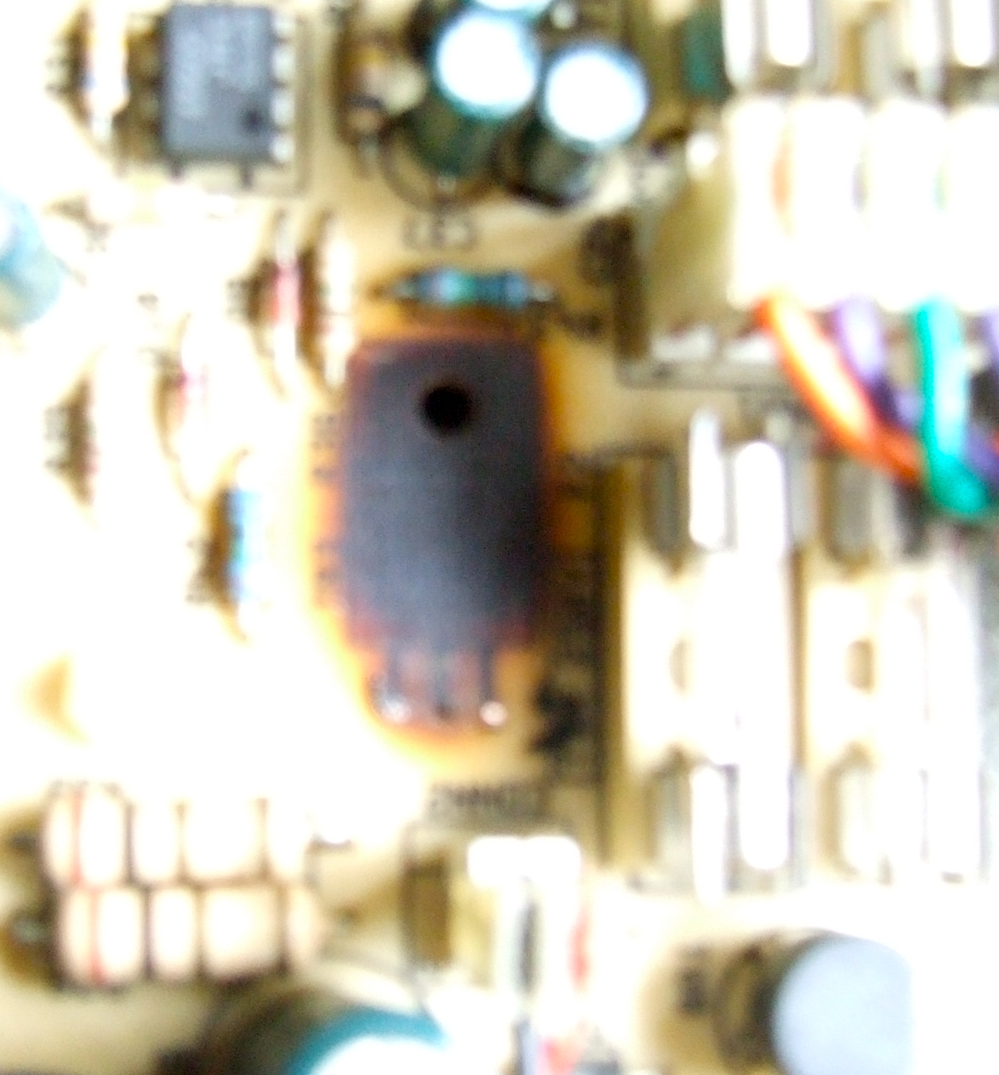

My first task is to repair a Studiomaster Vision 8 mixer/power amplifier.
I have opened it up and when I switched it on one resistor (R112) glowed red hot and burnt out. I renewed this and I also removed and tested a component which looked to have burned out. It was a transistor TP30C. I seem to have the correct test results on a multi meter.
I am new to repairing this type of thing and need all the help I can get.

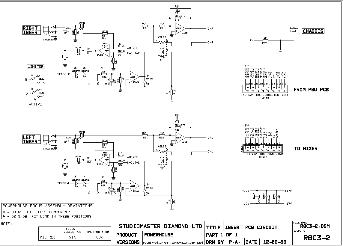

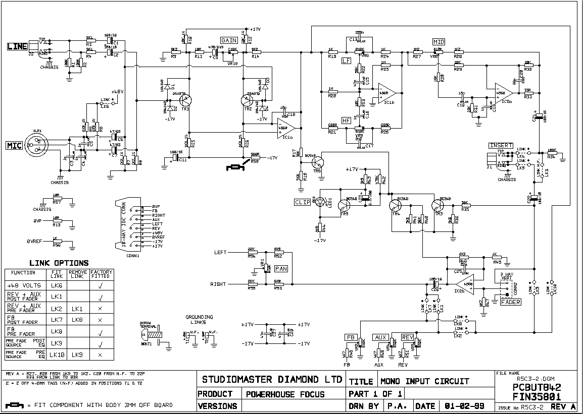

If you have a bigger pic of the schematic, that might help- the teensy one is difficult to read on my laptop screen and with ancient eyes. 😀

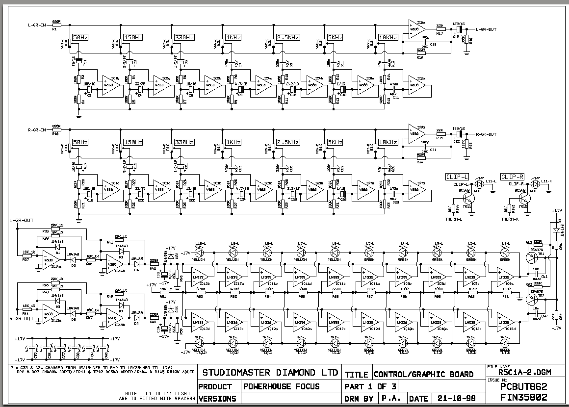

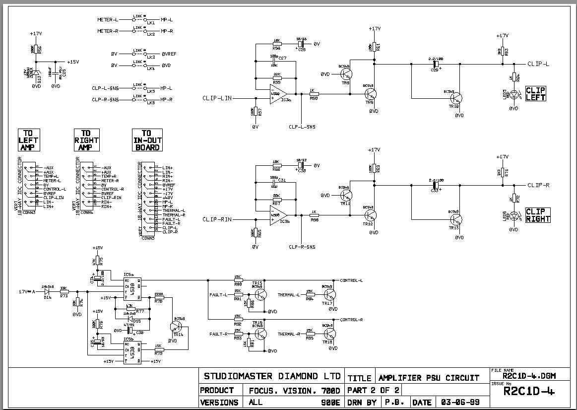

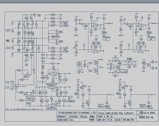

Hi SY, Thanks for the prompt reply.

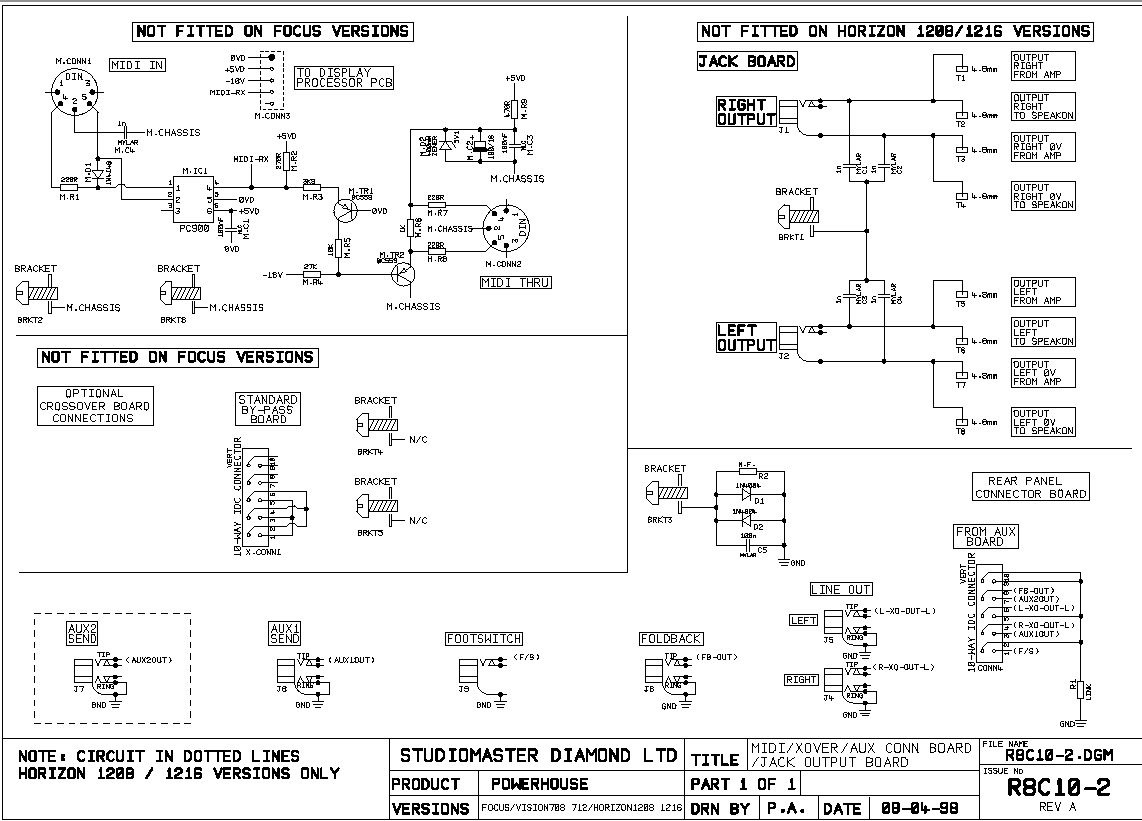

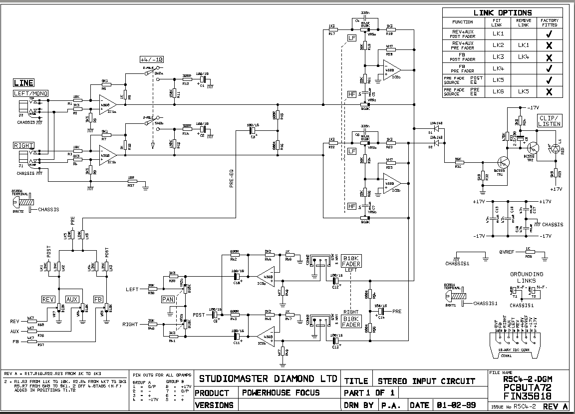

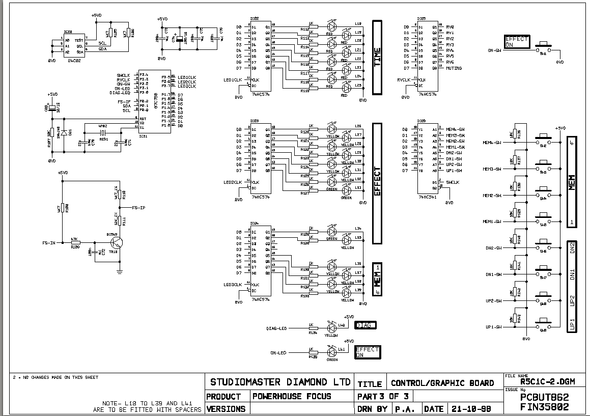

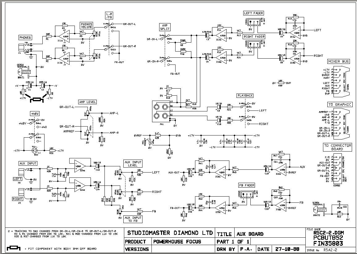

I've had to break the schematic down into pages to load it here, so here goes......

Welcome to the forum Dylan!!....Just an observation here. On your pix of the burn't transistor you found...the out of focus one.....A pointer, one of numerous you'll pick up on here. See how that transistor is laid down? That tab with the hole in it is supposed to have a heat-sink attached. In the commercial world, the easiest, fastest way to build things seems to be the norm.
The way "we" would tend to build things....that transistor would be soldered in upright, with a nice sized heat-sink......Just my 2C.

Hi Richard thanks for replying so fast.
I've tried to do just that by re soldering it in a semi upright position.
I have n't attached a heat sink hoping this will suffice......thanks for the input.....dylan.
