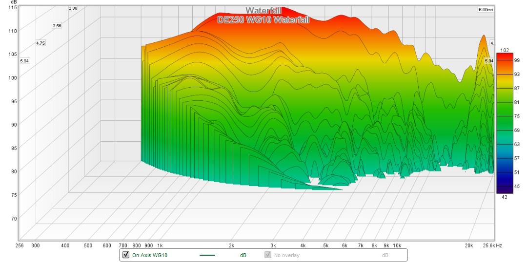

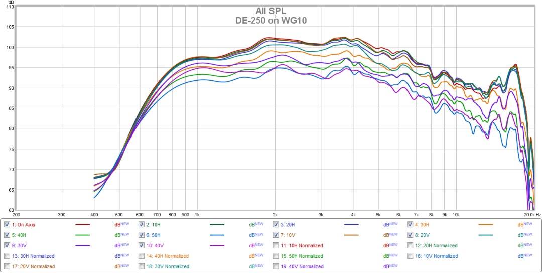

The Eminence has a taller vertical, so might hold lower. May not try to be so narrow to begin with which is harder to hold. Only guessing without measurements.
The measurements of the WG10 in post #13 look quite good, surprising low end pattern control, and uniform polar response, even outside it's nominal 70x60 rating.
It's "70" is wider than a lot of so called "90" for the top octave.

Not sure how eminence specs dispersion but these are like 45 degrees horizontal in the real world. You can see it in vbs 10.2. which I almost have completed. Never had a pa speaker that actually measures good so excited to hear these.
HF horn and waveguide coverage pattern is typically specified where the output is -6dB from on-axis, because when multiple horns are arrayed, the -6dB angle is where two horns will theoretically sum together to 0dB.
