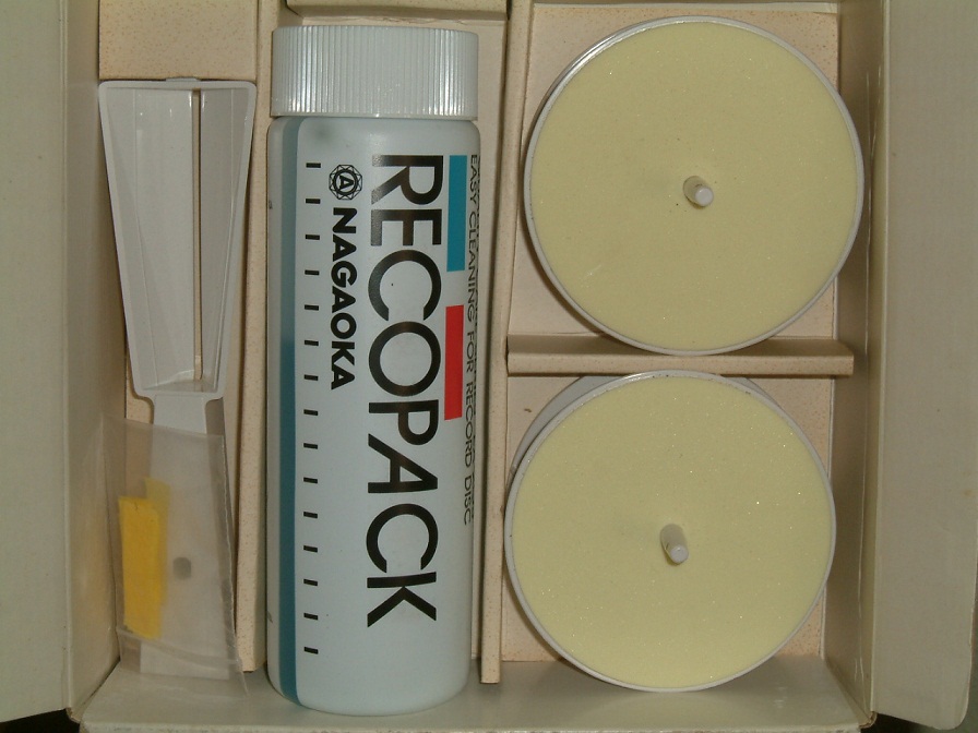

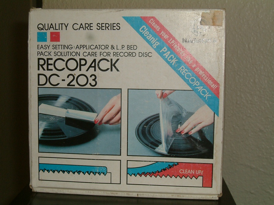

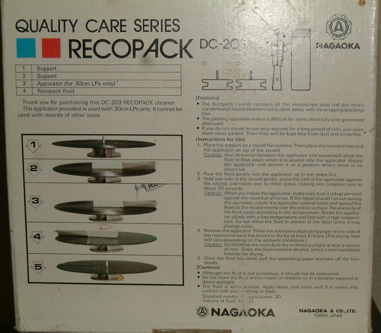

Yeah. Way back in the eighties I used a similar product by Nagaoka (I later found the same product under another brand, maybe no-name). Same colour, too. I bet these design engineers were actually "engineering in reverse".
