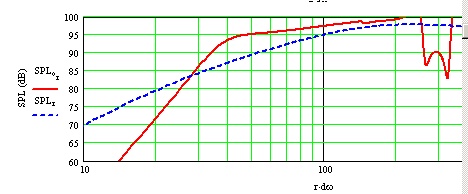

Henkjan,
I get the same type of results when I compare the old worksheets (dated 12/03) with the new ones. This is caused by a change in the damping correlation for very lightly stuffed pipes. A few years ago I found my original fiber damping correlation could be improved and that for an empty TL it was under predicting the response I was measuring. When you add stuffing the old and the new worksheets should be much closer.

I noticed that the infinite baffle midbass response changes between one and two drivers implying that 'Le' is unchanged rather than halved when two are wired in parallel. IOW they should be the same except offset by ~6 dB, which of course affects your TL's response.

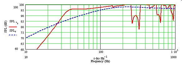

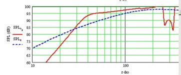

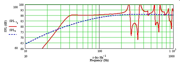

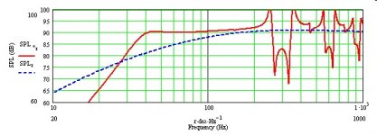

but how about the difference in the 1 and 2 woofs?
I meant this, it's similar in both versionsHenkjan said:.....
another thing I noticed: when setting the parameters for 2 drivers in paralel (so: Sd double, Vas double, Re halved) the response changes quite a bit
You have lost me, I am not sure what the question is all about. Can you repost the two curves you are looking at, the driver parameters entered for each, and the enclosure parameters for each enclosure and then re ask the question?
what I did was 2 simulations, one with a single driver, one with two drivers. parameters adjusted as per your paper, cabinet made double cross-section. I expected the same output, but that was not the case. I will send you the mathcad file by mail when I get home
The plots look close to the same shape but with the two driver plot shifted up 6 dB as expected. There will always be slight differences due to the change in cross-section areas in particular the port area. I don't see anything indicating an error in your results, the two designs will never be identical in SPL response shape but they should be close.

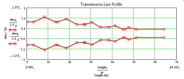

The graph of the TL cross-section has been a big improvement for me. It really helps eliminate silly mistakes when inputting the detailed data in TL Sections and helps visualize changes you make to the design.
A Godsend in the BLH sheet too. Visual checks are always useful -especially when somewhare, amongst the mass of data, you've put a decimal in the wrong place. Before you were pulling your hair out trying to find where you'd messed up -far easier to isolate errors now.
