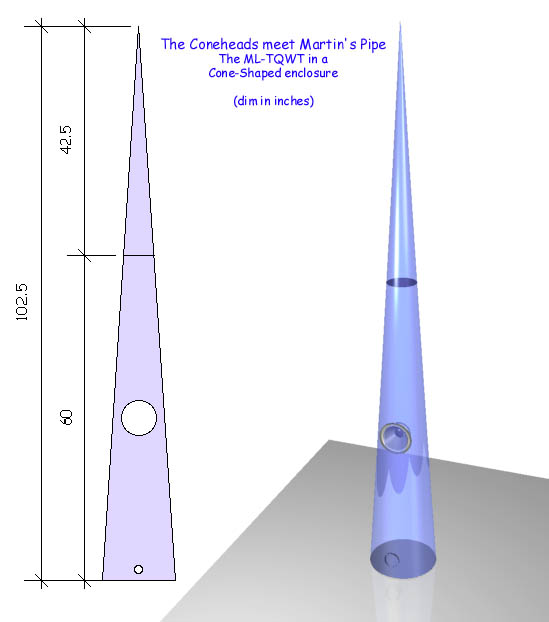

I came across a pic of the coneheads the other day... this is a taper that the sheets could approximate if you converted it to a piecewize approximation, but it is a well defined flare, maybe higher order rates could be explicitly added?
dave
Scottmoose said:
Hey, I like that Dave. Dunno how to go about building one, and it'd need a heck of a tall room, but I like it anyway! And as a bonus, you could hold a 16th century re-enactment in your living room if you got bored with listening to them
The top part is just to continue the lines, you could always truncate them.... Andy Graddon has a set half-done using a translam (but he gave up), i was thinking that a clever slice out of a sonotube might work.
dave

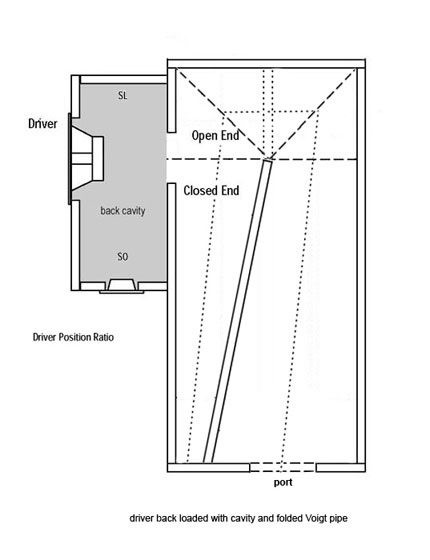

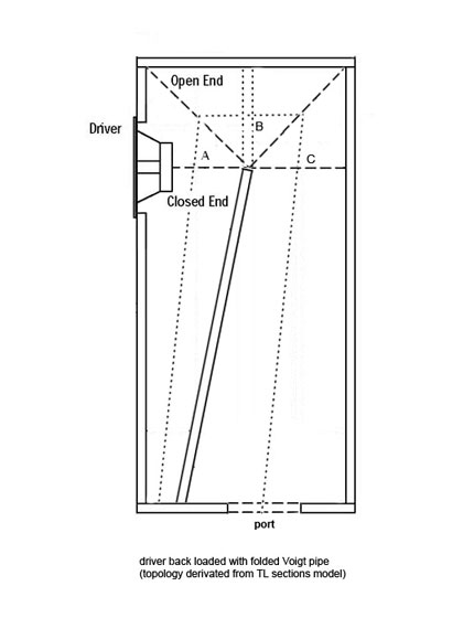

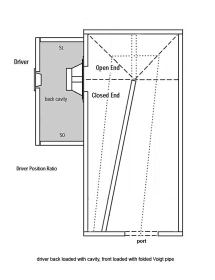

I done some mods on the standard TL sections sheet
to simulate foded Voigt cabinet
seems that it works in praxis...
Practicly we have there back loaded, and front loaded systems,
(loaded with folded woigh horn)
The instinct tels me that it can be realy good
any comments...
